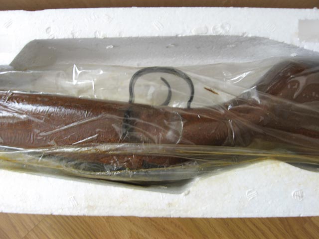

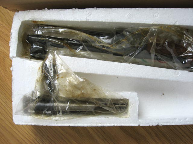

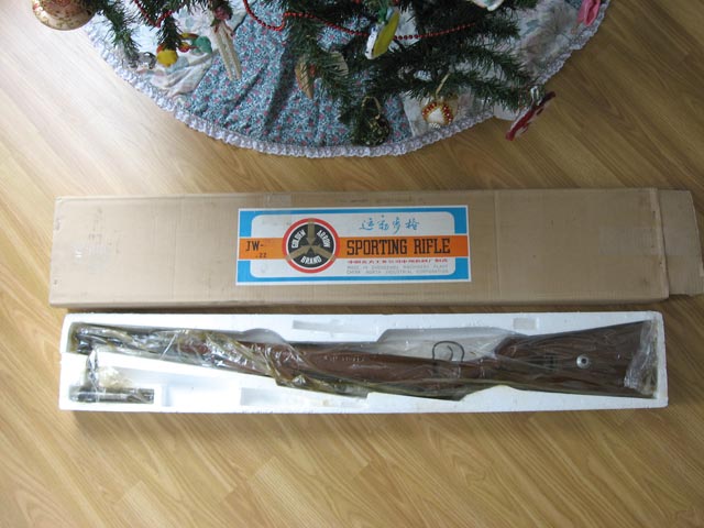

Here's some photos I shot this morning (and before photos). The gun comes in very plain packaging, wrapped in plastic and covered in cosmoline. (under the Christmas tree of course)

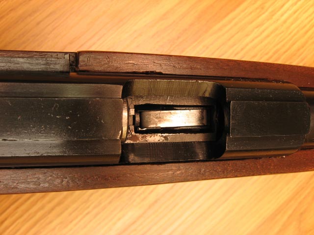

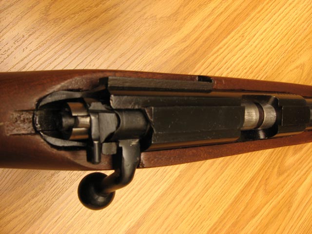

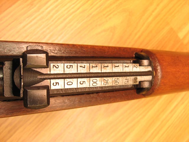

Here are some closeups giving you an idea of the finish. The ladder sight could use some polishing.
One of the feed lips on the magazine was really high and making the bolt travel rough. I bent it down but you can see where the bolt took the colour off it. That's not rust in there BTW - just a funny reflection off a spot of oil.
The rear scope mount has two corners taken off and left in the white - back left and front right. I might try to round it off a bit and reblue.
Finish on the bolt is not too bad - will probably smooth out with some polishing.

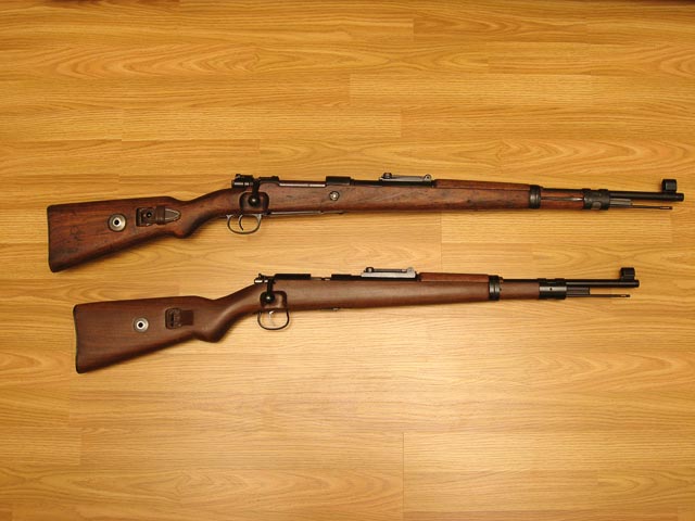

Family photo - comparing size against my ERMA 41 K98k. I like how it matches my cupped buttplate.
All in all, its a decent gun for the money. I'm a tinkerer so I don't mind having to fool around with it a little.
