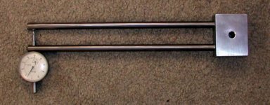

3" from the breech, the barrel diameter is .864, which is within the .100 recommended above.
I may have been a bit confusing but....I'll try again.
The bore diameter, down it's full length, should be within .010 of the bore diameter when it was proofed. That would indicate the barrels have not been overly honed and thus made too thin. If the gun were in Britain and bores were out by over .010, the gun would be illegal to sell.
A completely separate issue is the specific barrel wall thickness measured at the end of the chambers. Typically that specific measurement is over .10". If it is less than .090" I personally would not use the gun with any ammo, never mind off the shelf modern ammo. The thinning of the barrels at that specific point is the reason why lengthening chambers is a risky move. The problem arises from boring out a constant dimension while the exterior of the barrels are tapering. Obviously, the longer the chambers are bored out to, the thinner the barrel becomes. At the specific point where internal pressures are highest.
- If the outside barrel diameter 3" from breech is .864"
- Subtract inside chamber diameter 3" from breech
- Divide that by two to determine barrel wall thickness at 3" from breech
- To be safe measure outside barrel diameter 3 1/4" from breech
