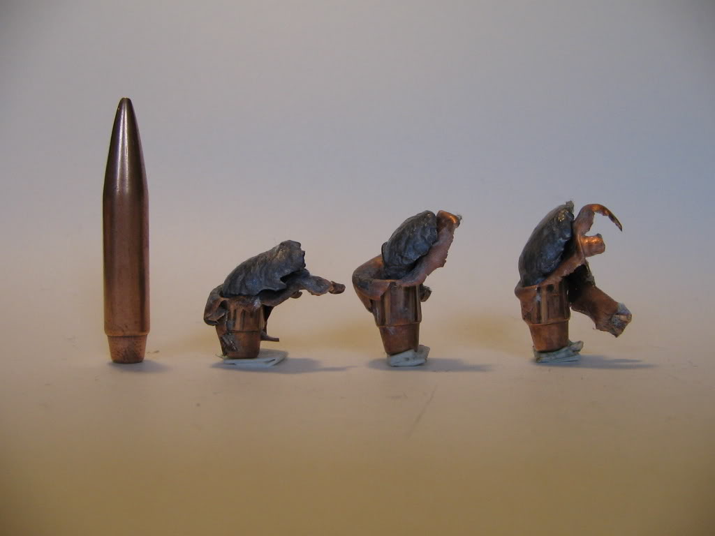

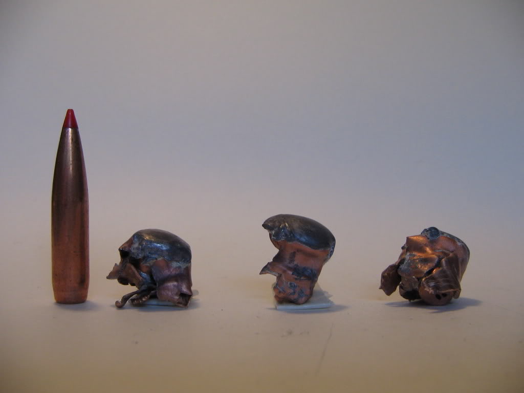

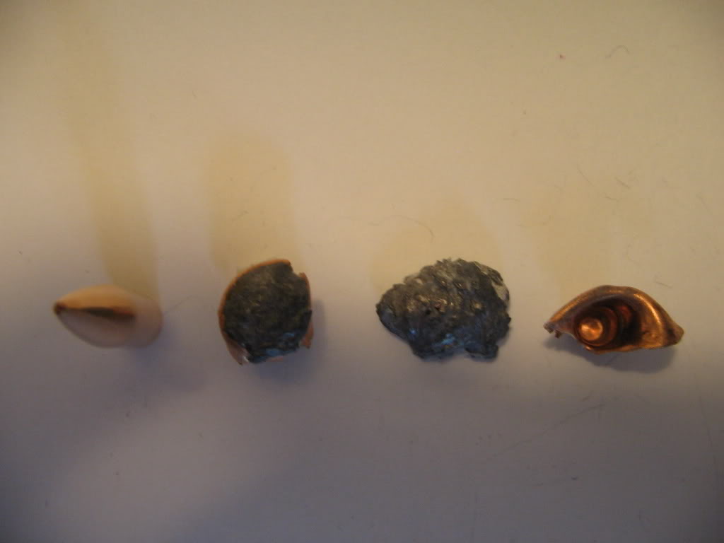

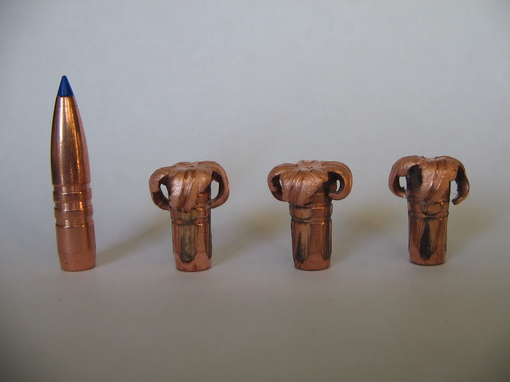

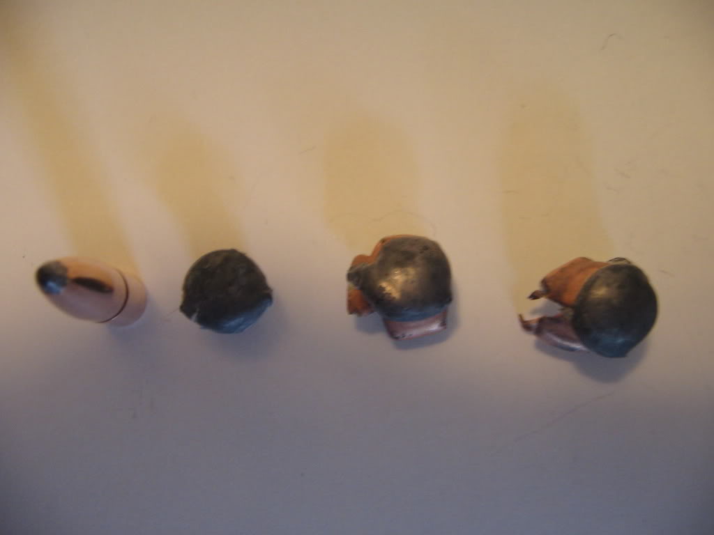

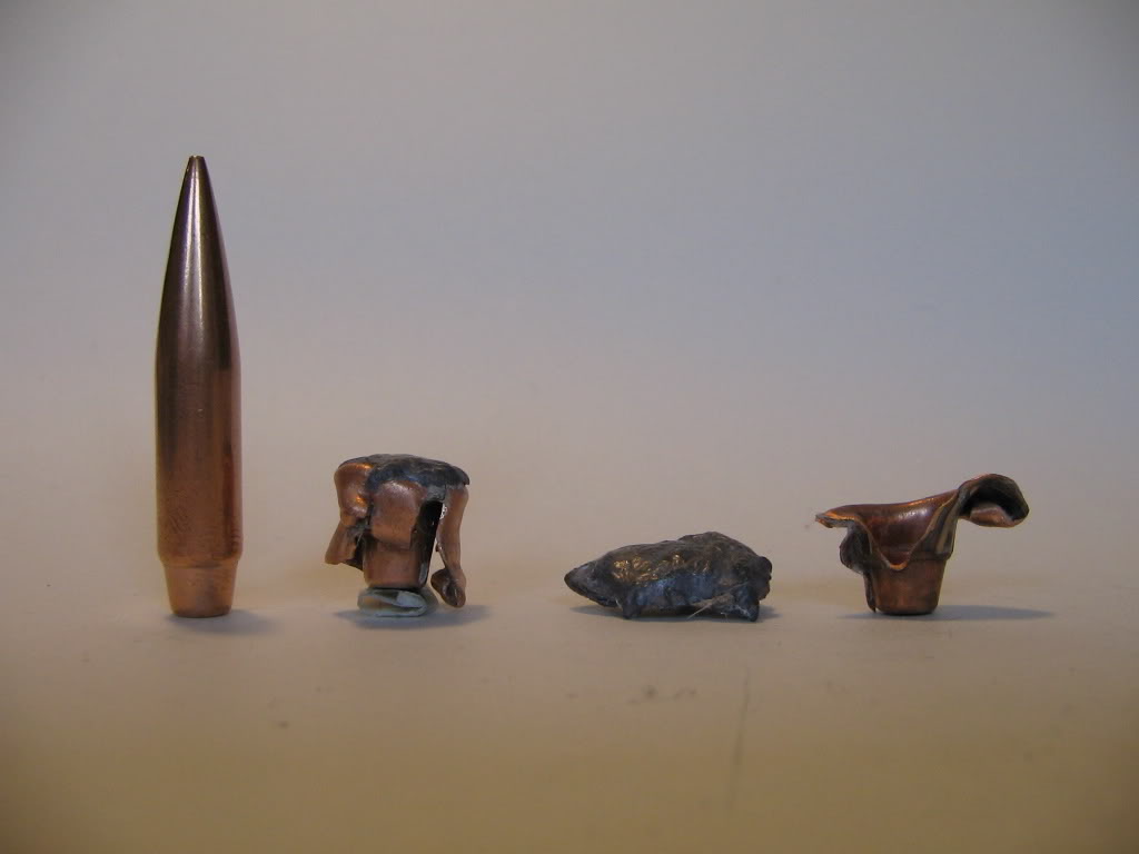

**Huge CGN .264 Bullet Test Result** (lots of pics!)
bcsteve
135   0   0
BC

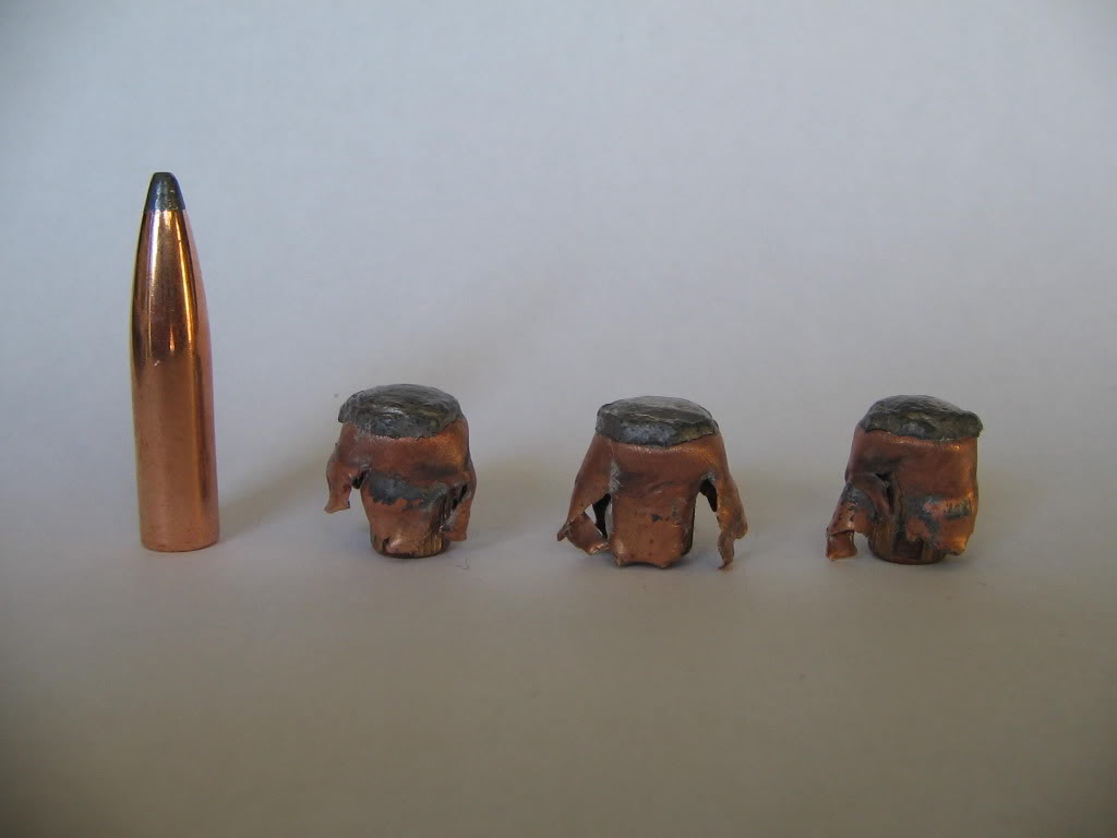

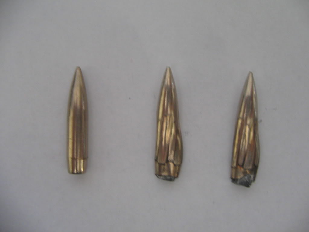

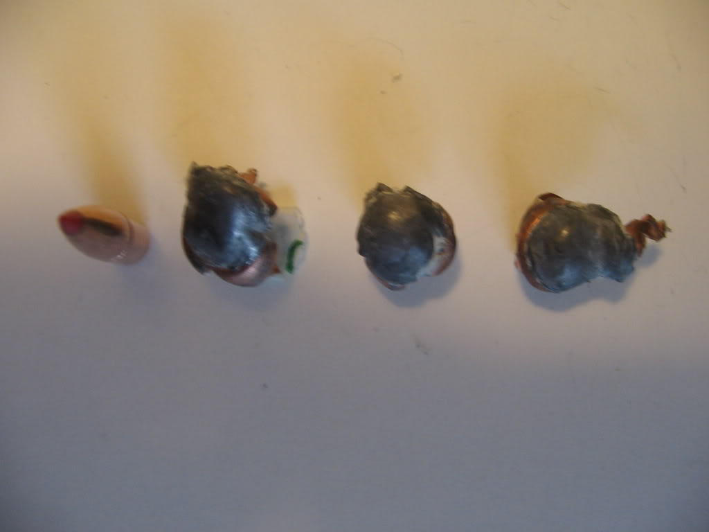

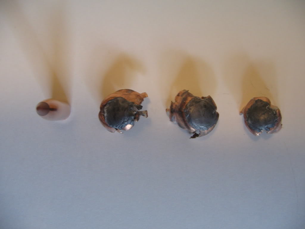

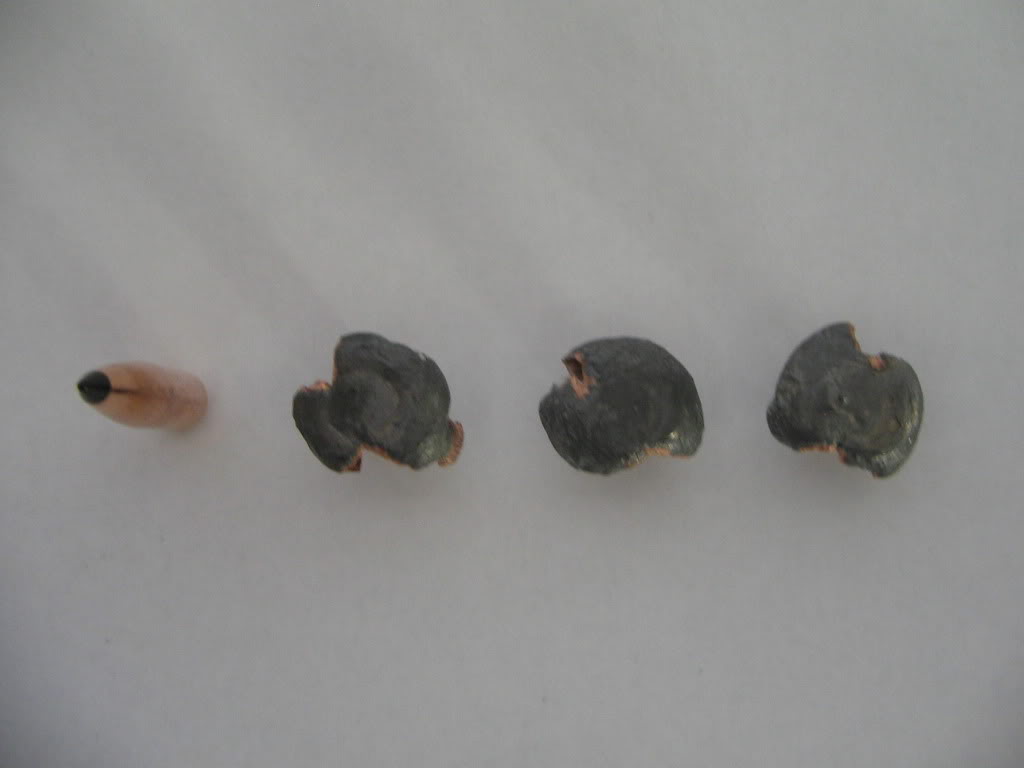

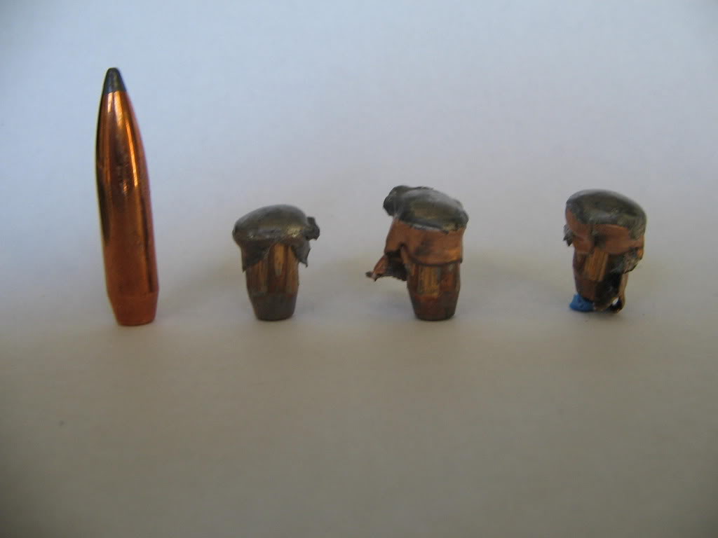

There it is!!

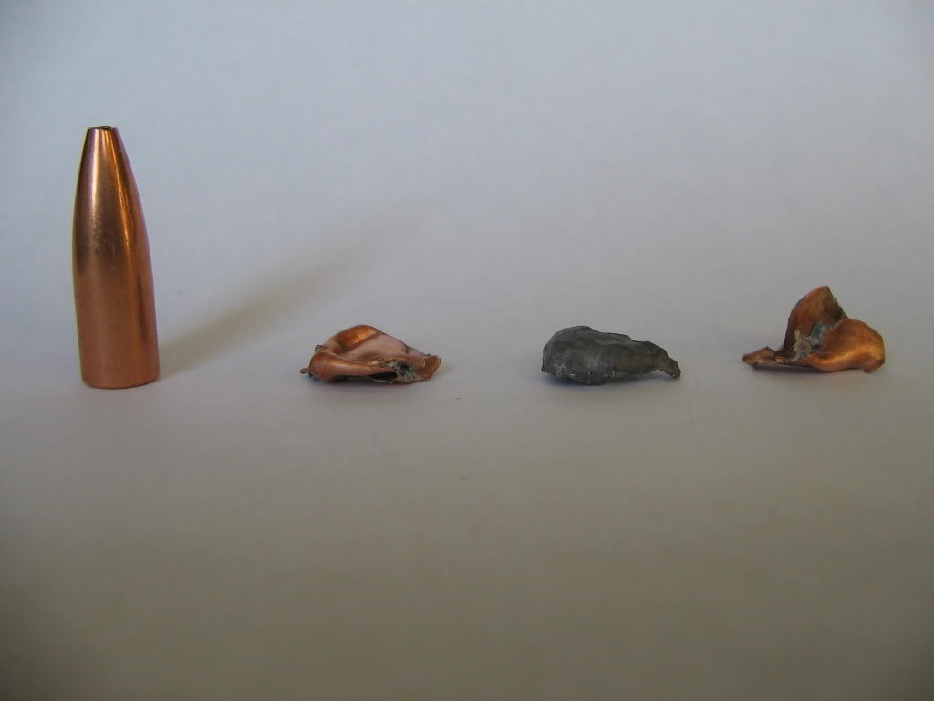

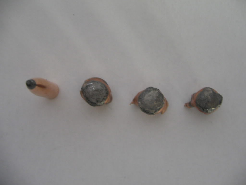

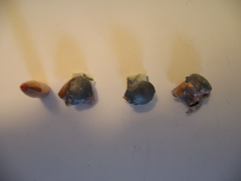

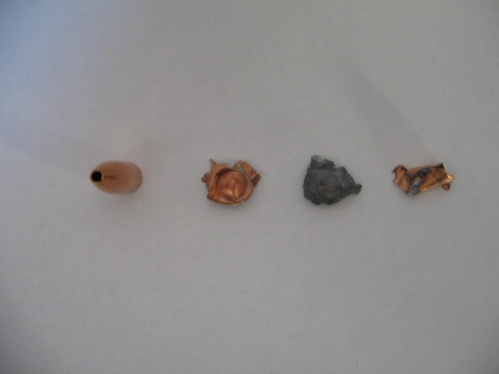

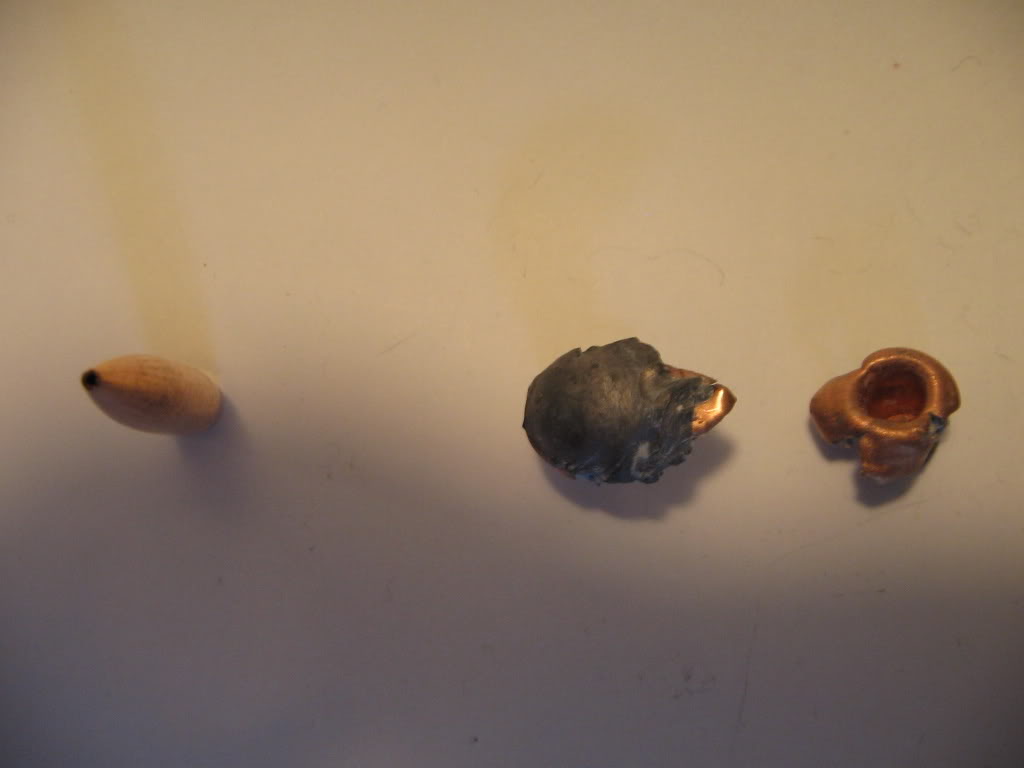

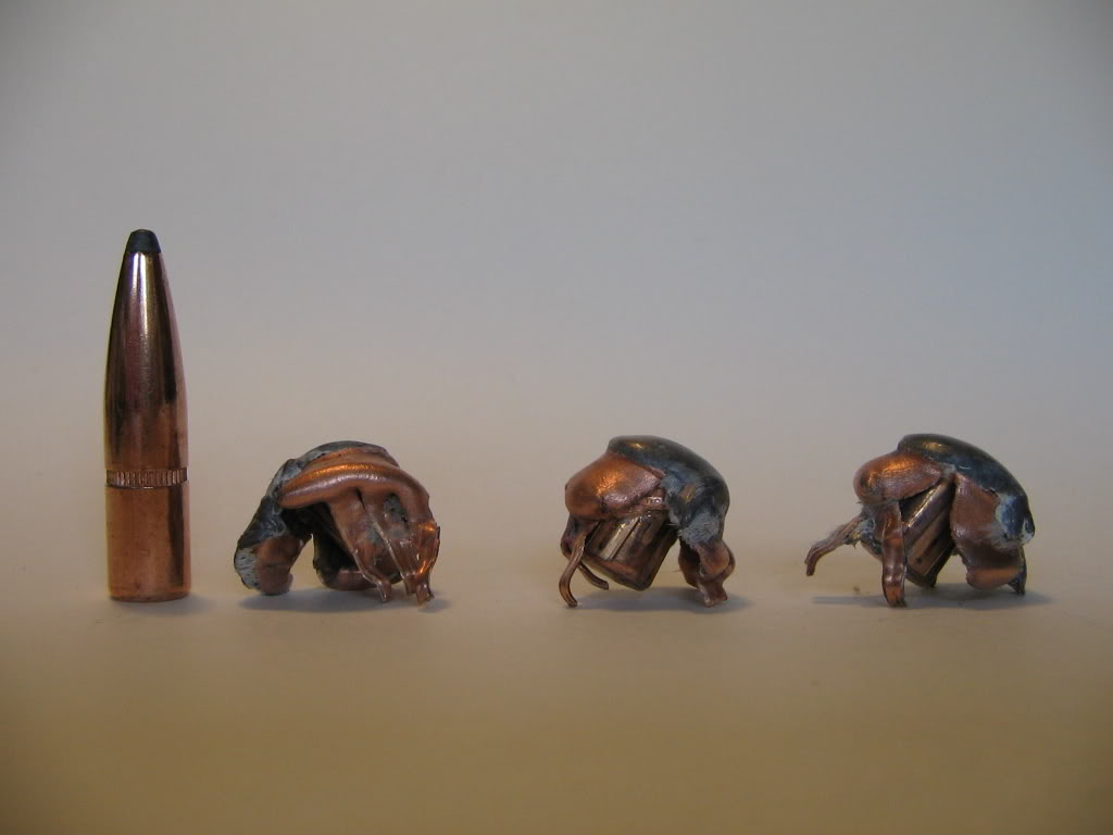

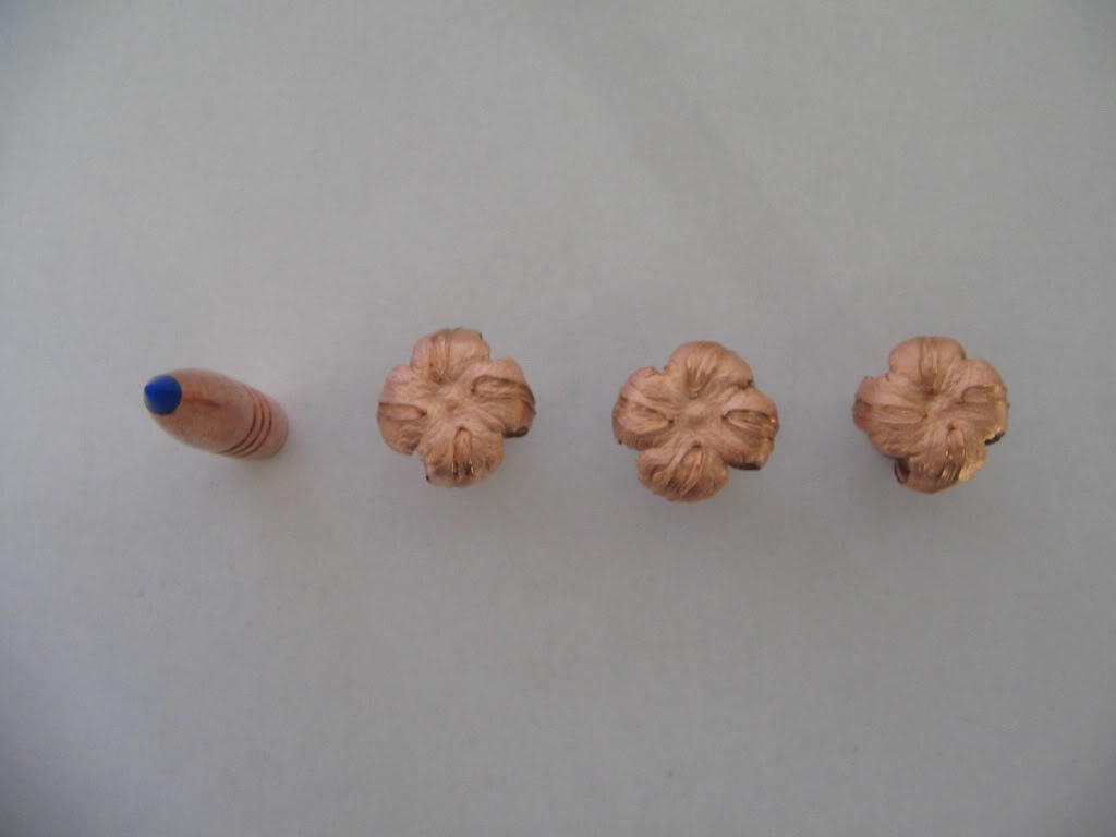

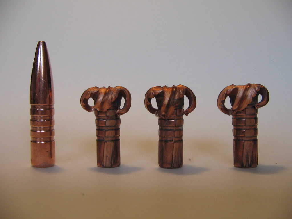

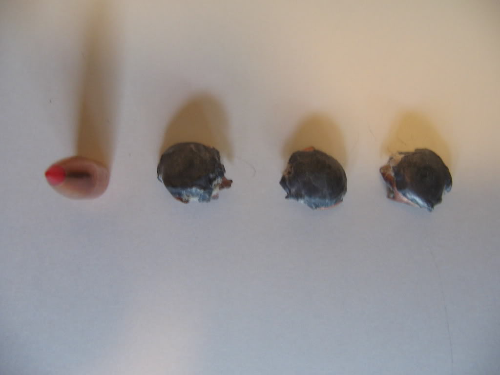

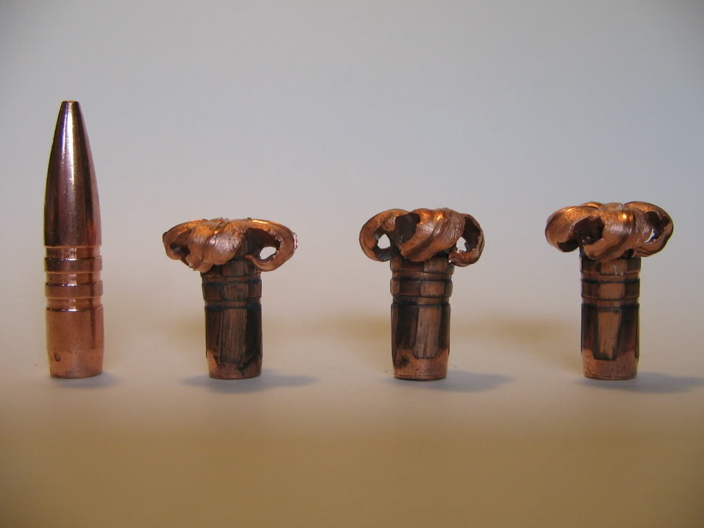

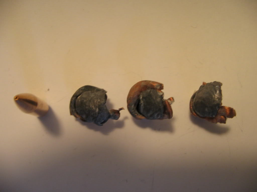

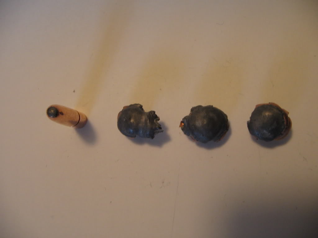

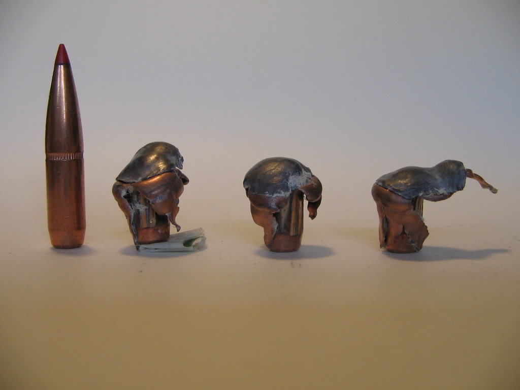

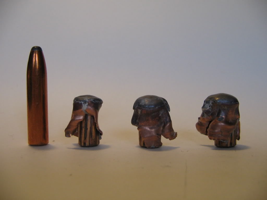

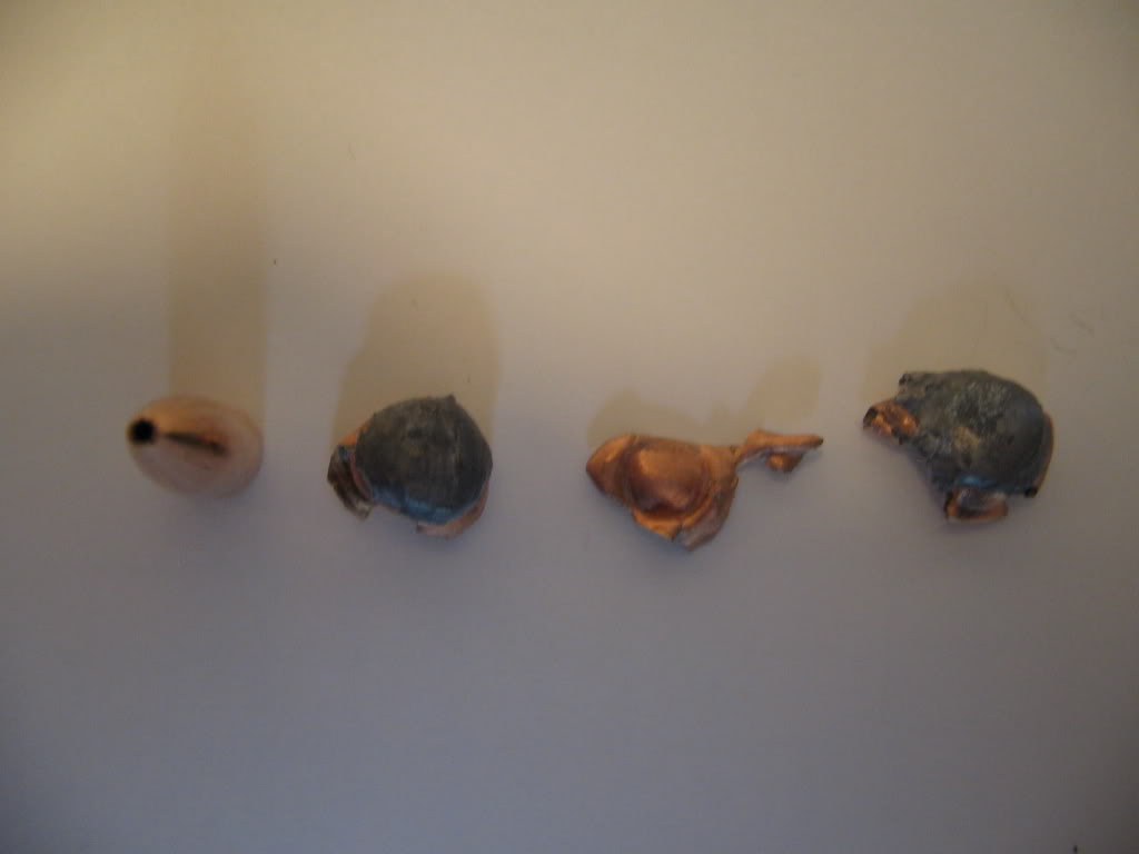

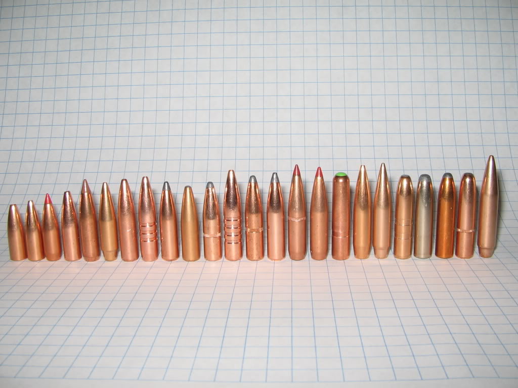

The line up:
- The impact velocity was made to duplicate modern 6.5X55 loads at 100 yds.
- Expansion was measured at the widest part of the bullet. Take a look at the pictures when comparing the expansion of different bullets, sometime a sliver of lead or copper at an odd angle can give deceptive results.
- Test rifle: Winchester Model 70 Featherweight 6.5X55 Swed
- Test media: Wet newspaper....lots of wet newspaper!!
- Disclaimer: I know wet newspaper does not give identical result to flesh and bones, blah, blah, blah....

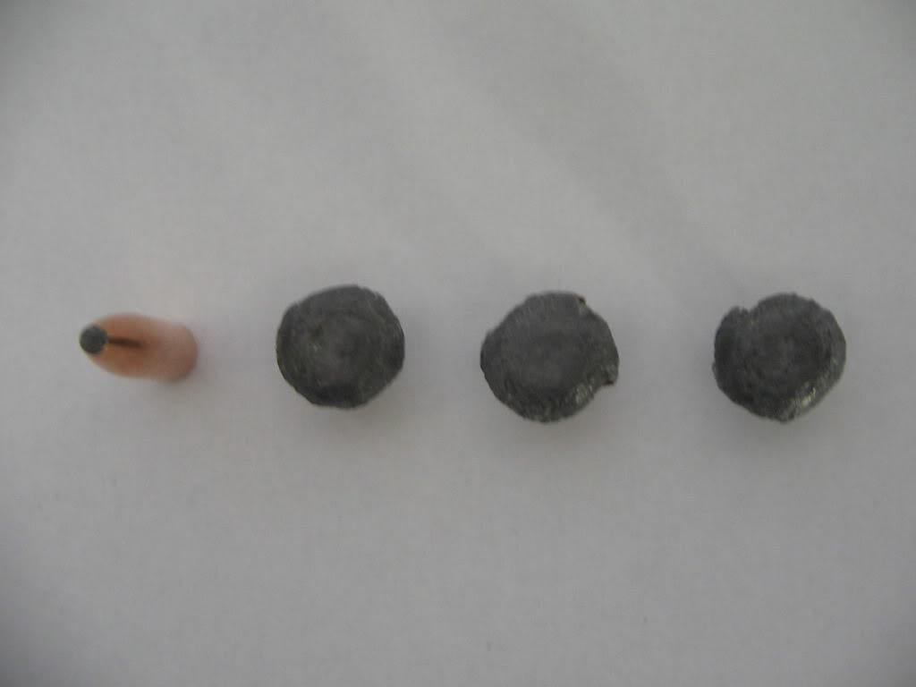

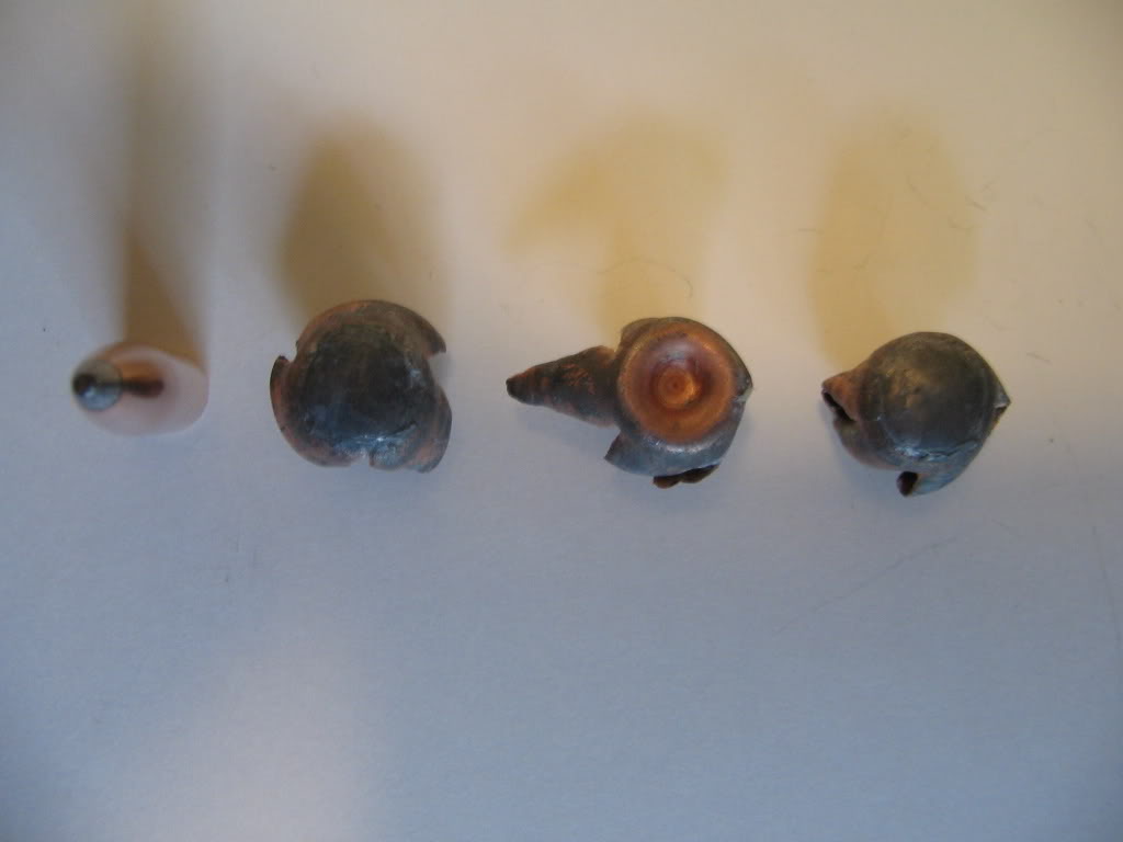

Sierra 85gr HP
Average Penetration (inches): 9.0
Average Weight Retained (grain): 13.6
Average Weight Retained (%): 16
Average Expansion (inches): 0.476

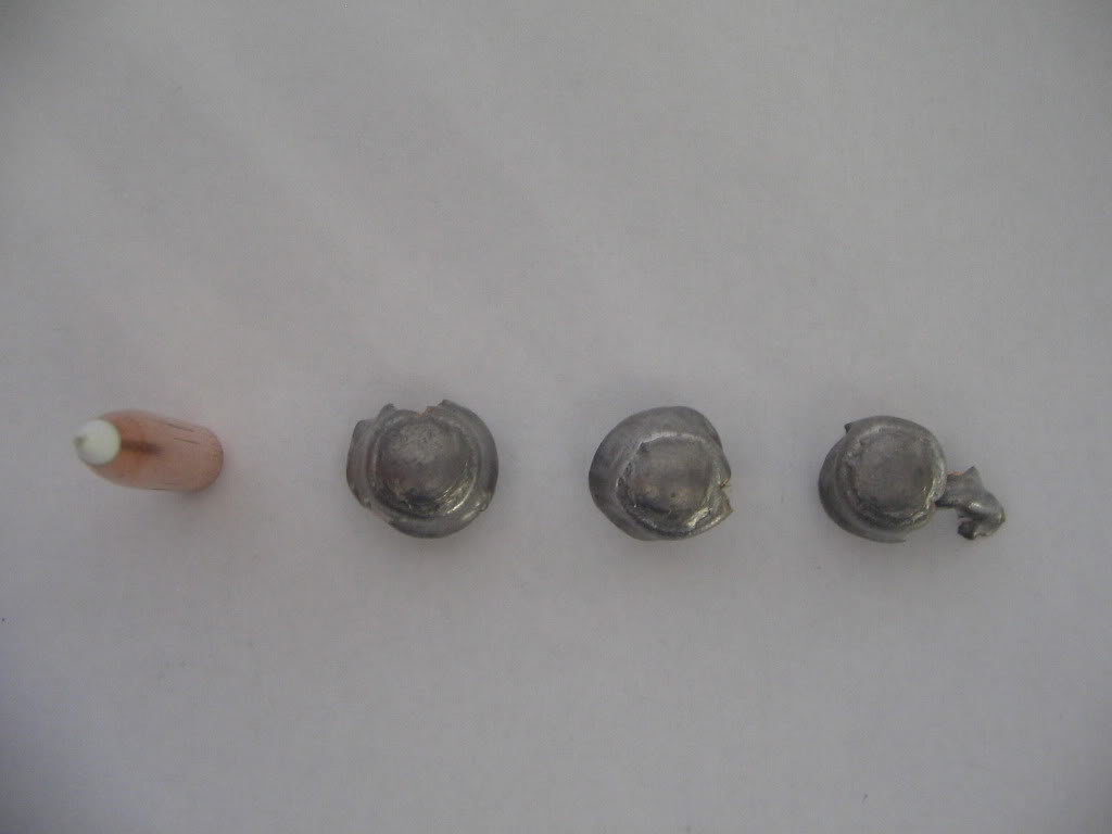

Speer 90gr TNT
Average Penetration (inches): 10.17
Average Weight Retained (grain): 28.3
Average Weight Retained (%): 31
Average Expansion (inches): 0.549

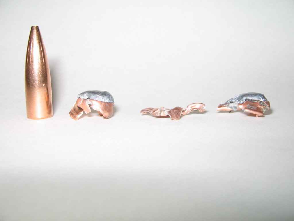

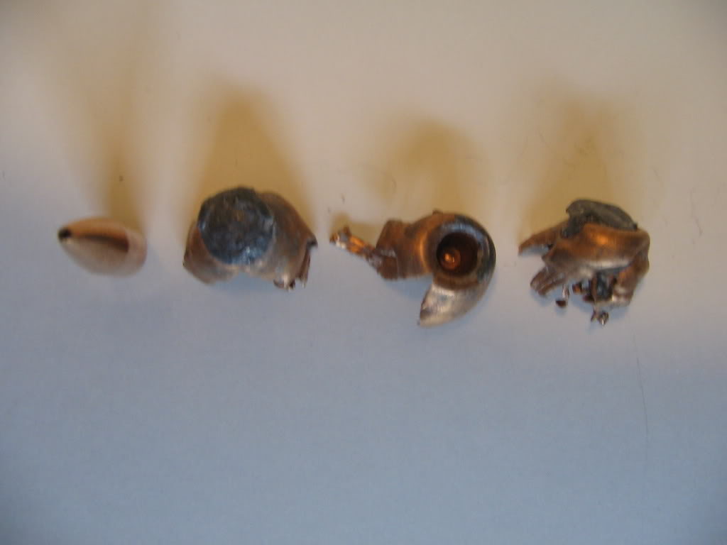

Hornady 95gr V-MAX
Average Penetration (inches): 6.25
Average Weight Retained (grain): 34.1
Average Weight Retained (%): 36
Average Expansion (inches): 0.470

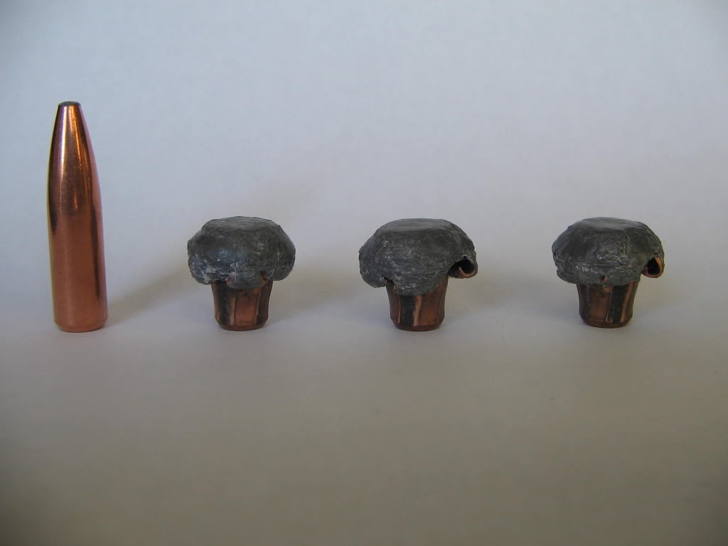

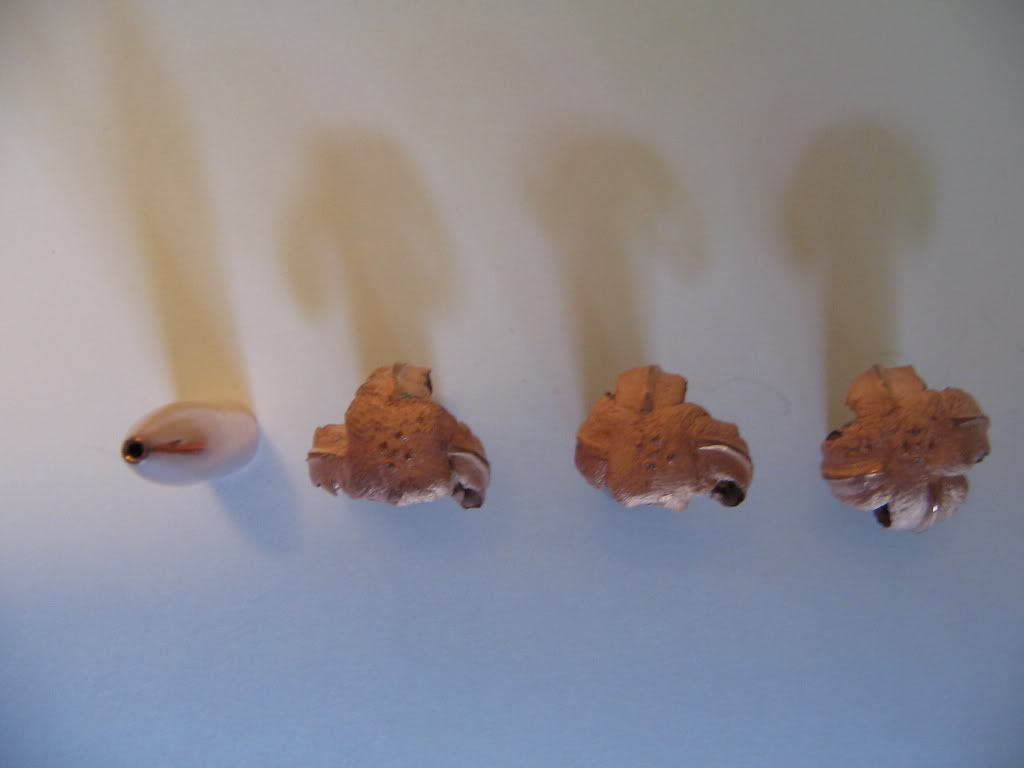

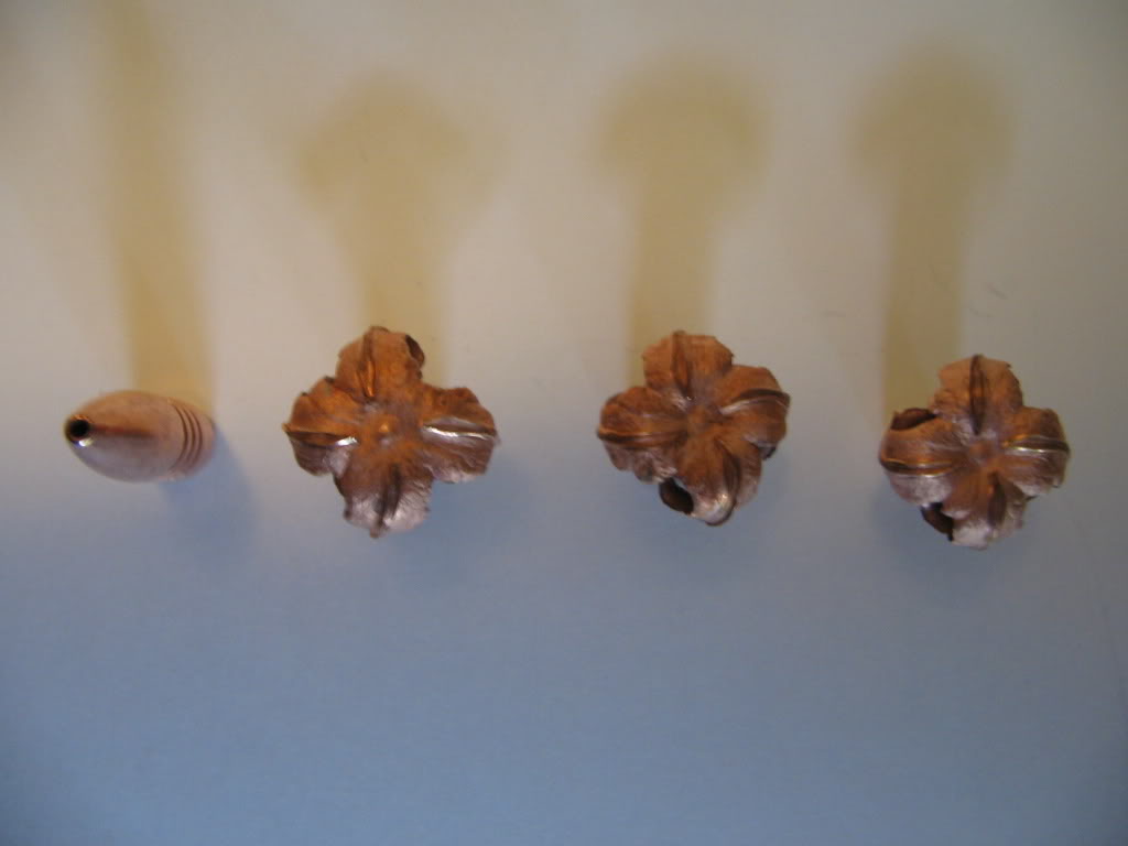

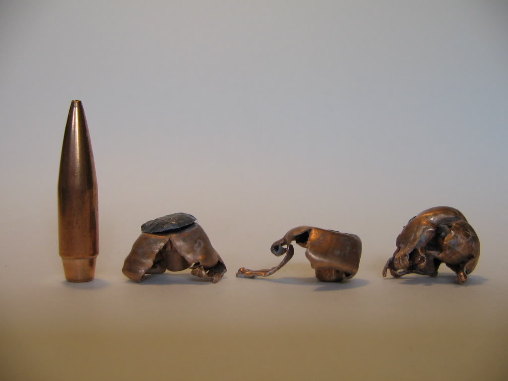

Barnes 100gr X
Average Penetration (inches): 16.67
Average Weight Retained (grain): 83
Average Weight Retained (%): 83
Average Expansion (inches): 0.423

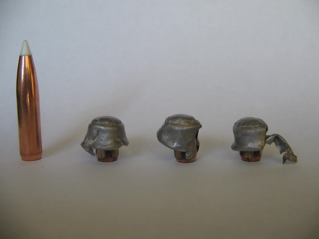

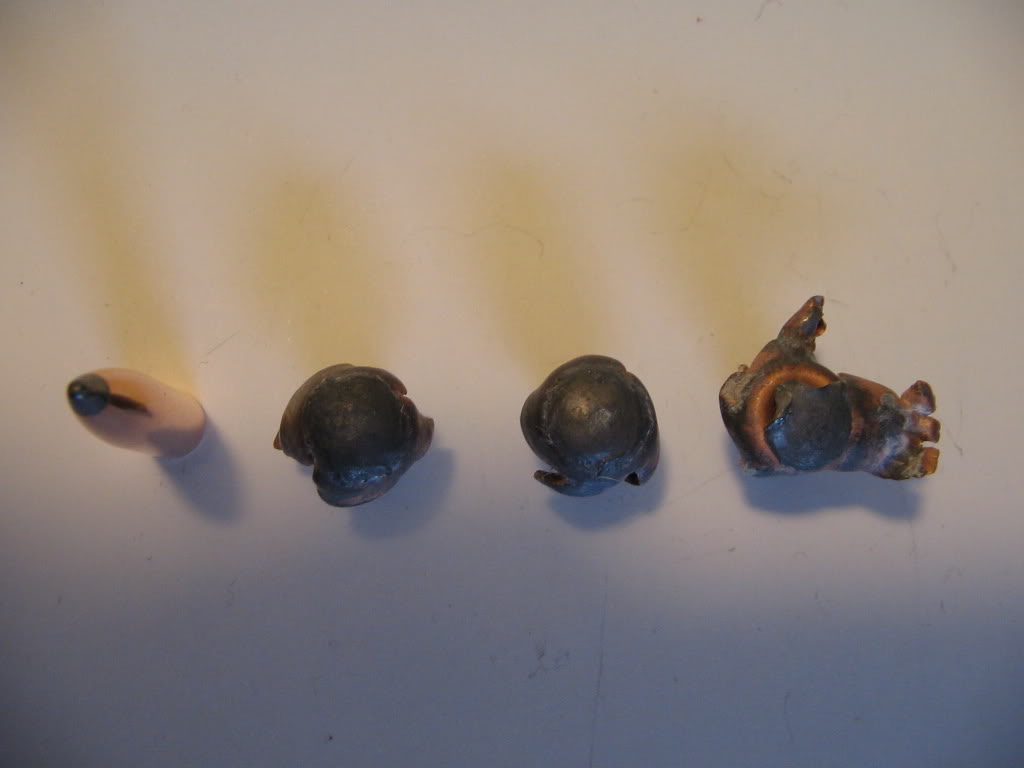

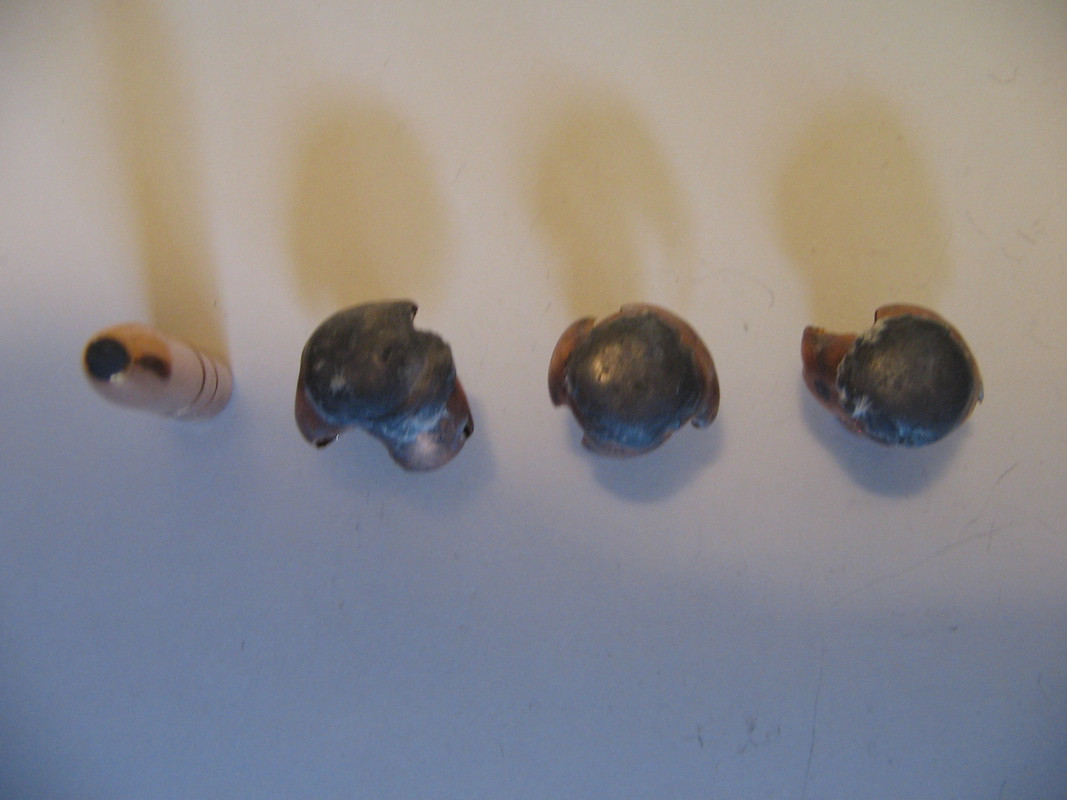

Nosler 120gr Ballistic Tip
Average Penetration (inches): 10.30
Average Weight Retained (grain): 74.4
Average Weight Retained (%): 62
Average Expansion (inches): 0.643

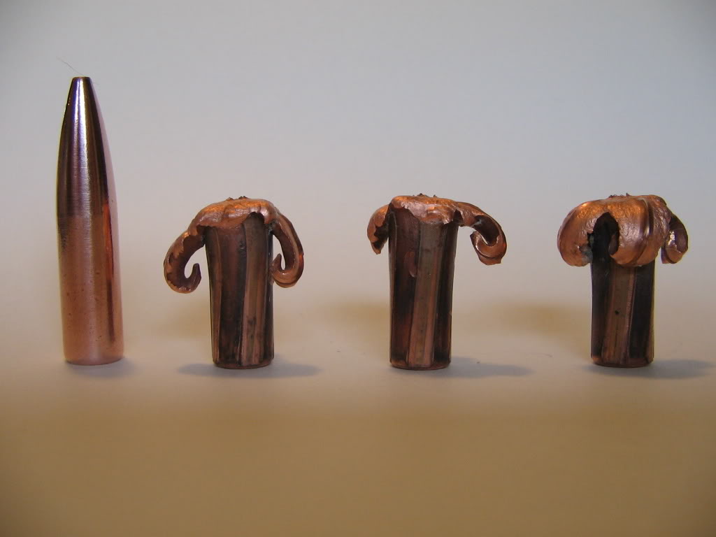

Barnes 120gr X
Average Penetration (inches): 14.42
Average Weight Retained (grain): 114.5
Average Weight Retained (%): 95
Average Expansion (inches): 0.586

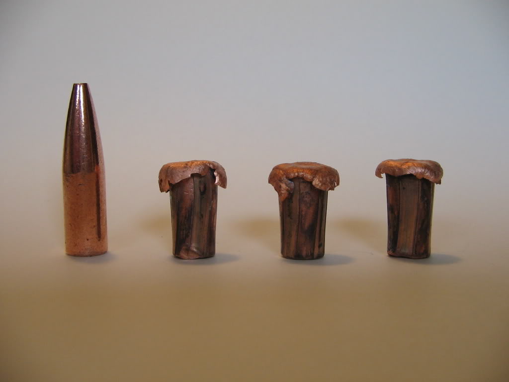

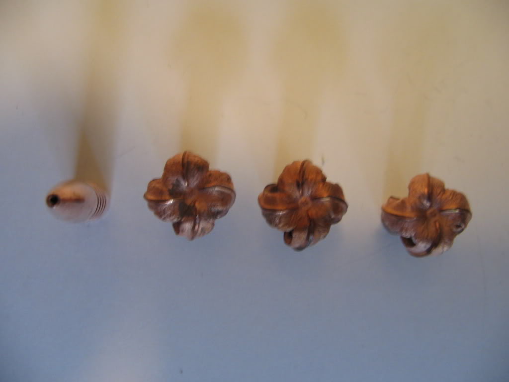

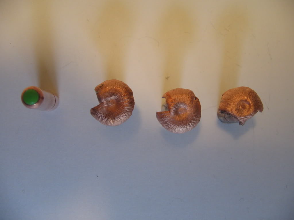

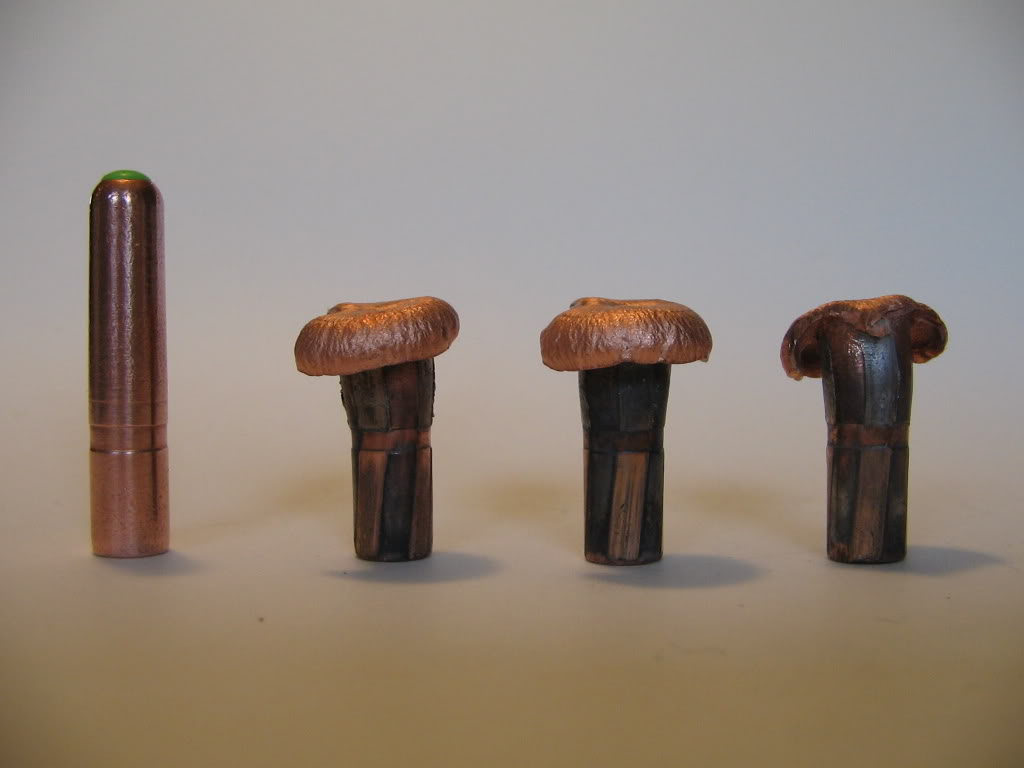

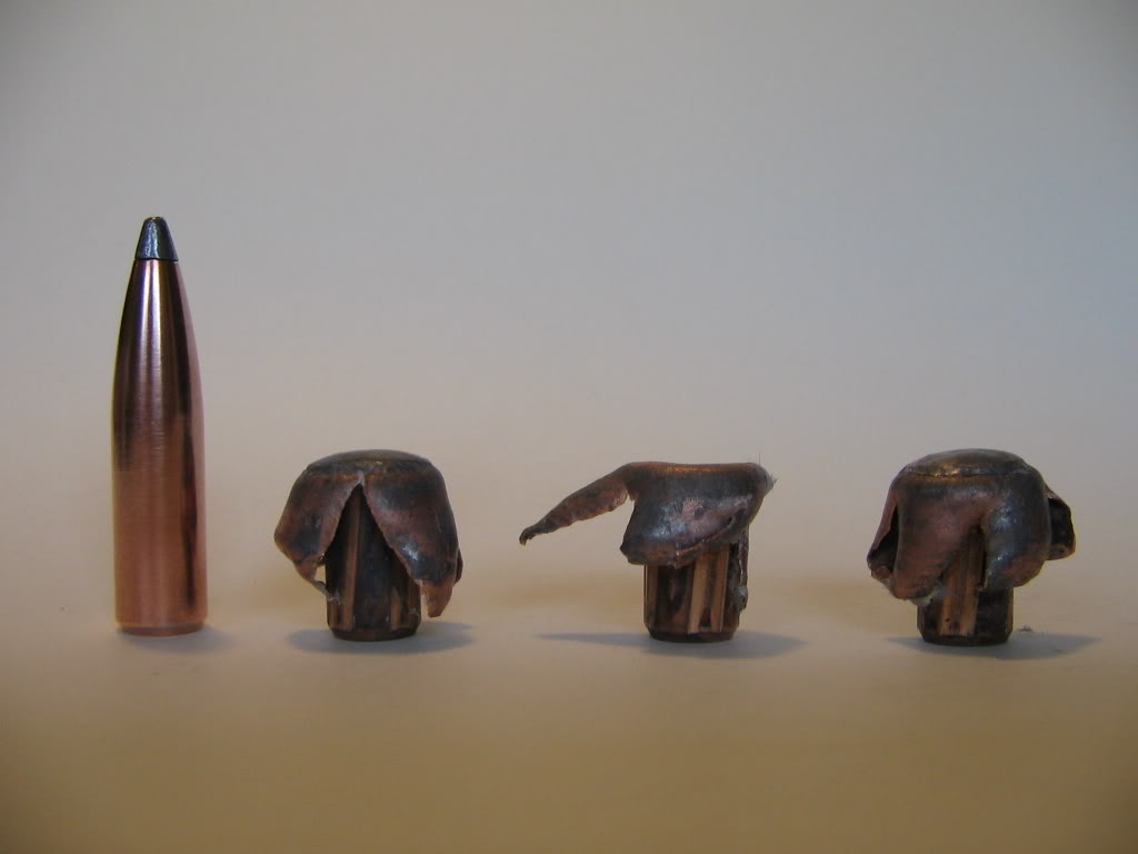

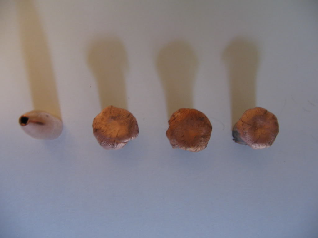

Barnes 120gr TSX
Average Penetration (inches): 13.67
Average Weight Retained (grain): 120.1
Average Weight Retained (%): 100
Average Expansion (inches): 0.592

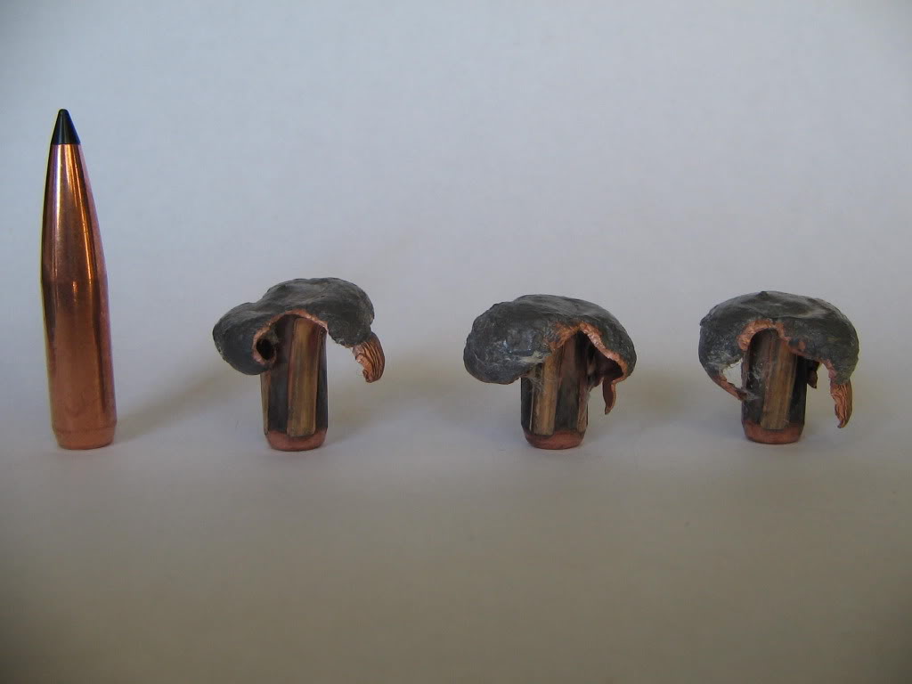

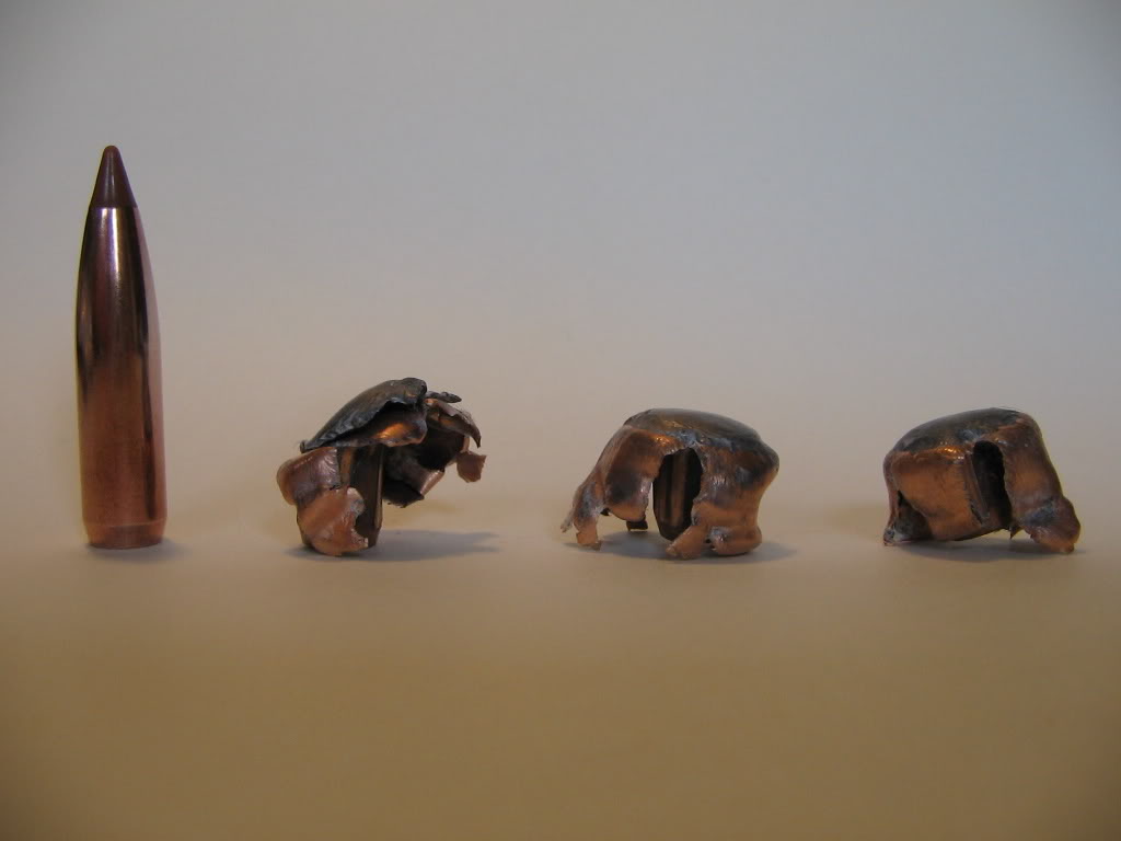

Barnes 120gr TTSX
Average Penetration (inches): 17.2
Average Weight Retained (grain): 119.2
Average Weight Retained (%): 99.3
Average Expansion (inches): 0.547

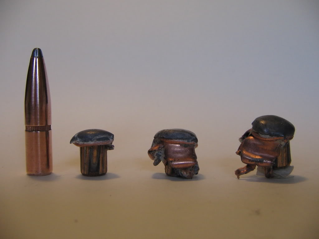

Nosler 125gr Partition
Average Penetration (inches): 15
Average Weight Retained (grain): 88.5
Average Weight Retained (%): 71
Average Expansion (inches): 0.614

Barnes 130gr TSX
Average Penetration (inches): 18
Average Weight Retained (grain): 129.9
Average Expansion (inches): 0.552

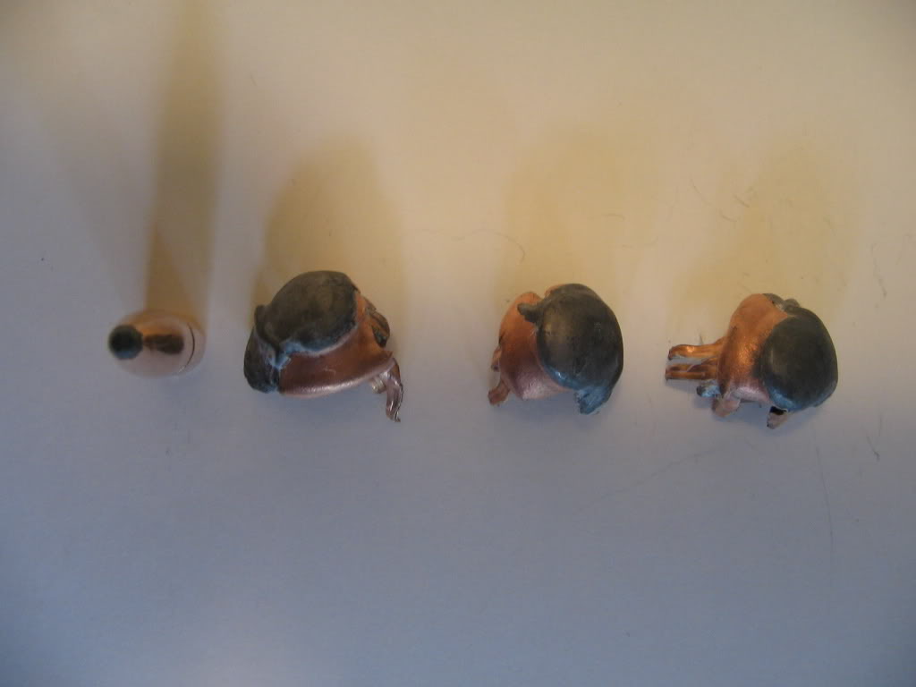

Hornady 140gr A-MAX
Average Penetration (inches): 12.17
Average Weight Retained (grain): 75.9
Average Weight Retained (%): 54
Average Expansion (inches): 0.597

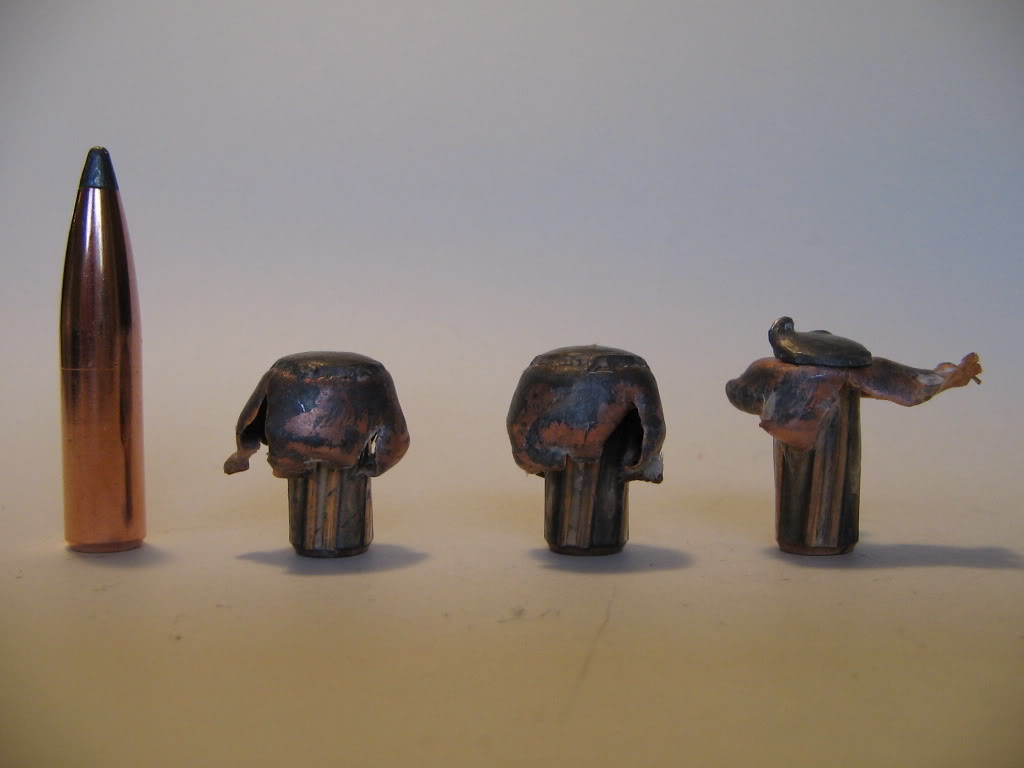

Nosler 140gr Partition
Average Penetration (inches): 15.17
Average Weight Retained (grain): 108.6
Average Weight Retained (%): 78
Average Expansion (inches): 0.629
Nosler 140gr Accubond
Average Penetration (inches): 14.17
Average Weight Retained (grain): 89.9
Average Weight Retained (%): 64.2
Average Expansion (inches): 0.621

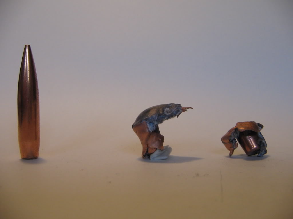

Berger 140gr VLD Hunting
Average Weight Retained (grain): 50.1
Average Weight Retained (%): 36.4
Average Expansion (inches): 0.576

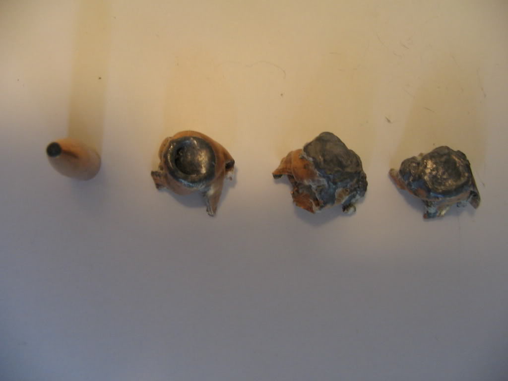

Sierra 142gr Match King
Average Penetration (inches): 14.25
Average Weight Retained (grain): 40.7
Average Weight Retained (%): 29
Average Expansion (inches): 0.445
** First bullet disintegrated and not significant pieces were recovered.

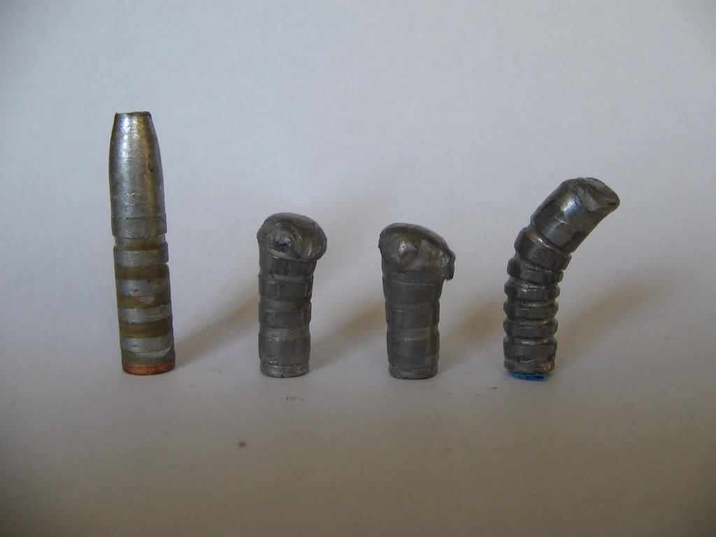

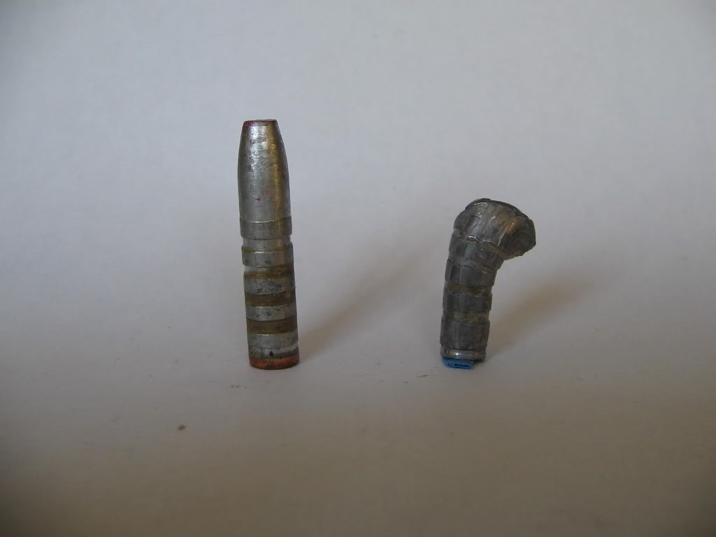

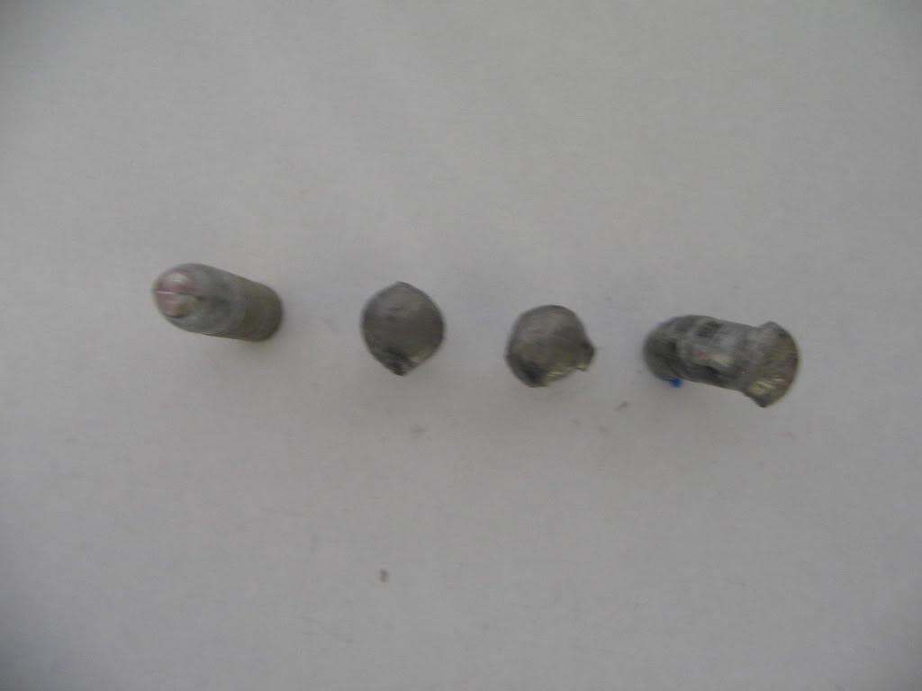

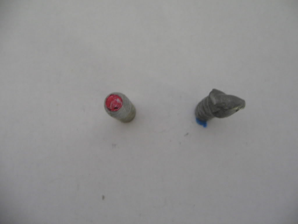

Cast 174 gr (as dropped)
Average Penetration (inches): 24
Average Weight Retained (grain): 122.7
Average Weight Retained (%): 70.5
Average Expansion (inches): 0.360
Cast 174 gr (water quenched)
Average Penetration (inches): 24+
Average Weight Retained (grain): 128.8
Average Weight Retained (%): 74
Average Expansion (inches): 0.438
*Under estimated their penetration, only recovered one.

**A special thanks to all the members who contributed by providing bullets and brass. Thank you all for you patience.**
You're welcome. If anybody know how I can post a spreadsheet with all the results let me know. It's easier to compare the different bullets at a quick glance.
Fantastic results, Steve. Congratulations are truly in order. You've greatly advanced our learning.
I hope the mods post your results in a permanent reference space on CGN so that it is always accessible, long after this individual thread dies away.
And I was right -- the 140 AMAX would work on deer!
Wow! Excellent work Steve. The Barnes TSX bullets shot into newprint look impressive. I like the %100 weight retention. I can imagine the copper claws that open up would create a massive wound channel. I am going to load some up for my .270
Regards,
George
HeadDamage said:
Any chance you made observations on how fast the bullets opened vs depth of penetration?
Not really. Honestly, there wasn't much visible difference between the "wound cavity" of the different bullets in the wet newspaper. The one thing I notice that might be of interest for the predator/varmint hunter is the difference between the TNT and the V-MAX. The V-MAX opened up a lot sooner than the TNT. The V-MAX was making craters in the first couple inches while the TNT was still drilling caliber size holes.
Based on your results I'm thinking of giving the TSX a try. I used to use Nosler solid base 120gr bullets but they don't make them any more and I hate the BT.
Very professional report. Excellent info and pic's :D Back in 1962 my BIL, together with his brother, bought a pair of M70 Westerners in the newly introduced (1958) .264 Winchester Magnum. For over forty years, those two gents have taken many moose, muledeer, whitetail, goat, blackbear, grizzly, wolf and coyotes with their .264's. Their go-to load was Winchester's 140gr SP factory ammo. I'm tending to believe that had the TSX been around in their day, it would have become their favorite.
