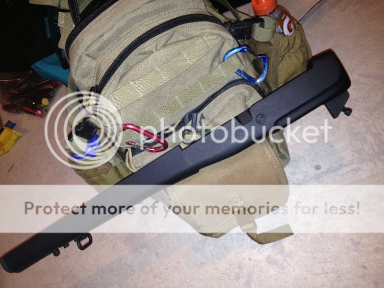

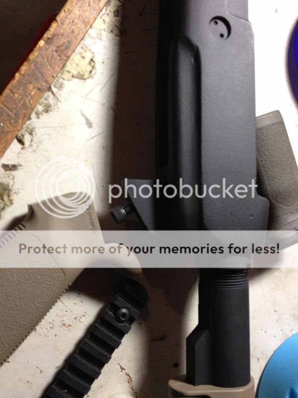

I found the USGI glass stock (many of you know I love this stock upgrade) was a little too long and interfering with the shoulder positioning. So here comes the ICR Ingram Custom Rifleworks CQB stock that Thomas made up using his own design and carbon fiberglass (right term?) magic....
Out of the box, here it is ready for your AR carbine buffer tube. Mine came from Questar and so did the Magpul Koolaid...

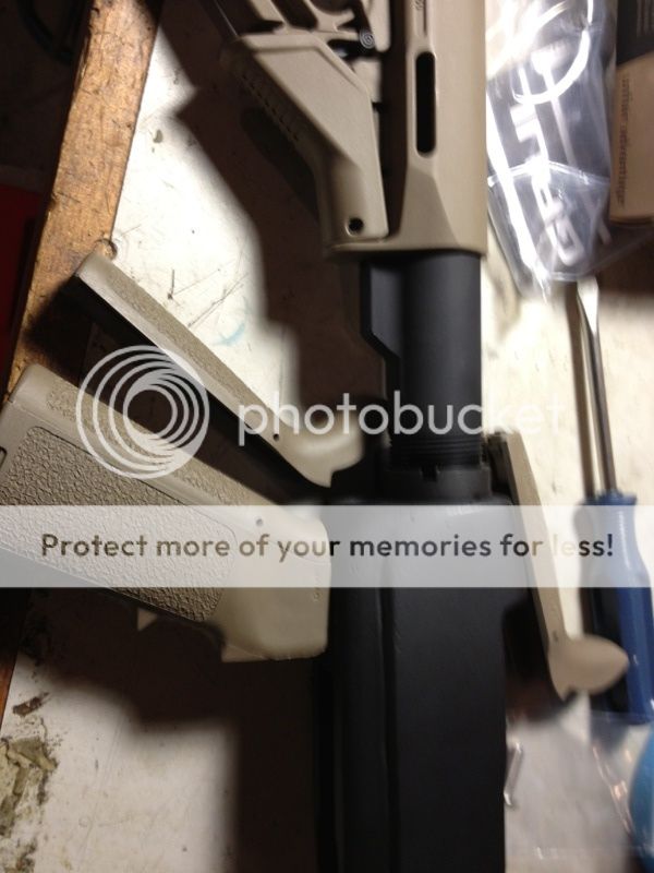

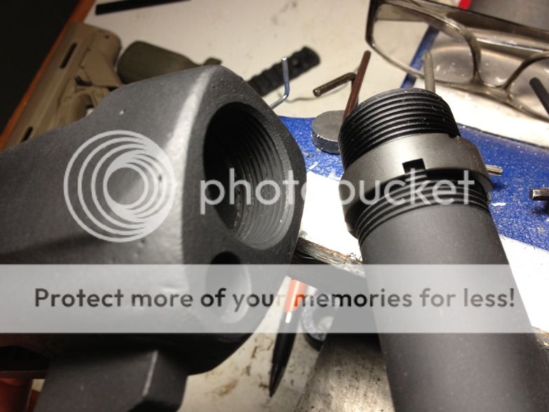

Notice the AR15 pistol grip adapter and this comes with a bolt that used a 3/16" Allen key. What I really liked about this design is the use of the existing Chinese black plastic stock from my shorty. I sent it to him in BC and another $ 275 to cover the conversion and mailing back to me.
Here is a close up of the adapter and buffer tube interface. Very solid. No play whatsoever. Very smooth and effortless install!

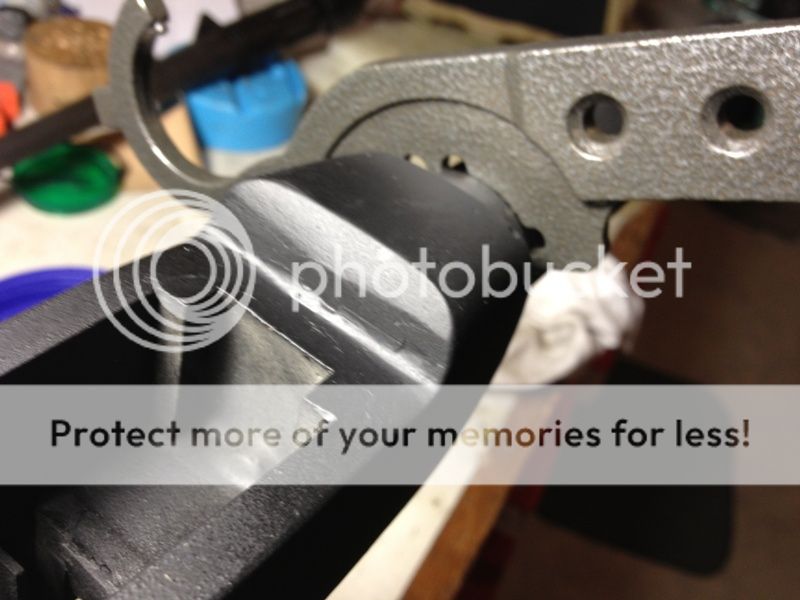

Have a look at the interior of the horseshoe tang... Very well finished.

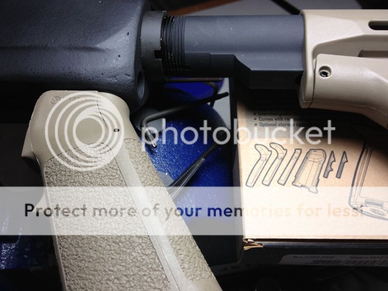

I put aside a Magpul MOE pistol grip in FDE. Then I discovered the interface/mating surfaces for the rear of the backstrap would have been a bit on the goofy looking side. Have a gander. So I grabbed my Magpul MIAD grip kit from my Armalite M15 instead...
And here is the MIAD grip... see how it matches the CQB stock a bit better... I left the other backstrap just to show the goofy curved interface.
Now here is a close up of the MIAD grip with the flat backstrap...

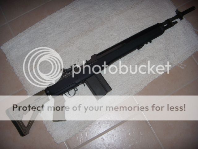

The rifle dropped straight into the stock without any surprises (I did not expect any at all) since it was a Norc factory black plastic stock. Some other advanced design stocks require quite a bit of wrenching around and being the match rifle tweaker (I'm not a gunsmith) that I am, I tend to avoid any of those super cool looking aluminum platforms.

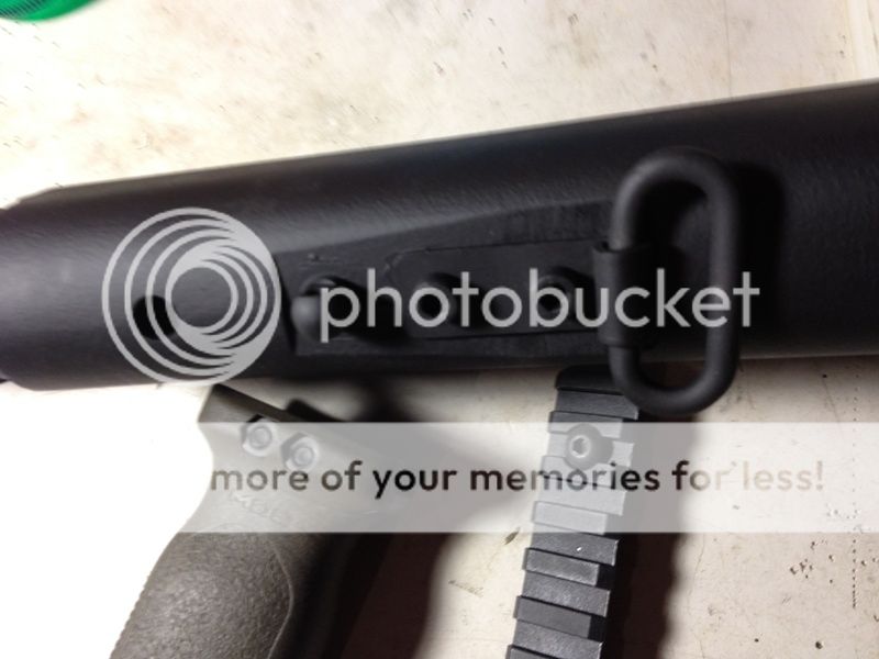

Have a gander at the front end of the stock. I love the sling plate screws that Thomas uses... and then he installed a QD stud at the front. I'm impressed.
