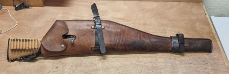

I was thinking something like this but more of a scabbard style.
https://deathrideradventure.########.com/2015/09/gun-mount.html
Like one of these. Thay are quite and hardly anything protects a rifle better. 2 million cowboys can't be wrong.
