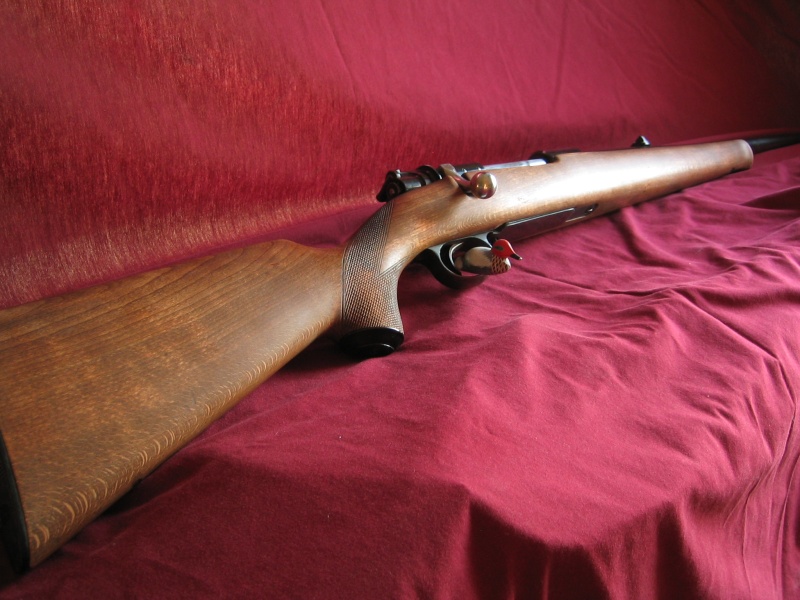

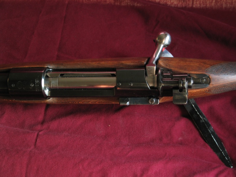

About time I posted here. This is my 640 in 30-06:
It was supposed to be a donor for a custom build - based on Anthony's modest description. After I cleaned off the grime, it turned out to be too nice. I'd love to have a M70-style safety installed, though.

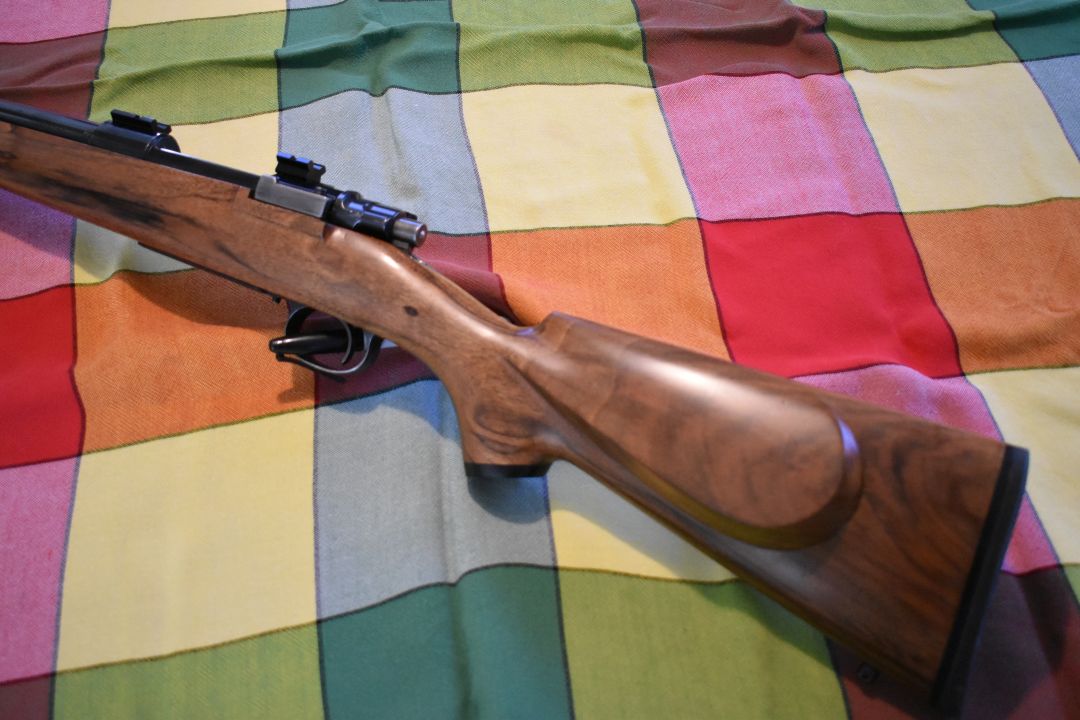

Same rifle, 10 years later...
3-position safety and a Richard's Microfit (and considerable elbow grease).
Do you mind me asking what profile and wood quality you ordered from Richard's for that stock? Looks fantastic by the way....I like the similarities to kimber stocks
That is very nice. Is the finish tung oil based?
I want to say tung, but it's been awhile and I might have done mineral spirits/tung/spar varathane. Process is the same, after getting the whole stock done with 220, wet sand using the finish starting with 320, let dry, sand back to wood with 320, wet sand with 400, let dry, back to "flat" with 400, then hand rub the remaining coats.

Wow - thank you. What you get from Richard's is a rather rough piece of lumber. I'm not complaining - I like it that way, but be prepared. I had to steal lipstick from my wife to finish the inletting. The exterior required a lot of work with a rasp and a lot of decisions about final shape. Barrel channel was one diameter - no taper, forend was cut off square. Really, lots of work.
It's their "Old Classic #102 Style" in Select California Walnut. I originally envisioned using maple, but decided against it given my inexperience.

That is beautiful, I had a bad experience with a Richards Microfit quite a few years ago, part of it was my inexperience but also their measurements were off, I think they inlet for 1640s and 1900s so someday I may have to try them again. Thanks for the picture

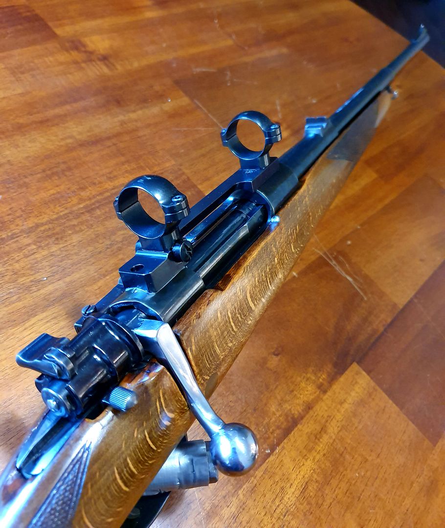

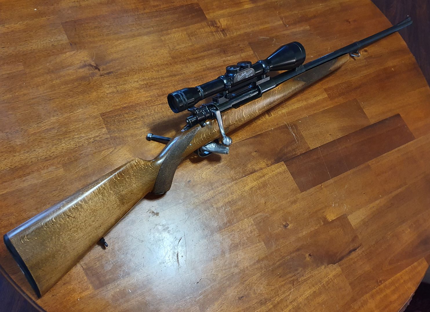

Husqvarna 46? matching serial #401xx, stamped 1943, 9.3x62, barrel stamped 9.3 mm so re-chambered from 57 I think, 22" barrel, claw mount bases front is soldered on, folding leaf rear sight 100,200, 300.

It started as a model 46A from 1942. The stock is a replacement, the barrel was shortened and would have been 600mm. Original rear sight was a single, fixed blade. Quite a bit of work was put on this gun.

Thanks, another one I bought with poor pictures and description, I like the way it shoulders, I bought it to put a peep on but now that I have seen the folding leaf I might just add a high viz front sight, very unlikely I would ever be able to use the claw mounts and might be messy to remove, I will maybe just tell anyone who asks that the scope and rings are in the truck.
