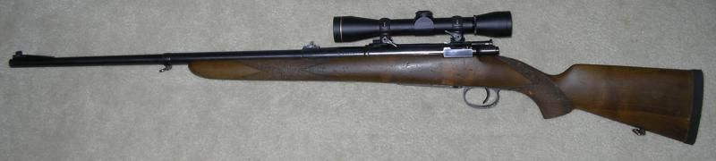

If that is the 46A, what model is the rifle using the same receiver, but without the thumb cutout like this 9.3X62?
This is the rifle I have been doing most of the cast bullet shooting with.
Ted
Not really. It's actually a 649.
There are three versions of the 640; one made on the "commercial" M/38 with the "beavertail. fore arm stock, one with the M/98 with the same stock and one more on the M/98 with a schnabel stock - same as the early 1640 and 1600 (European style, same as the 4100, but without fore arm checkering). To add to the confusion, some early 640 are exactly like the 46A and 46B but with the serial range of the 640.
The 640 are nice light rifles. I use one for walking the woods and used it to shot a moose with the iron sights, it's also a M/649 (in 9.3X62, of course!).
The 46AN is the exact same as the 46A, but chambered in 9.3X62 only with the word "Antioxid" on the barrel. Vry few were ever made - 227 actually, all with a prefix "N" before the serial number - serials being from N1001 to N1228.

Matt,
That's a model 640. The caliber will make the fine designation.
