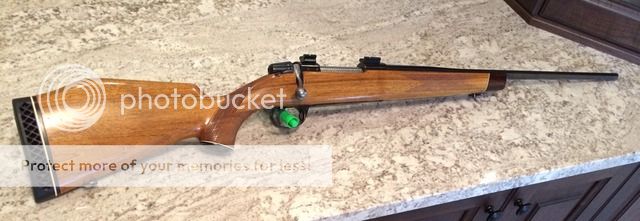

My recently acquired model 46A (I believe) built in 1942 by Vapinfabriks. This beaut is chambered in 9.3x62. It is in fantastic shape and I love it to death. Cannot wait to get a hunt in with it. For those wondering the rifle beside it is an M1-9mm carbine made by Chiappa in 9x19.

And my new husqvarna 8000, 7 rem mag.
Great guns. I'd take one of these over any modern day Sako.

wow, what a cannon. very nice. what is the barrel length on this one, please?
