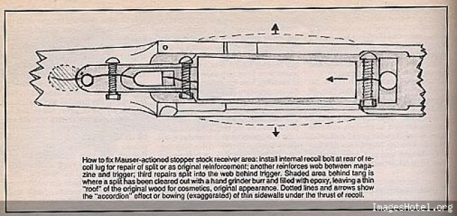

Why are Husqvarna stocks cracked so often? A slight crack at the tang is very common, almost expected. Second most common is the crack inside the stock right behind the recoil lug. I don't see these cracks appearing so commonly in other brands of rifles. I've owned a lot of Huqvarnas and I'd say 75% of them had cracks like these. Was there a problem properly curing the wood, or is it a matter of the stock design? Or?
None of mine are....
We have been discussing of this quite often actually.
Thast's a multiple issue "problem", mainly caused by the Mauser magazine and action lug. It is, actually, a Mauser thing, not a Husqvarna one, as per you can see this with a lot of Parker Haler rifles and Brno, to name these makes.
Culprit # 1 ; The Mauser double staggered row magazine in a sporter stock leaves little amount of wood on the sides, making it prone to bent especially if the bedding isn't tight or if the actions screws aren't tight enough. This drawing makes it very understandable.
Culprit # 2 ; The wood and it's condition. HVA used a lot of beechwood for their stocks and this particlar wood is easy to split and isn't as humidity stable as say, walnut in normal conidtions. The wood grain also is a factor - how many nice Parker Hale I saw with the "tang crack" Wood dryness due to storage is also an important factor.
Culprit # 3 ; Action seating. While using lugs in front of the of the action (in Mauser case, in fornt of the wide magazine) is a good idea, holding or flaoting the rear (tang) is also important. Flaoting it can cause the sides to spring though.
