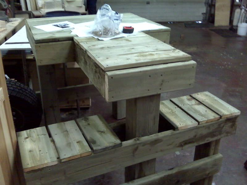

So here is the finished product. It is heavy and very sturdy. I built the seats on it. If I find them to unstable I can always take them off.
My dad has a nice big shop that help let me use. He is a carpenter, but is off on disability for a while so he oversaw everything to make sure I did it right. He gave me lots of good tips and had lots of good tools.
Finshed? Get the router out and round over (or bevel) all those edges!
You gonna bury that or will it be moved? And is there any wobble as it sits?
Router? I don't see the point but maybe later.
It will be buried 9 inches as per the instructions. It doesn't seem to wobble, but I can't tell without putting a rifle on it. It will be solid when its buried.
I built one last spring for my 300yrd range here on the farm, Buried it as per instructions and it is very stable, I routered the edges of mine because of the splinters, used 2x6 spruce and then treated it before I assembled, weighs about 200-250lbs. I also built some nice three leg portables for the gopher patch, I will post pictures if my kids will help me.
