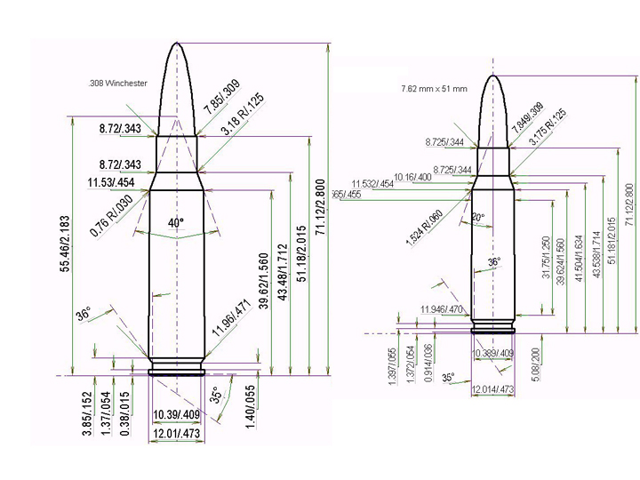

Here, looky at the cartridge dimensions and bullet diameter for 308 and 7.62x51NATO.
