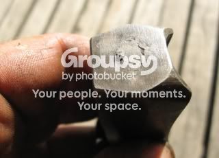

The breechblock striker pin hole has been plugged and drilled at an offset for the rimfire cartridge.

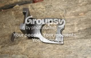

The extractor has been fitted with a bridge to pick up on the smaller rim.

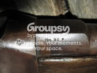

The gun has been reproofed. Pre 1912 commercial Brit proof marks and cartridge designation (22L).
Does anybody recognise this nitro proof mark? I am trying to figure out when it was reproofed.

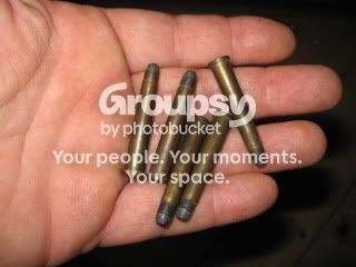

This gun is alot fun to shoot and is a beer can killer!
Reamers are readily available so I am still toying with the idea of rechambering to .22 Hornet, but for now ammo for an afternoon of shooting for ten bucks!
