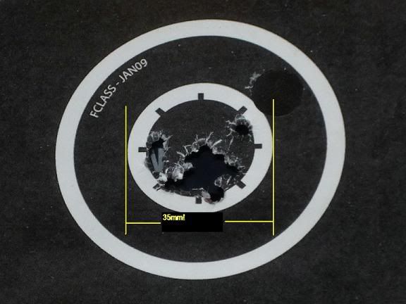

Richard and I tried the new ICFRA 35mm targets during the winter league and we both shot perfect possibles. Only, Richard kept his! Here is that target. This was shot with a Remington XR-100 and a set-back and re-chambered custom barrel in 6BR. Before everyone freaks out and believes they couldn't possibly shoot like that with their own factory rifles, bear in mind that A) the inner and outer rings here are actually worth the same amount of points (in other words hitting within a .8 moa circle is all that is needed)! This inner ring is called a "V-Bull" and they act as a tie-breaker. If two people shot the same score, they use the V-Count to break the tie.
Also... B) at the"Running of the V-Bulls!" match, this larger 70mm ring with be the V-Bull for factory guns and the next larger ring will be several inches across. In other words, a 1MOA factory rifle could win the factory class!!! There is no reason to be intimidated at all.
oh yeah... C) Richard doesn't know it yet, but I used his barrel to jack my van up to change the tire. The rest of us should have a chance.
