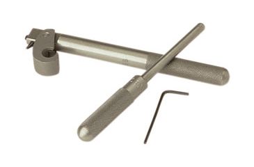

If you're going to reload... get one of those RCBS decapping tool... You'll than be able to easily reload your GP11 brass.

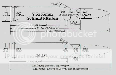

Swiss rifle owners have been using .284Win brass for many years to make 7.5x55 boxer brass before cheap ready made boxer brass was available.
Bob S on the Swiss Rifles Message Boards forum was doing it since the 1970.s
Just think of the 7.5x55 as the THE original .30-.284 Wildcat cartridge from 1890, revised in 1911 with the first(?) VLD bullet and again in 1931.
Just needs FL resizing in the 7.5x55 dies.
I've used it, along with Prvi 7.5x55 and reloaded GP11 with RWS Berdan Primers.
Some K31 have a slight problem catching the rim on the .284 case, so some extractor bending may be in order for trouble free extraction.
