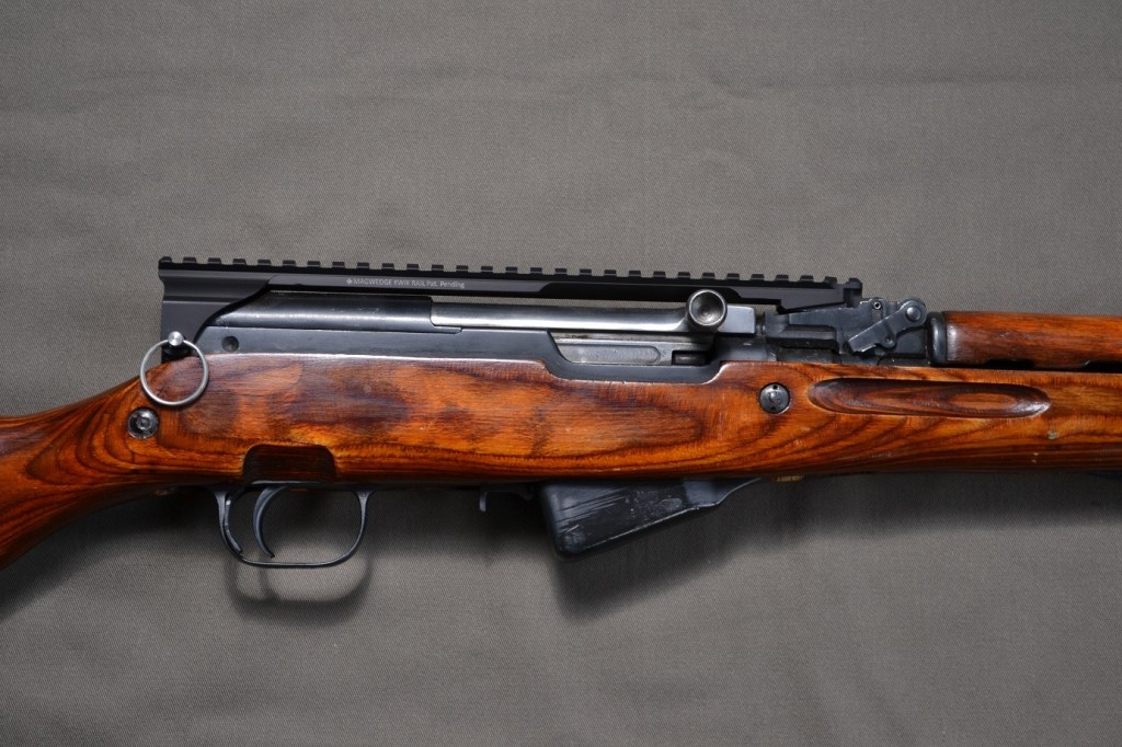

Magwedge kwikrail gen2 or gen3 for a rail, bed the action in the stock, diy trigger job. That's about all I'd bother doing to the sks if it was me.
I like that exactly what i was looking for THX Edit: can i use a bolt instead of the pin so i can tighten it down or is it already realy tight on there
