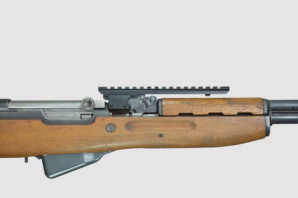

At the back, the hole in the mount on both sides where the pins slips through are almost always loose (Ive had both magwedge & wartak rails) meaning every time you tighten the mount back down, there is the potential of it sitting not exactly in the place it previously was. Plus too if the bolts arnt tight enough, the vibrations will make the bolt slowly chew away at the mount. I switched out the bolts on both the rails I once owned to countersink bolts, which helped with the return to zero, but the still.... every time you clean your gun, you take out the pin, over and over again, over the years, the mount gets sloppier and sloppier.
Still, they arnt bad mounts, especially if you dont want to alter your SKS, and although they may not return to zero exactly every time, they get pretty close, like within 3"s ive observed.
If the will power is there, the drill tap mounts are superior for obvious reasons.
Id go the drill tap mount route before id get the Kwik/wartak style rails....

So what do you guys think of the plan and is there a decent scope mount for these i have access to a mill if i really have to go that route
