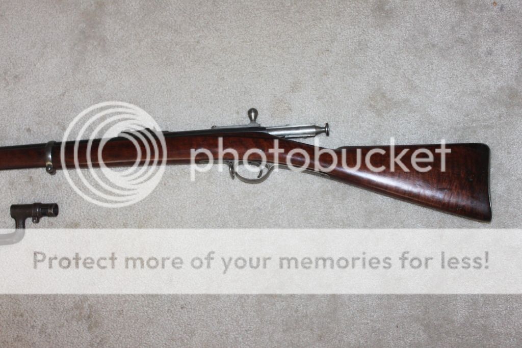

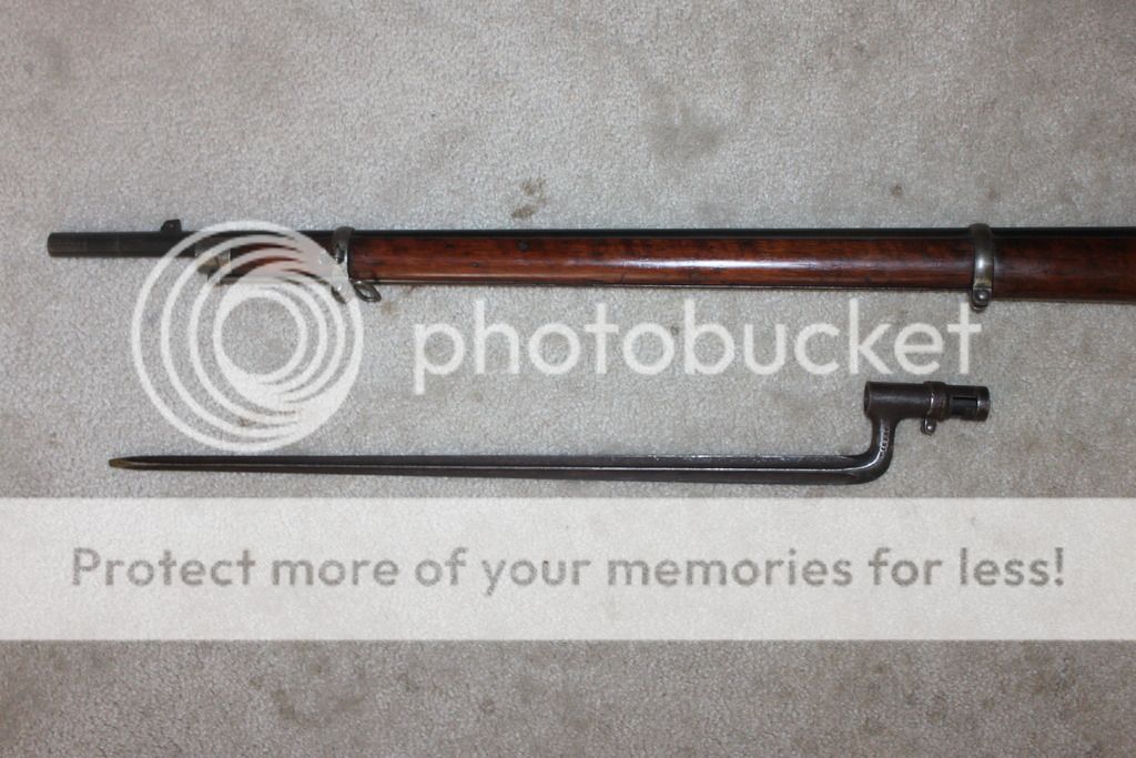

Ok here are some pics. The cleaning rod seems shorter than most pics ive seen online. It measures 73.5 cm overall. If anyone has one to measure that would be great. Bore is in mint condition.
Very nice condition! Nicer than mine...
The cleaning rod should be numbered and measure 831 mm long.

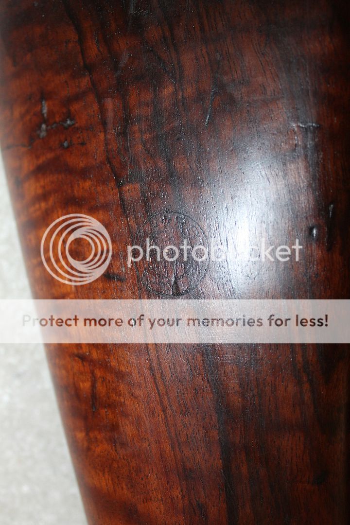

The stock and buttplate should also be serialized, but by the stock stamp I'm going to bet the stock is matching? The colour seems a bit off though - I believe the colour should be lighter, so I suspect it got re-treated?

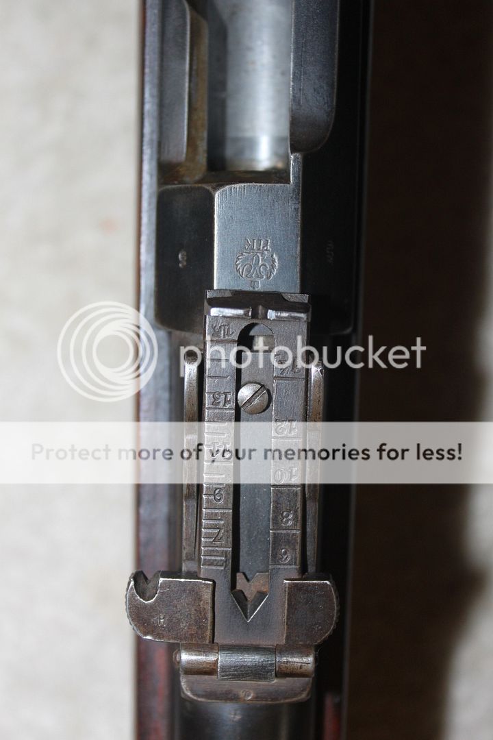

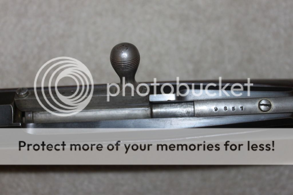

The bolt should have an arsenal stamp - it's not matching but if it has an arrow then it's at least arsenal matching?
Here are some blueprints if you are interested: ... [no www]ar15.com/archive/topic.html?b=6&f=14&t=236794
Cleaning rod does not look like Berdan one at all. And not all Berdan II rods were numbered. BTW you have to revert front barrel band so auxiliary front sight sits on the right side, not on the left. You see auxiliary extension on the right side of the rear sight? That is to be used with auxiliary front sight on the front barrel band. Nice score on bayo (if it's positively Berdan bayo)!
