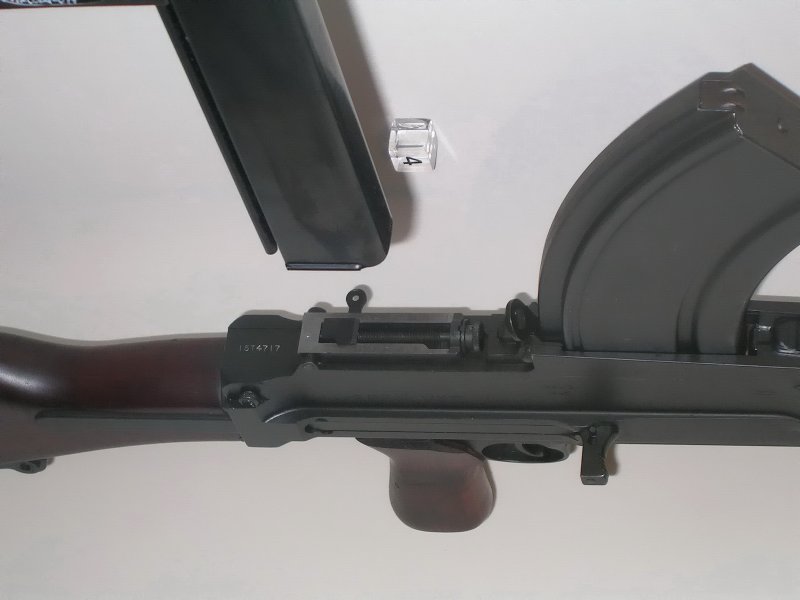

As for the serial number have a look at this. It looks to be in the white or is that a grease pen? The rear sight says it all I guess. Its from the Canadian War Museum. Its actually one my own pics, give you an idea how many pics I have taken over time. Forgot all about it. Looks like I,m cleaning out the numbers on my Bren as well as my High Power.
Interesting your sight is parked though but the serial numbers are in the white. If you have a look at the rear sight here in the pic it looks as though some park is still evident on the top of the sight by the elevation adjustment? Maybe the one in the museum was refinished?
heres a zoomed in pic http://www.pbase.com/mrclark/image/63521183/original
Mine isn't in exactly the same shape as this one Clark:eek:
The serial looks basically the same, engraved after parking. I guess so does the rear sight. Kinda like it was parked and then the front face was "cleaned" / machined with the numbers after the parkarizing:confused: :confused:
Mine just got a bit more "patina" on it;) .
