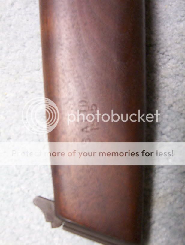

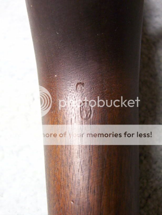

The Chinese repros were very well done, they copied all the marking and date stamps (SA LTD 1945). the big difference is they used a different type of wood and stained it. They tend to look much darker. Also the grain of the wood is not as dense as the Canadian originals. Hard to tell from his second photo if its Canadian or Chinese, someone could have tried to refinish an original years ago, accounting for the darker look. You would have to see it in person to really know, or get better photos. Not a great deal, I'd try to talk the seller down to 125, maybe pay 150 if confirmed original.

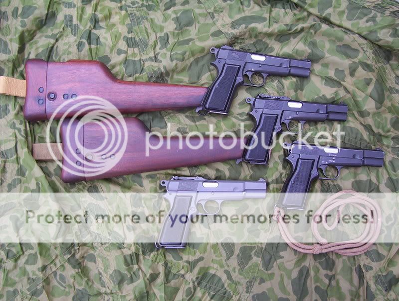

Pblatzz the top one is for a Mauser, it looks original, the bottom one is deffinitely a Chiniese repro for the Hi Power.

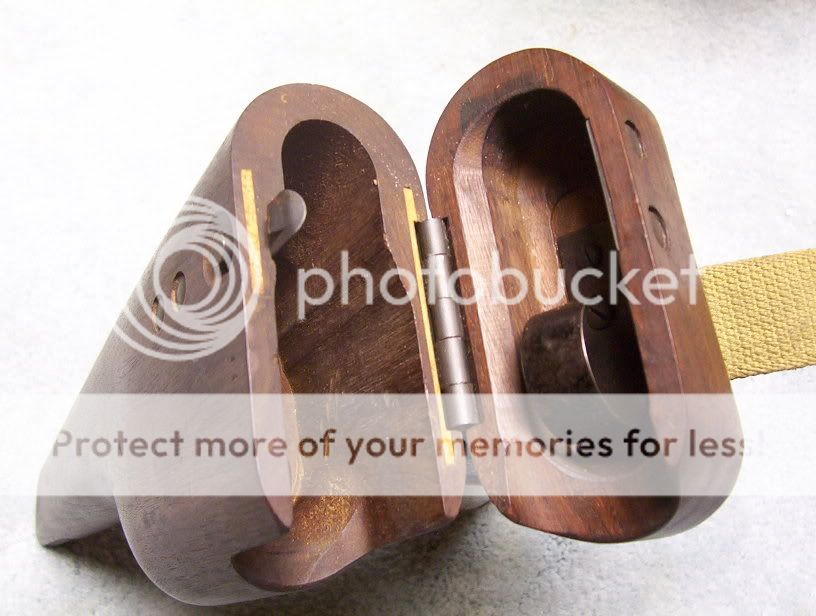

I have some good photos I can post later this evening of a real Inglis stock.
Note the different hinge
Chinese repro
Original Canadian
