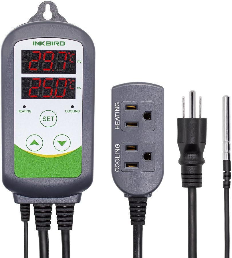

I bought an Inkbird temperature controller on Amazon for $40. It's complete, plug and play. Been using it for 3 months on a lubesizer, it's worked 100%. Several different models, the one I bought is1200 watt max, 250f probe, has outlet for cooling and heating devices but I'm only using the heater side.
Very good deal for the price.
Yup good stuff.

This one I got is a self contained unit, just plug it in and go. Think it's designed for small greenhouses and home grows.

Agreed, they are handy. I have a bunch of them for home brewing. PID for my electric boil kettle, and a few of the type in your picture for my keezers and fermentation chamber.
the one you pictured is a relay output one I'm pretty sure.

Temperature control is plenty good as is for a lubesizer.
Are the thermocouple replaceable?
I haven't replaced a thermocouple yet and they are sealed and hardwired, but should be able to just cut the cable and splice 2 wires. Could even splice in a plug if you wanted to be fancy.

I have looked at these in the past. I don't think the sensor is a thermocouple, I seem to recall it's a PT100, which is a type of Resistance Temperature Detector (RTD).

No, the PT100 limits the range to something like 200 degrees max. Maybe they have something new in the last year, but I wanted to start importing them and couldn't find one that would work.
