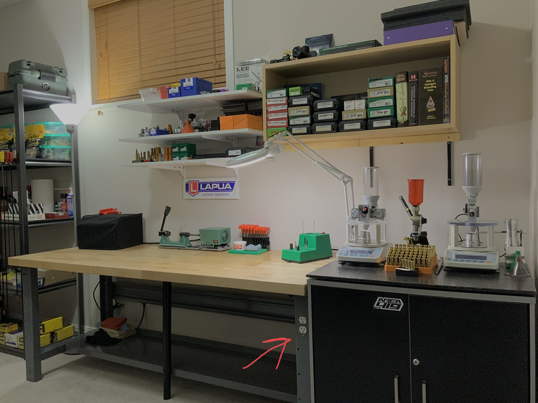

I will have three of Dan’s Micro Ultramount 4” units. Two for two Coax’s, and one for a Lee Classic 4 hole turret. Like the OP, I just replaced my bench. My original “bench” was a repurposed 24”x 96” door. I now have a Uline industrial packing bench with a 1-3/4” maple top (and much more counter space). [/img]
I bought essentially the same packing table fro Uline. I chose the composite wood top. I like how the table legs are cutout for electrical outlets so I made up some extensions w outlets to have power at each corner of the table. My old setup had multiple extension cords and power bars stashed under the bench. This is so much better. :)

I added that to support the center of the table.
Good idea. I've got a 4x4 that is long enough to cut down to fit. Think I'll add that as well. Doesn't cost anything and is sure to help make the table surface steadier.
PS Be careful about how much weight you put on the lower shelf. I loaded mine up w bullets etc and it collapsed. I had to put a length of 2x4 under it to prop up the shelf.
I used an adjustable table leg from Ikea. I also attached the bench to the studs in the wall behind it. That combined with the center support, and that bench doesn't budge. Which is a big change for me from my old set-up.
Hmmmm ... I happen to have one of those Ikea legs. I'll have to have a look at it and see if the length is right for that application.
I also attached my table to the wall studs.
