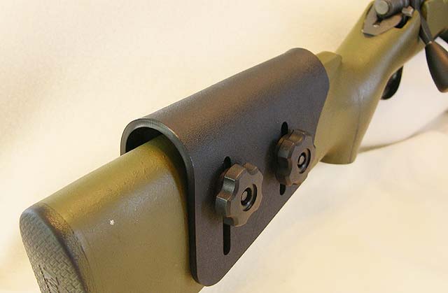

I hate the Kydex style bolt on cheek risers. They have exposed bolts, nooks, and crannies that will snag on everything in sight while packing the rifles thorough thick brush, which I do frequently with this rifle. I will not be considering this style whatsoever.
Kydex style...

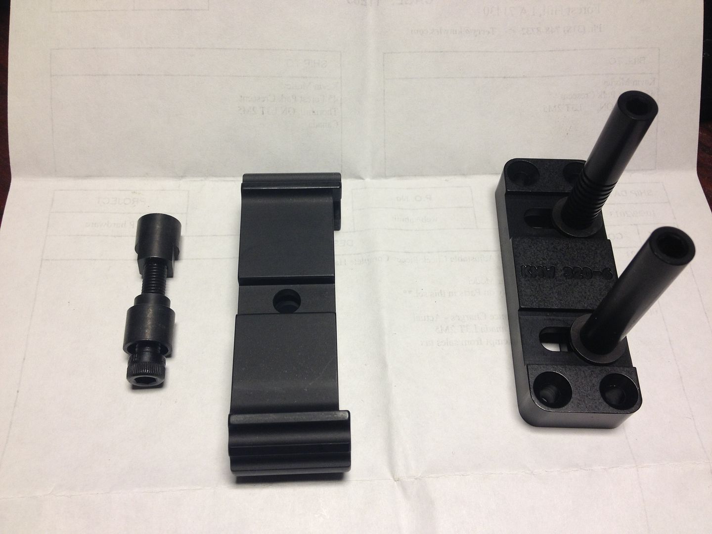

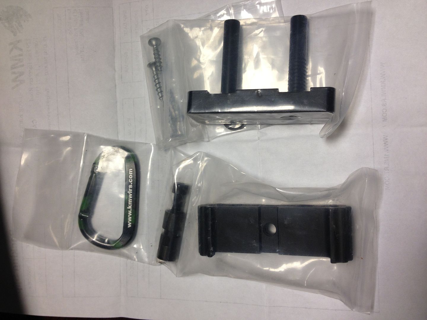

I stumbled across a website during my search with a product that seemed perfect... The Loggerhead cheek riser. (Their website is partially under construction, so it is unfinished)
The guts of it are simple too, not much to go wrong... basically you have a professional cut and inlet your stock for the hardware, and it sits completely inside the stock. It is adjustable with a single allen key, and has E clips to save your preferred height when removing the comb to remove the bolt of the rifle.
I have been chatting with the owner of the company back and forth via email, Terry Cross, and he is very helpful describing his product and why it was designed.
I picked one up, as they are very affordable, only $50.00 US... and was just curious if anybody had any similar experiences or insight with this product or similar ones, and what your opinion would be on the suitability of the HS-precision stock for this product. (If I don't use it on this rifle I will on a custom build later anyways)
