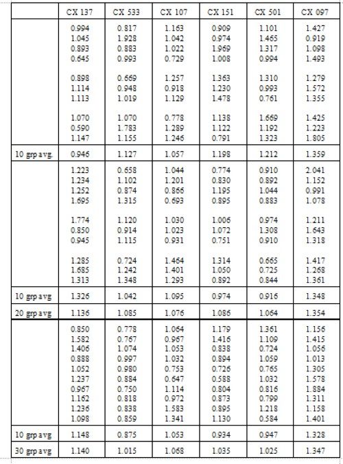

Below is a chart showing the results of six different lots of ammo shot this season with the same rifle. Each set of ten ten-shot groups was shot at a different time. All were shot when wind flags indicated relatively calm conditions, but not necessarily equally calm. The results obviously show some sets of ten-shot groups were shot in conditions in which wind movement was obviously not the same. Of course it's possible that some group sizes were the result of shooter error.
While four of the six lots tested had a ten group average under 1" and only two did not, I don't think CX 097 could achieve a sub-1" ten group average with my rifle under any outdoor conditions.
To continue with air movement, it would be much more straightforward to shoot at a range where wind was constant in direction and speed. Unfortunately that doesn't happen, especiallly at smaller ranges in which air movement changes direction and speed often. This is characteristic of the 100 yard maximum range at which I shoot. I use three flags at 100 yards, and when conditions are best there is no motion detectable in the flags. When there is air movement, sometimes only one flag shows it, sometimes two of three, sometimes all three. To make things more challenging, sometimes one flag can be limp while the other two show air movement in opposite directions.
Shooting .22LR outdoors at 100 yards for best accuracy performance is not easy. When you see group location move or migrate between bulls, it can be the result of changing air movements, which can be hard to detect, or the result of moving the rifle/rest to a new POA. When this happens I'm often unsure of which is the cause. As a result, my priority is seeing how well thee ammo groups at 100 yards, rather than trying to center the group on the bull.
On top of that, when shooting different lots of ammo, as I have been doing this season, it can take a while to determine whether the rifle and ammo are zeroed to the POA. I usually don't bother as I'm not shooting for score on the targets used in the challenge and on this thread. My concern is more with precision when comparing ammo performance.
There is a better method for assessing performance than simply measuring the group size. It is calculating Average to Center. It's also known as "average group radius" or "mean radius". It's the average distance of all the shots in a group from the center of that group.
To give a brief illustration of this, consider two groups with the same overall group size. One group has all ten rounds relatively evenly distributed within the imaginary circle around the group. The other has eight or nine shots all very close to each other, with one or two shots away from the majority. The second group will have a smaller average to center measurement, which reflects greater precision.
The problem with obtaining Average to Center measurements is that it is necessary to use some software to avoid otherwise tedious calculations. This can be done using software such as OnTarget, which is available online. No doubt there are other programs or ballistics calculators that will calculate average to center.
For a few more details on Average to Center measurement, see https://www.rimfirecentral.com/threads/understanding-the-average-to-center-measurement.512993/
