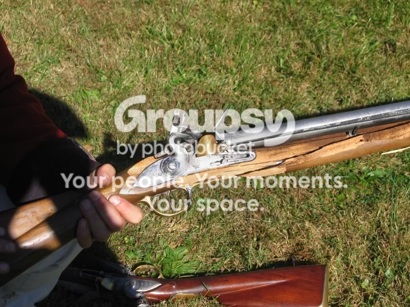

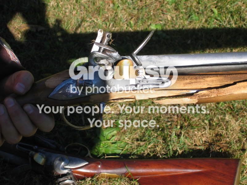

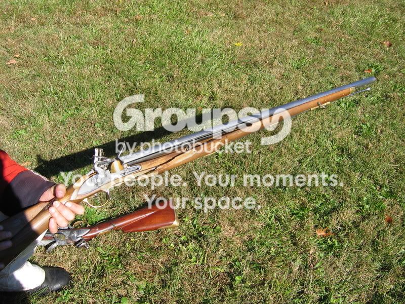

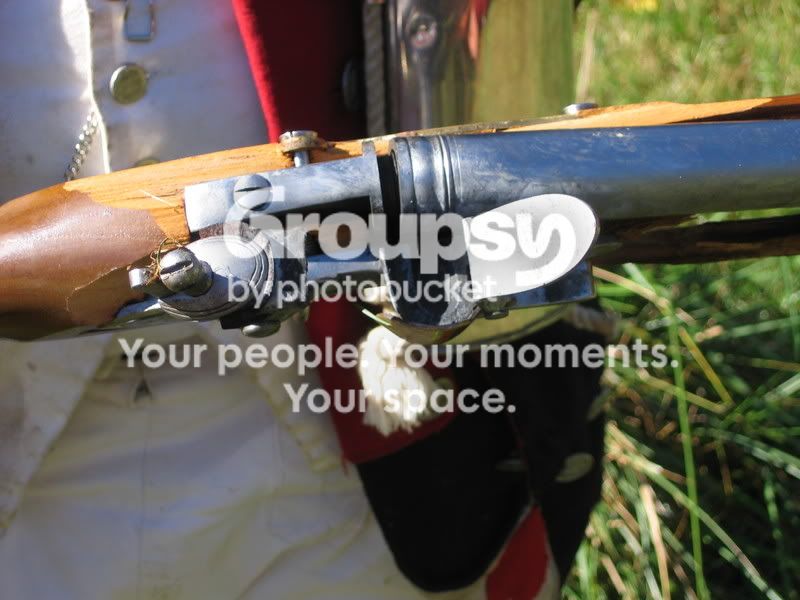

I found this on another forum and thought it may be of interest to fellow BP folks. I have some doubts about some of the "facts" stated. Below is the information supplied with the photos. I don't believe it was a Loyalist Bess because their India Pattern Bess has the beaver tail around the tang.
"Well, it's happened, an Indian repro musket has gone boom in most dramatic fashion. At a recent reenactment, one let go at the breech, split up the side and blew its stock apart. Two injured--shooter suffered cuts and two broken fingers, his mate to his right suffered a perforated eardrum.
This happened with a single load of 110 grains of BP."
"I mentioned that it looked like the breech had blown first, and the split had propagated down the weakest part of the barrel--the piece between the breech and the vent, and then on past the vent, like ripping a piece of cloth by clipping it at the edge. I couldn't figure out for the life of me how they got the powder contained enough to build up that much pressure. Your info about powder getting into the breech plug threads is quite pertinent there, and speaks to poor quality of manufacture more than anything. As I understand it, this gun had only fired a few dozen rounds before it blew."
