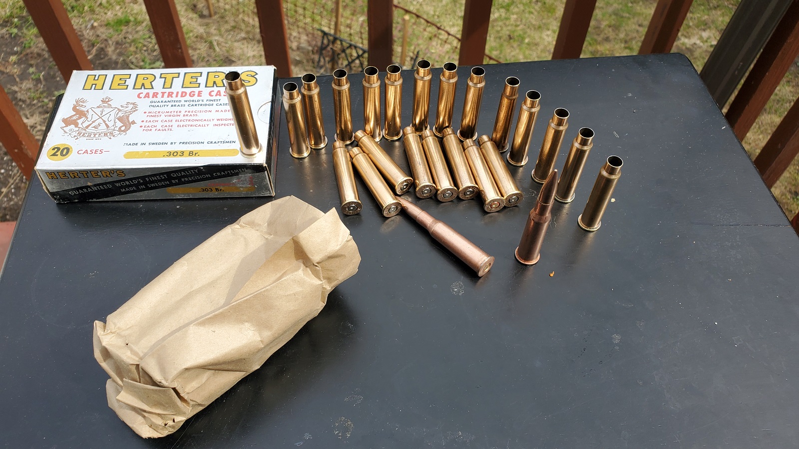

Here is a picture of the packaging of the lot of 100 unfired Herters 303 British reloadable cases that I obtained from an auction site - about 6 weeks ago. The inside of the five boxes has a 72 stamp - which I suppose may be the year of manufacture.
As also shown, I have fireformed these to 303 Epps Improved and loaded them to 7.62x54R specs and fired them from a 303 Epps rechambered P-14 - where the max working pressure is 59K psi. You'll see that - even at that loading these things (fired twice so far) exhibit none of those trashy expansion rings that you get with the first firing of that junk 303 British US commercial ammo sourced brass.
