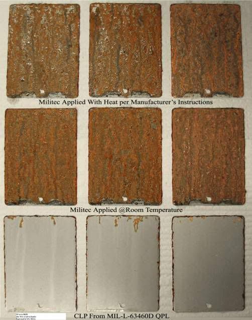

I used Militec for a while but when hot it smells like burnt hair so I now avoid it.
Where are you getting the Slip 2000 from?
Came from a US Army test.
Part of the debunking of the Snake Oil garbage that permated after the Jessica Lynch 507th Debacle.
Grease -- works well on some applications, but especially with suppressed weapons will gather up too much crap, the crap that an oil will allow to move out of the way.
