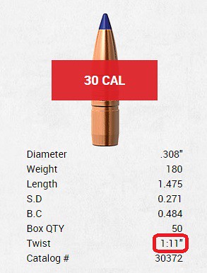

The 180gr AB is a long bullet as shown, almost as long as the 240gr Woodleigh. Wouldn't group better than about 3 to 4" at 100 meters off the bench from my .308 CZ550. I think the 165gr AB should stabilize properly with a 1:12 twist.
The 180gr TSX is also a long bullet and might not properly stabilize with a 1:12 twist but a 165gr TSX likely would.

Interesting. The higher muzzle speed imparts a higher rotational speed that's fast enough for proper stability. I once tried sub-sonic 400gr loads in my 1:14 twist .416 Rem. Mag. but the low muzzle speed wouldn't put a fast enough spin on the bullet to stabilize it. Shots were all over the place with some key-holing.
Good accuracy with the 180gr AB's in my 1:11 twist Sako 85 Grey Wolf .300 Win. Mag. at around 3100 fps MV as well as the 180gr TTSX which requires a 1:11 or faster twist according to Barnes.
