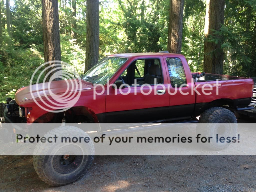

Here's a pick of mine. '89, solid as swapped with rear springs up front to push the axle forward 5", double bobbed box with the rear axle pulled in 12", dual cases, 4.56 gears, flatbelly, 8274, stripped 22re, it's on 33s and steel beadlocks here but I'm on 35s on aluminum wheels now for street driving. Haven't wheeled it yet because I'm still doing the shakedown.
