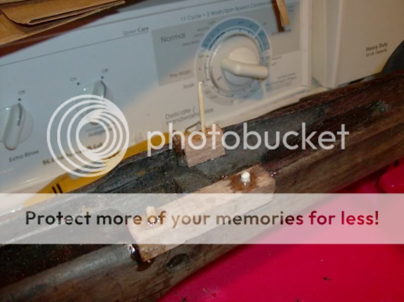

I gots to know, do you repair your Enfield stocks using the regular or the delicate cycle and do you use fabric softener after shaping and sanding.
Sorry…… :D but please notice I didn’t ask any questions about duct tape

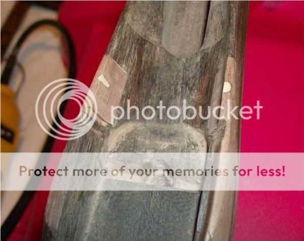

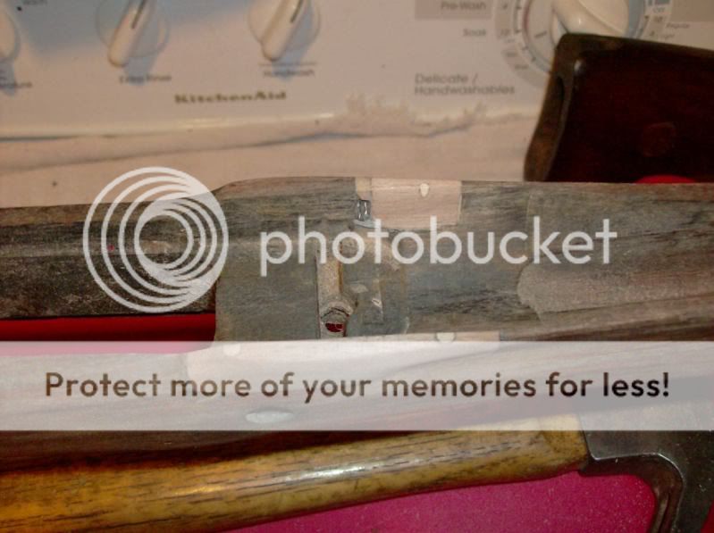

Here's where I am tonight. Not perfect, but I hope once stained the remaining irregular areas will not be too apparent (can feel them with the finger, but can't remove more wood to even them out because there's so much wood you can remove!). Always tricky to just get it right, without going too far...
I've finished doing the fine fitting of the barreled action in the forend. This required carving out some grooves for the rear handguard retaining ring. Small detail but interesting job to do.
Now I need to fix a damaged handguard to go with this!

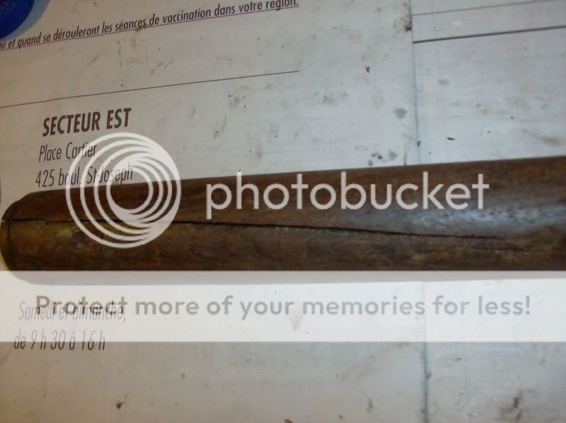

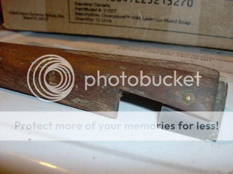

I started on the handguard. It had two long cracks and a missing chunk.
I decided to work on the cracks first.
The cracks will need a few touch ups (bubble in the glue), but I'll deal with this after the chunk is repaired. I cut some wood off to have a clean section to work with. I will shape the replacement wood (soon...) and post pictures after that step is done... I know I'm not fast!
It's a lot of work for a simple P14 rear handguard but it's fun. Plus, finding a replacement rear handguard isn't easy, for some reason!

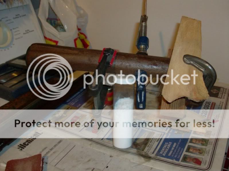

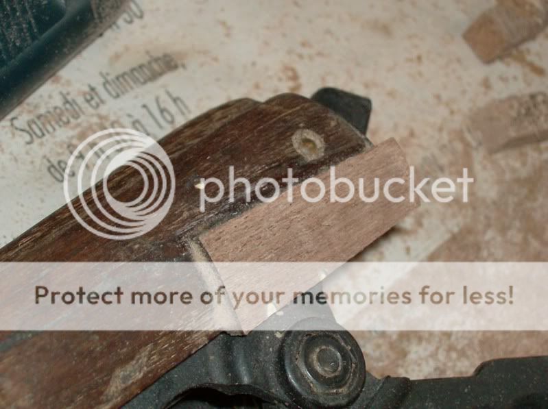

Well I finally got some time off and decided to finish the repair on that handguard.
Here's the part that I preshaped for the repair. I left lots of spare on the exterior side. The interior side had to be shaped more precisely to fit on the metal part.
Here's the part glued and clamped. Too bad the clamp is hiding the two wooden dowels that I put in vertically for reinforcement (they actually are tooth picks, because it's a pretty small repair).

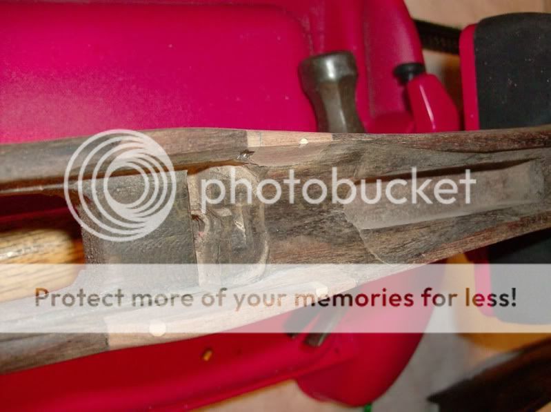

That was done yesterday. Now this morning, I started sanding. Here's the part after about half the final shaping done.
And here it is with shaping done. The laundry room is full of sawdust but I can clean up before the Mrs comes down :D
I would have liked to better "aim" with my drill when I made the holes for the toothpicks. But the margin for error was, well, pretty much inexistent. So I can see the toothpicks after sanding. I will use some stain, and it'll still be visible, but hey it's a repaired part, I don't think it'll be ashamed to show it's real identity.
