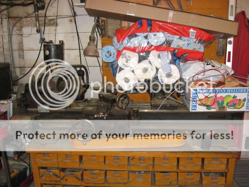

Those old South Bends are hot. I wonder what model mine is. 9" throw, 4.25' bed. The westinghouse motor had to be replaced with a more modern baldor though.
Where do you shovel the coal? :p
Ha ha. You're funny. Not. You can go sit down now.

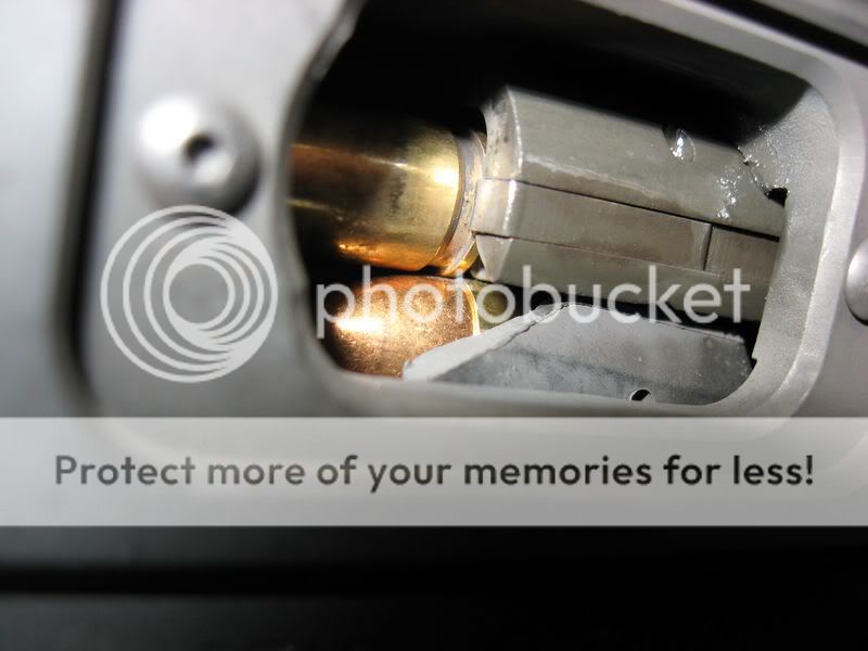

So I dug out the swivel gopher bench from the back of the shop, and was going to do some accuracy testing yesterday when I ran into a FTE/stovepiping issue in a big way. I had loaded up with American Eagle 115gr to start, but the first two mags had 17 out of 20 rounds that didn't eject, and either stovepiped or were jammed in other interesting ways. Thinking I had screwed something up while doing the takedown video or switching the extractor/ejector, I stopped and did a total disassemble, clean, check and reassemble. Not finding anything there I noticed the mags I'd used were brand new KCI 10/17 (all of the shooting prior to this was with the supplied Glock mag), and using spent brass and dummy rounds I found that the bottom edge of the spent case could juuuust catch the top edge of the next round in the mag when it was coming out of the chamber. Apparently that could act as a premature ejector (maybe I should rephrase that), and was causing the FTE's. I didn't see anything when inspecting the mags, and they didn't appear any different than the others, so I marked them and quit for the day.
So today I loaded every mag with CCI, shuffled them and went shooting. And every round chambered, fired and ejected without a hitch. I then loaded up with the American Eagle, and every round chambered, fired and ejected without a hitch, except for the 2 marked KCI mags which had numerous FTE's again. I then reloaded these two mags with some MFS ammo, and they worked 100%. And when loaded with CCI, they worked 100%. And then I loaded with AE again and...they worked 100%. Hmmmm. Suddenly all is good in the world once again.
So I dunno if there was some flashing, extra spring pressure or what might have been in those two mags that was causing this, or what else might have been the issue. In any case it seems to be cleared up for now, and if nothing else gave me a reason to shoot some more. As Old_Painless says so well...Shooting stuff is fun. :)
Farmer Harv: I ran into the same problem using the same mags (KCI) but with 115 gr UMC bulk pack. 124 Geco & 115 MFS gave no problems. I noticed that the MFS is loaded somewhat stiffer than the UMC to boot.
sorry to hijack the thread, but I replaced the WH motor on mine with a Delta Industrial 3-phase 1hp 220v motor and an IMO Digital Phase Converter. I can now vary my motor frequency with a potentiometer almost infinitely without loss of torque across the pulley settings. BEST MOD EVER.

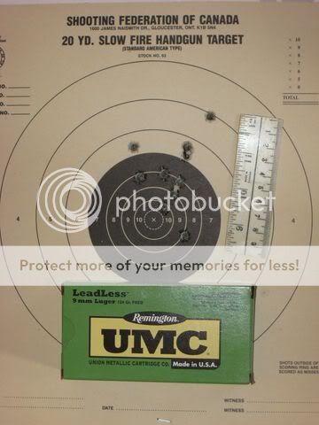

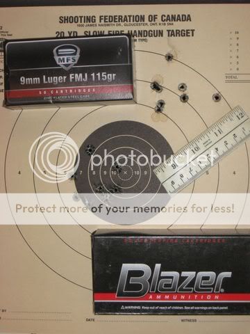

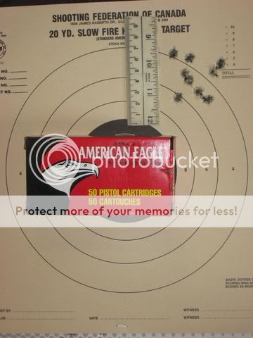

Here is another set of targets from today. All were shot at 75m (any further and I'd have to walk uphill through neck deep snow...both ways) off the swivel bench pictured above.
Only the UMC 124gr was shot with ten rounds. The rest are 8 or 9 rounders, as I borrowed a round or two from each box to try a mixed mag load yesterday.
Mant the AE and Blazer grouped nice for 75m. Nice job buddy!!!!!
Yes, I'm quite pleased with the CCI group especially, as I have a few thousand rounds of this stuff stocked up. As an added bonus I won't need to worry about recovering brass if I use it for my field load.
