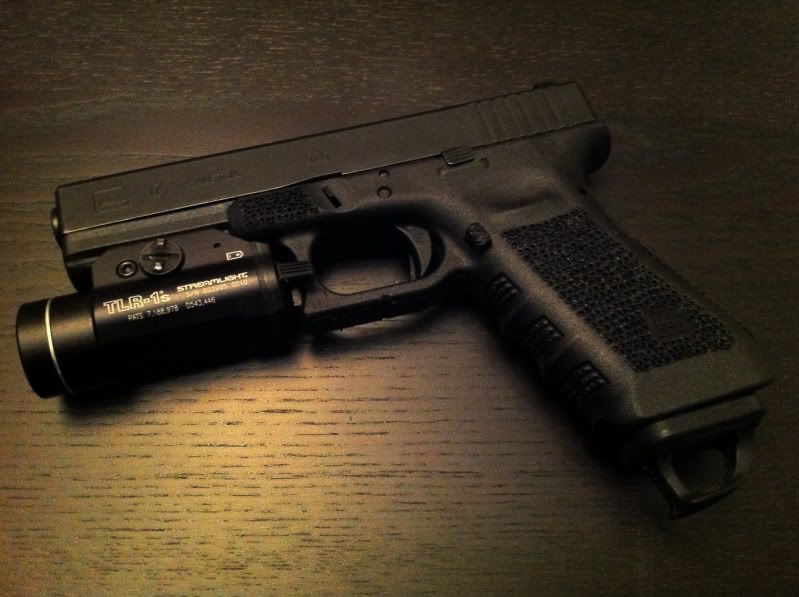

Well after planing on do this for almost two years I finally grew the balls. It wasn't that hard, I had already removed the finger grooves, they messed with my grip while wearing gloves.
I now present my uglyfied Glock:
I was always jealous of gunner grips on 1911s and wanted to copy theire girppyness.
My glock now sticks like velcro
Shawn

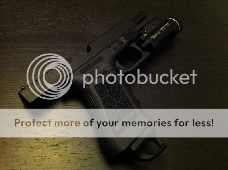

After almost a year of humming and hawing about doing it, I finally took the plunge!
I did a grip reduction on my G19 and stippled it.
Here is a before picture.
I always found that despite being billed as a compact gun the Glock never felt small in my hands. I also felt like the gun tended to move in my hands a bit while firing and reaching for the controls. Well all of that is a thing of the past!
Here are a few pics of how it ended up.
I did a lot of research on this project before begining and decided that I would not take the backstrap down past the point where it would be parrallel with the front strap. That idea quickly got thrown out as I slowly ground away material and tested the fit in my hand. Aestheticaly, I know it doesnt look as good this way, but the feeling of it is INCREDIBLE. I dont have to reach for the slide or mag cathes and the trigger sits perfectly where I always wished it would.
I did this by removing material in a few places.
I deleted the finger grooves and relieved that portion of the front strap that meets with the trigger guard to make a little more room for my fat, arthritic fingers.
Then I started stippling. It didnt take me that many hours overall, but I had to spread them over two days because all I could think about was the arthritis pain in my fingers as I worked the soldering iron repeatedly over the frame.
The only real problem I ran into was when I tried to stipple the epoxy. No matter how high I turned up the soldering iron, I just could not make a dent in the stuff. So, I had to use a small ball-end engraver in my dremel and do my best rendition of a super closeup view of an arthritic joint. Functionally, it is fine. I realize that it doesnt look so hot but I dont think that there is anything I can do about it now. I could grind it down, dam it up with play-doh and have another go at it with a different type of epoxy, but I dont think I will. As I said, it works.
Overall, I am very happy with the end result. I just have to figure out the best way to re-colour the frame as this tuxedo patern isnt working for me. I just cant bring myself to use truck bed paint either. I bought a can of it, but I just can not bring myself to do it. i dont know what I will do yet. But until I do, I am happy to say that this in one very shootable Glock 19.
