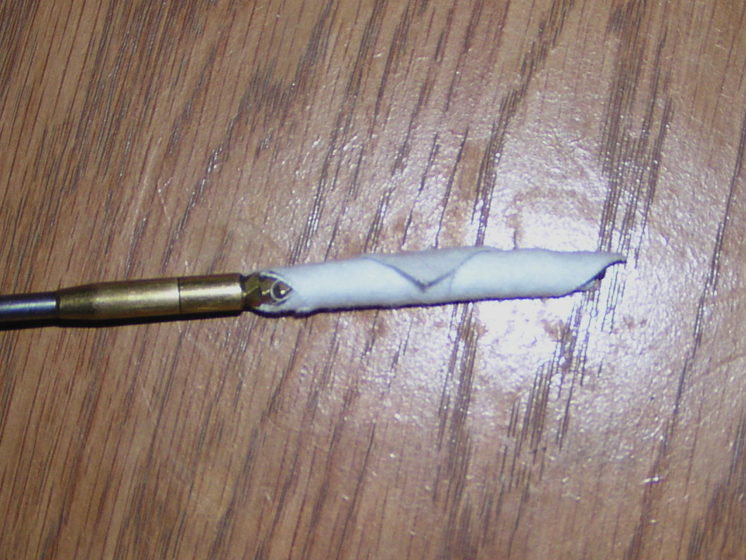

Degreasing.
1) Cut up some patches about 6 inches long by 1- 1 1/2 inch wide when at home.
2) At the range, remove bolt.
3) Screw jag onto rod and wrap the patch diagonally across the jag at about a 45° angle. Should be a snug fit but easy to push through without effort.
3) Repeat until patches comes out without grease. I often reverse the first patch for the second pass and rarely need more than three passes.
If using square patches.......
