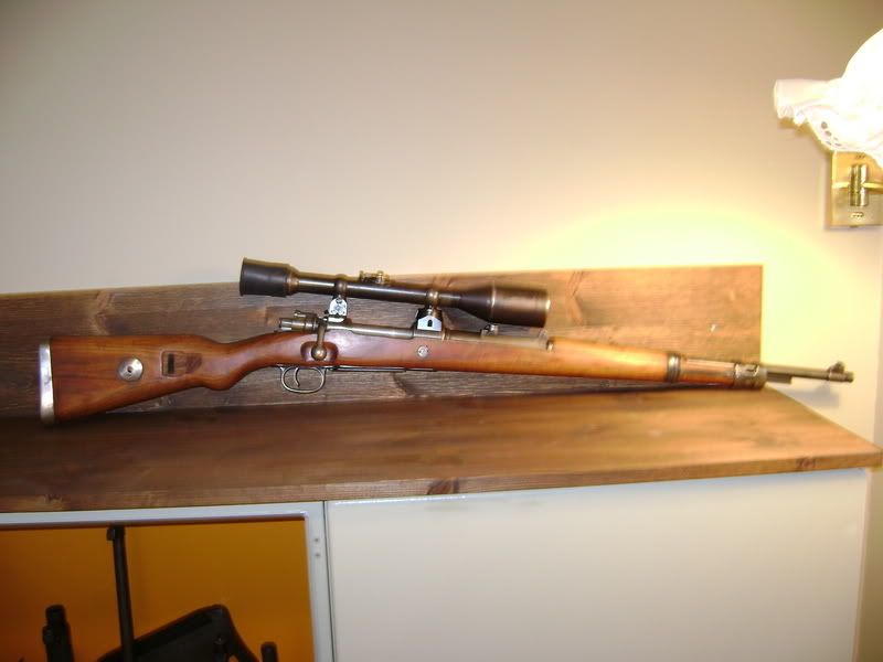

- Original 8 Power Zeiss Zielacht Scope
-High Turret Mounts
-K98
Avoid the Chinese Scopes as after 3 shots the recticle moves out of place from what others say.

Turret mounts would be the way to go if you want to be as correct as possible.
Forgive my ignorance, but the turret mounts are the ones shown in Coyote Ugly's photo correct? I am a fan of the scope pictured in that photo too, any idea of how hard to find these are? I did a quick search and came up empty.
Turret mounts
Keep in mind there are low and high versions. The high version being roughly 1/4" higher than the low. This is dependant on the size of the scopes ocular bell. Zeiss and Ajack scopes fit the low for sure.
Also these ring require disassembly of the scope to install. Big PITA if you want to do it correct as possible. And they have to be soldered along with the bases. Accumounts offers two piece rings to save the work involved.
