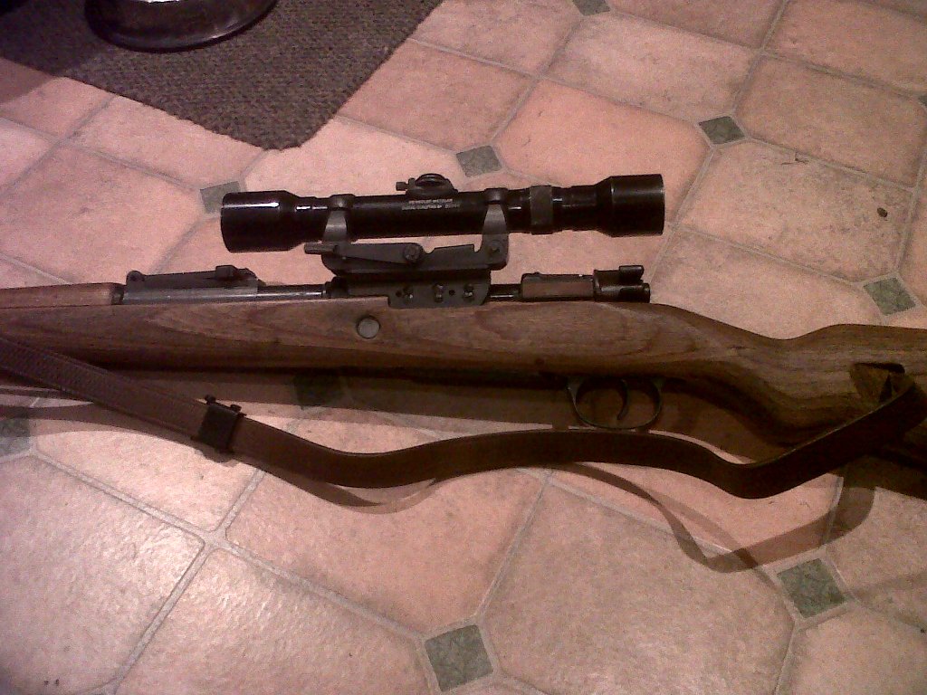

Here's my clone.
It is a CE44 that was already drilled and tapped for the LSR mount and luckily the repro mount fitted with no drama apart for a very small amount of wood that needed shaving off!
The scope is a 50's Hensoldt Wetzler Dialytan 4 power from the chap that was mentioned earlier in the thread (Germansniper) and it is a cracking bit of kit for the money. I had to remove the inbuilt dovetail from the underside of the scope and bore out the rings to suit the oversize scope body but I am pleased with the results. It gets regular outings at my local range and against figure 11 pop-up targets out to 1000 yards on our local military training area. Also had to replace the lazy mainspring for a wolf spring as the Yugo 55 surplus that I have loads of often needed a couple of taps to go off but have kept the original spring. I now reload for the rifle and it can be surprisingly accurate when I do my bit!
Sorry for the rubbish pic but it was from my old phone.
