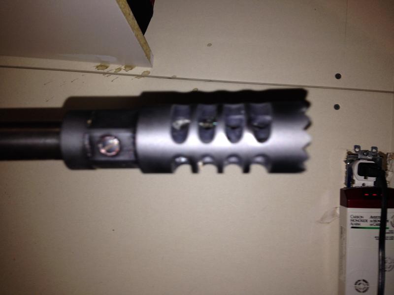

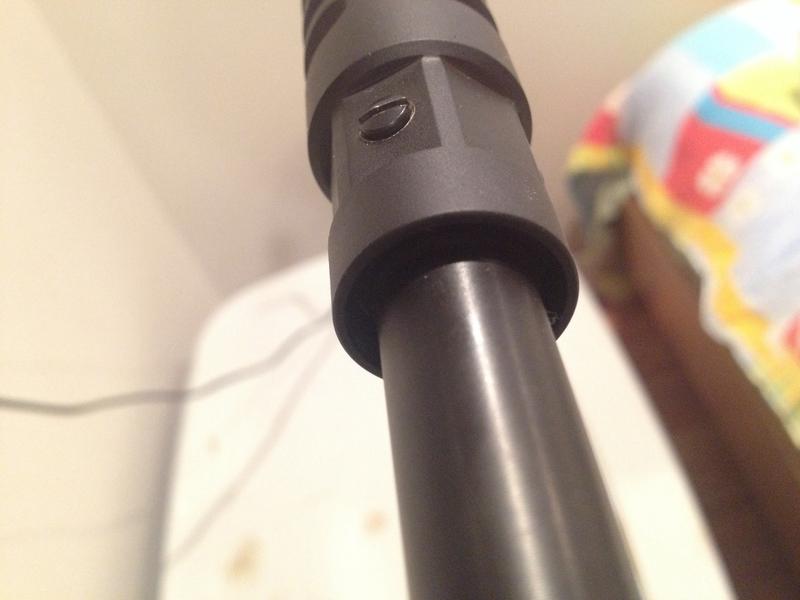

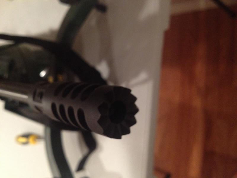

Is that a flash hider or a break. I would like some details on that. Thanks for posting.
it's a Flash hider/Muzzle brake combo,got it at Ironeagle tactical. I had a gunsmith bore out the flash hider so that it would fit over the muzzle. He had a piece of steel rod exact same size as barrel . That he used as a replica,he bored out flash hider just enough that he had to use heat to slide it on the barrel.he also drilled three holes and used set screws,and locktite.the flash hider has an 1/8 inch protruded ridge on it,so if you bore it out enough,the flash hider covers the raised ridge that is on the tip of the barrel. It took about a hour or 2. After 500 rnds it's very solid.
How far does the barrel protrude into the vented area? I'm surprised they shipped that out of the U.S. I wonder if it might be better to just thread the end of the barrel for one of these? Were you able to notice a reduction in flash?
The flash Hyder is 3 1/2 inches long, The barrel inserts into that first vent hole ,which is 1 3/4 inches.ironeagle ships Su16 mods made by Red Lion precision. Can't get a trigger or stock though ( they are not allowed to ship those two items). Because the barrel is permanently attached to receiver my gunsmith couldn't fit it in his lathe so we went this way. I don't see any flash, so I can't answer that question. It covers the raised ring on barrel and it only adds about 1 1/2 overall length to barrel. I've fired 100 rnds fairl fast and got the barrel really hot and the flash hider didn't budge. I like it this way but it's not for everyone, I'm sure it would have to be done perfect for it to work.
