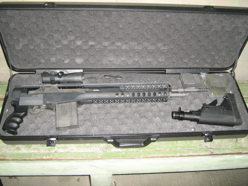

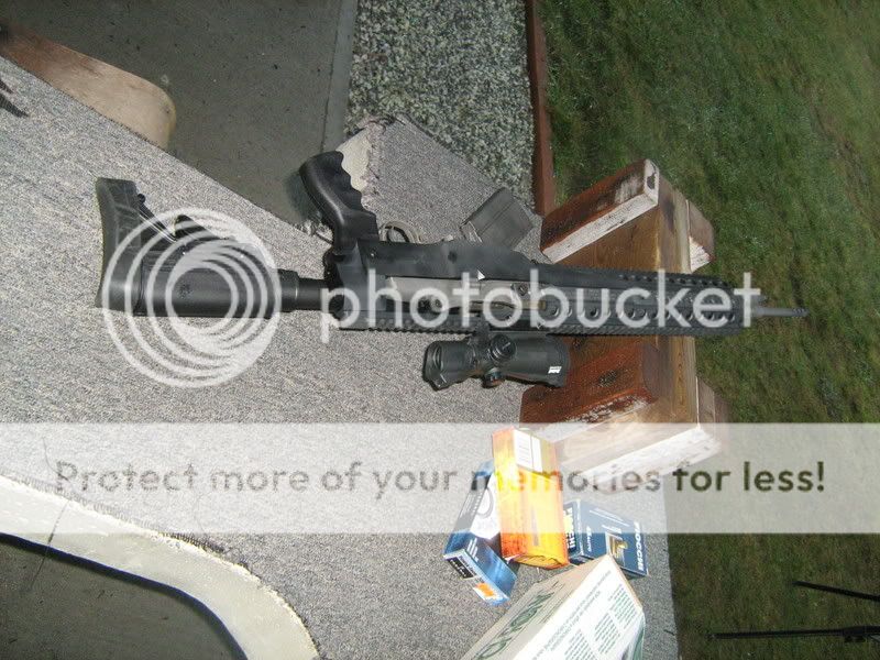

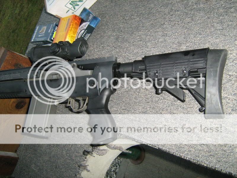

Yup thats the one. Troy chassies, some generic collapsible stock and pistol grip, Bushnell-something red dot. I cut barrel and ported it as you can see. Nice and short package. Velocity loss from factory 22" barrel in 19" barrel is about 130fps, 165-grainers were flying at 2700 fps average and 150-grainers @ ~2940fps. Red dot is just as bad as cheap chinese 30$ piece albeit with beter reticle. Nice rig altogether. Thanx for selling it to me, I think its win-win as you will fire this one for sure one of those days.

I could be wrong but that looks like a ported barrel not muzzle break.
I have something similar (called Magna port) on one of my rifle and its permanent you can remove it unless you chop the barrel far enough to discard that.

Barrel is ported, I did it from sheer boredom and to save a few bucks. Invested
- rifle 450$
+ chassies 902$
+stock 150$
+ pistol grip ~45$(can't remember)
+ red dot ~260$
= 1807$ total cost taxes and shipping included.
You may have noticed I shop carefully and it will be hard to match my numbers. Anyone willing to put together similar rig should factor in lot of time for shopping around or pay premium for each component.

porting works better than original norc's flash hider but proly not as good as aggressive muzzlebreaks. There is still a little bit of muzzle jump but recoil is mild, gentle push rather than chop. Weight of the rig helps too. I was shooting in twilight but didn't notice much of flash either, virtually none. Well, I might have been blinking and twitching but I doubt it. King, I take my hat off for all your effort you into tweaking them M14's. In my case things are slapped together, my vallet did most of the work.

how did you port the barrel without getting chrome flaking off from the bore lining??
Dlask does a very inexpensive 14 barrel chop and thread the muzzle to AR 15 specs, which allows for interchanging "MUZZLE BLING" at whim, but a permanent port on the original barrel is another neat way to go ... provided the chrome bore doesn't flake at the port holes,
OR,
provided you use a NON-chromed barrel, Like Thomas' Kreiger.
If you can do a port on the chromelined barrels without losing accuracy from flaky bore chrome, we would be mightily impressed.

The one thing I don't understand about the Troy stock is why they didn't follow the AR shape directly above the pistol grip. The way they did it half the grips out there look like crap.
