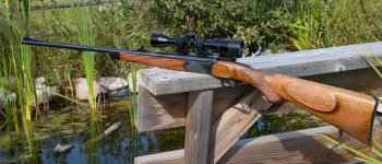

I literally just came in the door from my absolute last final ultimate sighting-in session with my Brno Effect in .308, which will be my primary deer rifle this year, only to find that lovely shot of the K5 above. :)
I picked the Brno up from a wonderful CGN member earlier this year, and was instantly in love. Took me several months to find the scope mounting solution I liked; I wanted to keep the slim, trim rifle as lightweight and handy as possible, and most of the Euro mounting solutions were big, bulky, overweight and overcomplicated.
I wanted the opposite. What I ended up with was a set of aluminum rings made by SportsMatch in England; they offer a wide variety of rings to fit various dovetail widths. The Effect has, if I recall correctly, a 15mm dovetail, similar to Tikka and some CZ centerfires. These rings come with a round recoil stop pin that fits the central, circular recess on the Tikka integral rail; this required some plier-pinching and filing to get it to fit the asymmetrical, angled groove on the Brno, but it was not a difficult task. They are solid; yes, they lack the QD functionality that most Euro mounts have, but the trade-off is bulk and weight. These rings weigh almost nothing; the rifle as shown, with the B&L Balvar 2-8x gloss-finished scope, weighs in at 6.8 pounds. It handles like a dream, and...just as importantly, to me...it makes for a very graceful, slender package.
It's not quite perfect, of course. Chambered in .308, which isn't my favourite hunting cartridge...although I have a bunch of rifles chambered the same way!...it loses a bit of the Euro mystique, and of course it really should be a rimmed cartridge. But I have the Haenel Jaeger 9 which I like nearly as much, and that one is in 7x65rimmed so the "rimmed itch" has been scratched. The Brno can be fed with ammo from any Canadian Tire or Peavey Mart, if need be.
The other minor negative is the butt plate. It's a beautiful piece of curved, case-coloured steel...but it's smooth enough, and angled enough, that my normal stance and grip conspire to make the gun want to slip downwards on my shoulder if I'm not careful. But that's okay; when I'm shooting a gun that I like as much as this one...I am careful! I might even cut a piece of that rubberized sheeting sold for better grippability on rifles stocks, to fit it onto the buttplate just for hunting days. But maybe not; I like to smile when I look at my hunting rifle during a long day, and rubber might harsh my mellow. :)

I literally just came in the door from my absolute last final ultimate sighting-in session with my Brno Effect in .308, which will be my primary deer rifle this year, only to find that lovely shot of the K1 above. :)
I picked the the Brno up from a wonderful CGN member earlier this year, and was instantly in love. Took me several months to find the scope mounting solution I liked; I wanted to keep the slim, trim rifle as lightweight and handy as possible, and most of the Euro mounting solutions were big, bulky, overweight and overcomplicated.
I wanted the opposite. What I ended up with was a set of aluminum rings made by SportMatch in England; they offer a wide variety of rings to fit various dovetail widths. The Effect has, if I recall correcty, a 15mm dovetail, similar to Tikka and some CZ centerfires. These rings come with a round recoil stop pin that fits the central, circular recess on the Tikka integral rail; this required some plier-pinching and filing to get it to fit the asymmetrical, angled groove on the Brno, but it was not a difficult task. They are solid; yes, they lack the QD functionality that most Euro mounts have, but the trade-off is bulk and weight. These rings weigh almost nothing; the rifle as shown, with the B&L Balvar 2-8x gloss-finished scope, weighs in at 6.8 pounds. It handles like a dream, and...just as importantly, to me...it makes for a very graceful, slender package.

Looks like a great setup, perfect for deer season!
