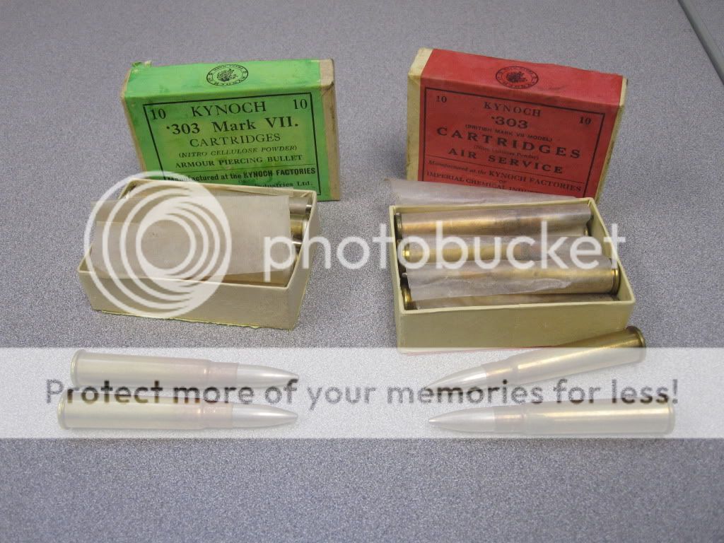

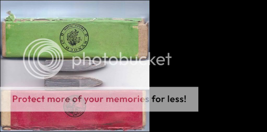

i bought 3 boxes of these today and never saw them before,what were they for? is this uncommon ammo? mfg date on the back?
[/IMG]
Could be higher quality rounds for aircraft machine guns. back in the '20s there would have been biplane fighters and fighter bombers in service that may still have had cowl mounted guns requiring syncronization.
I was prompted to suggest this by the packaging of Canadian .303 (the big wooden cases) that always said "Not to be used in synchronized guns after (date)".
This is just a W.A.G. (Wild Assed Guess) mind you.
Likely you are right, paulz.
Even the nonsynchronised guns on the Hurri II had fresh ammo issued for them; after the expiry date it was used for target practice or some other purpose.
Reason, of course, is that the old primers used to deteriorate, starting the day they were made. Back in the blackpowder cartridge days, mercury fulminate primers could go dead in as little as 2 years, depending on storage. The British primers for the .303 were mercuric AND corrosive (potssium chlorate) and so might not stand climate changes all that well, although the mixture WOULD fire under almost any circumstances..... although it might be more than a bit irregular.
But the 10-round boxes just don't add up. Can you imagine loading a Lewis drum out of 10-round boxes? How about a full-length belt for a synchronised Vickers? I think this is ammunition designed for civilian sale, fr people who are taking part in the military-style matches which were so popular. Aircraft-grade stuff had to be highest-quality, so they ran extas and put them in little boxes.
That's my take on it, anyway.
Likely John Sukey will be on shortly; he will know for sure.

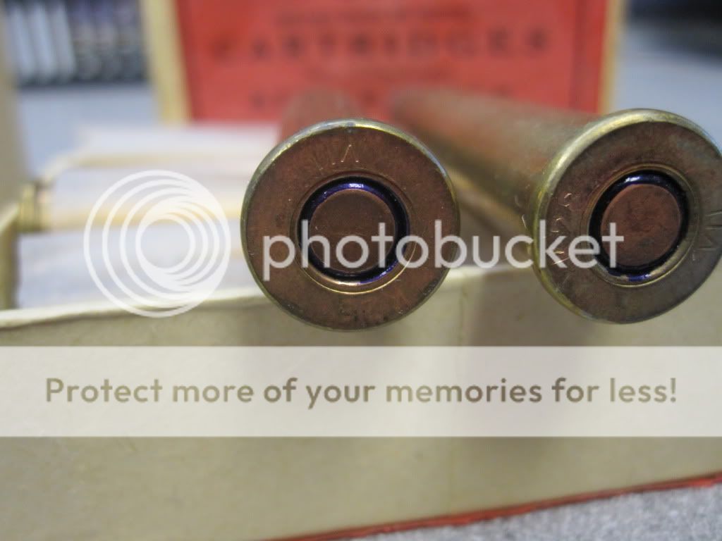

I always wondered if the Red ones were ALL tracers in the box. Perhaps they would mix them in with the other types of rounds in the belt or pan… making up whatever the “recipe” was for that day, or sortie. Headstamp is quite typical and unremarkable, K28 over VII. Cupro-nickel FMJ bullet. Primer lacquer is a purple colour.
The Green ones are a bit more interesting, the headstamp is K28 over VIIW. The bullets don't look any different. I wonder if the W stands for "Wolfram" which is an old term for Tungsten. Would make sense, right? Or is it just the Canadian Club speaking? Primer lacquer is definitely a green colour.
Never fired them so I have no idea if they fire at all, let alone if the Reds are tracers.

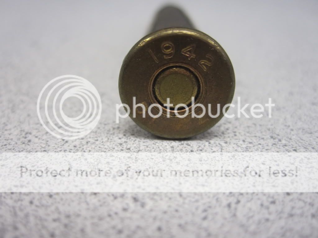

Here is another tracer, Canadian made but strange because there is no "Mark" designator...just the "Z" denoting nitrocellulose propellant.
Dominion Industries near Montreal I think... 1942 obviously... given to me by an old vet and he told me it was definately a tracer round.

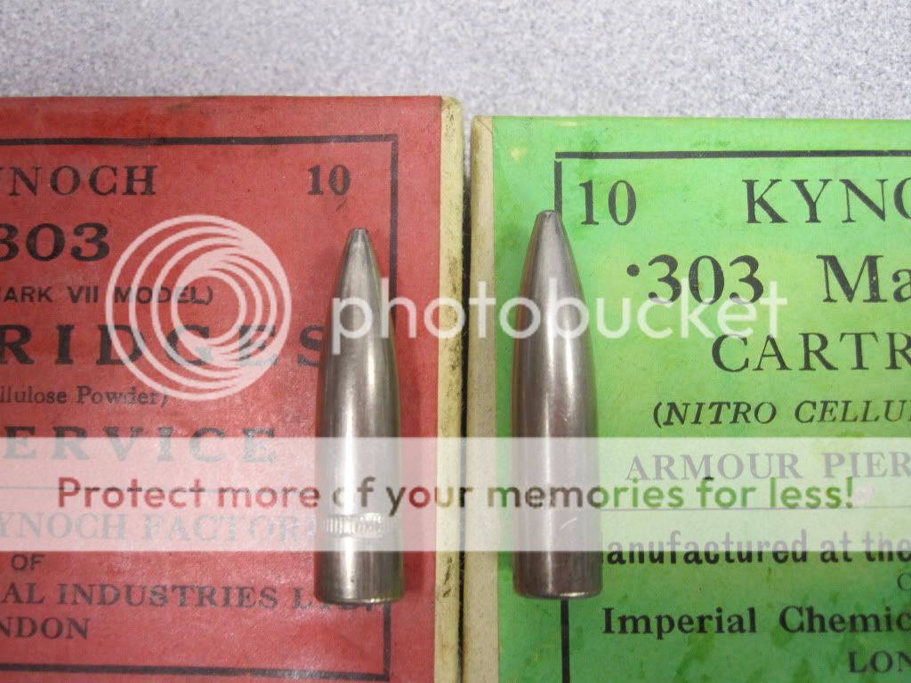

Well, there definitely is a difference in the bullets. Some quick measurements w/ calipers:
Air Service : D= 0.3115” OAL= 1.300”
Armour Piercing: D= 0.3109” OAL= 1.365”
Bases are different as well…

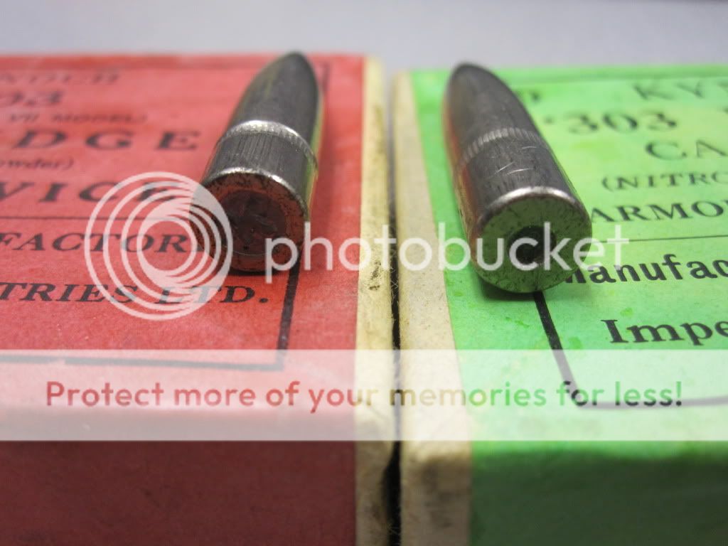

AS : Bullet jacket swaged over core, hole is about 0.200” D , core is quite soft, non-magnetic, easily scratched. I’ll say it’s lead for sure. Letter “K” stamped into base.
AP : Bullet jacket swaged over core, hole is about 0.125” D , core is very hard, magnetic, hard to scratch. I’ll guess steel. No letter stamped on the base.

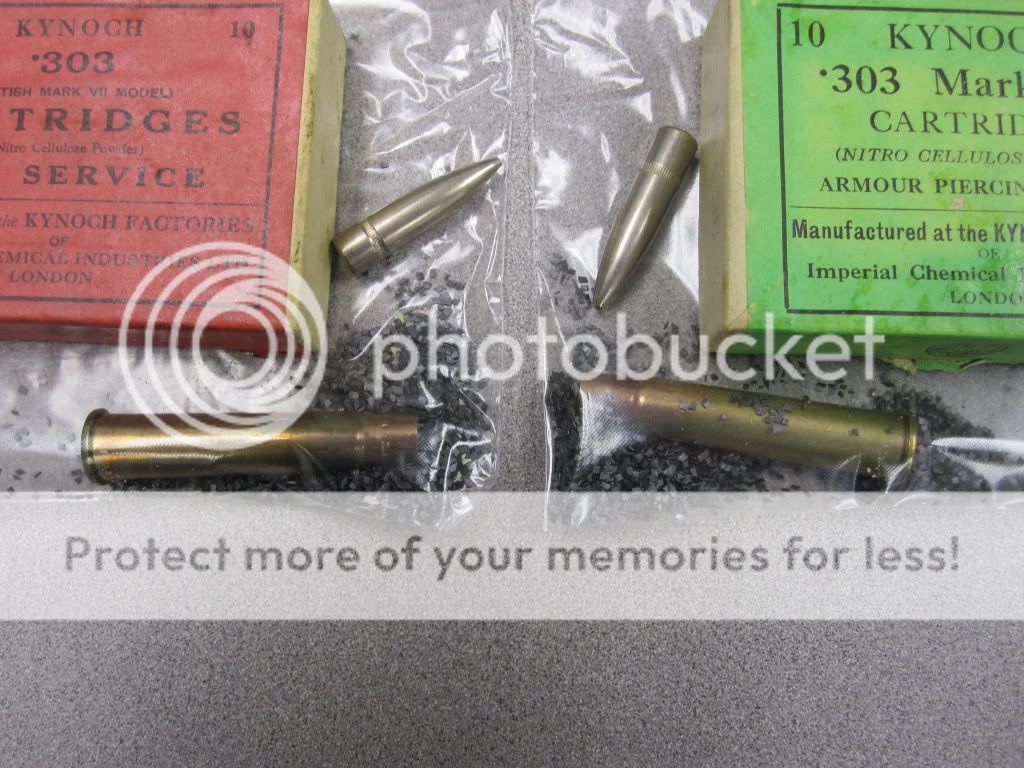

Looks like they really are loaded with nitrocellulose powder, as advertised…
Wish I had a reloaders scale to weigh the charges and the bullets with. If anybody in the Aylmer area want to weigh these for me, shoot me a PM.
I have to go back to work now, but I will try and section the bullets on a surface grinder, just for ####s&giggles!

So it also makes sense for these Kynoch rounds... AS is really just regular Ball in a fancy box! The AP has the green lacquer which checks out, although it's odd the tip should also be green.
Anyways, I ground down the bullets, and lo and behold... no surprises! :

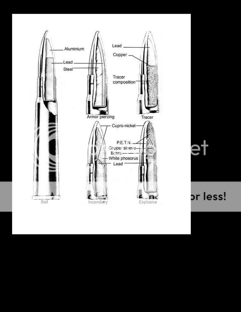

I looked on Wiki and they had a nice diagram showing me what to expect ... and there we have it :
So finally... after all these years... an answer!
