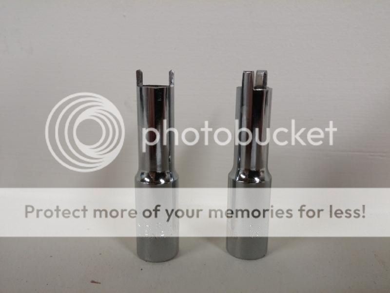

If needed, a tool for this can be made up using a small deep socket (small enough to go up inside the bolt body) and cutting out the notches to fit the firing pin spring collar.

Make the tool. Piece of steel brake pipe and a file is all that is needed. A Coleman naptha camp stove generator is also the perfect sized tubing.
Or a correctly sized deep socket and a grinding wheel.
Dimensions of the tool are to be found on the net. Literally a five minute job to make one when you know what you are doing.

I have a home made tool and often bust it trying to budge a seized striker.
I just file the end of the tool flush and recut the profile and go at it again.
Eventually the tool will be too short, but have used mine ten years already.
the first one I made I ended up sheerign off the fingers on a really tight fireing pin.
the second one I left the sidewalls thicker when I drilled out a grade 8 bolt so the fingers have a bit more meat on them and it works fine.
sticking the fireing pin in the vice.... not something I would ever do.
All I did was I went down to my local metal supermarkets and got a piece of metal tubing about the same od as the I.D of the bolt and with enough wall thickness to give the fingers enough meat but not too much as to interfere with the tip of the pin then I drilled a hole through one end of the tube to fit a bar or other small piece of metal then I took a dremel and roughed out the fingers, finished them with a file then hardened them and quenched it in oil then tempered at about 425f in the oven for an hr and they haven't sheared off yet.
