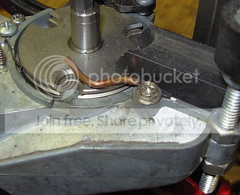

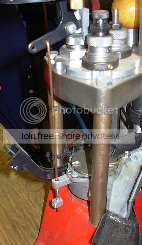

I did one better than a boot lace...
I have absolutely no powder issues now!
I also made my own ejection rod that kicks the rounds out a little more forcefully and a longer drop shoot to dump the rounds into a pan...

Can we get a clearer picture of the ejection rod you made?
Sure:
The end that is clamped down has been ground triangular to better stay in place and indexed in the mounting groove...
...Oh, I lined the chute in UHMD plastic tape to reduce friction and let the cartridges slide freely
