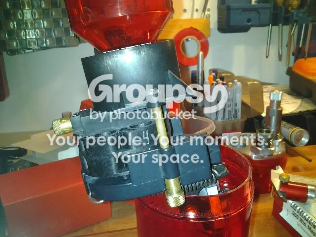

I forget where I got the idea from, maybe it was here, castboolits, thr, something like that. Yes, you add longer screws - sorry I forget the thread. You get some brass tubing from a hobby shop, CTC etc that just fits over the screws. Cut it so that it makes a snug spacer for the longer screws. I have 2 double disk kits and I got the micro adjuster unit. Here's what it looks like with the micro adjuster in place:
I also came across a handy dandy VMD Calculator spreadsheet with the VMDs for various powders and the appropriate combination of disk holes in the Double Disk setup is then calculated for the grains you want to load. I modified the spreadsheet to work with a third disk. I could make that spreadsheet available but I'd like to figure out where I got the original first so that I can give credit where credit is due.

How much ammo have you loaded with this modification? Any problems??
None so far. I've only tested it for functionality and it seems to be fine. I've only been loading precision rounds since I did the mod and for that I use my Hornady auto dispenser.
The threads that I found that discussed this had very positive reviews of this mod. I can let you know how it works some time after the hunting season when I have time to cast a bunch of bullets and load up some plinkers.
