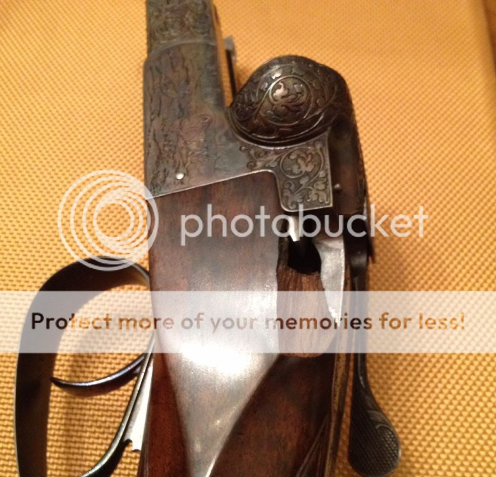

Here is a gun I had restored about 10 years ago, before I knew what I was doing.

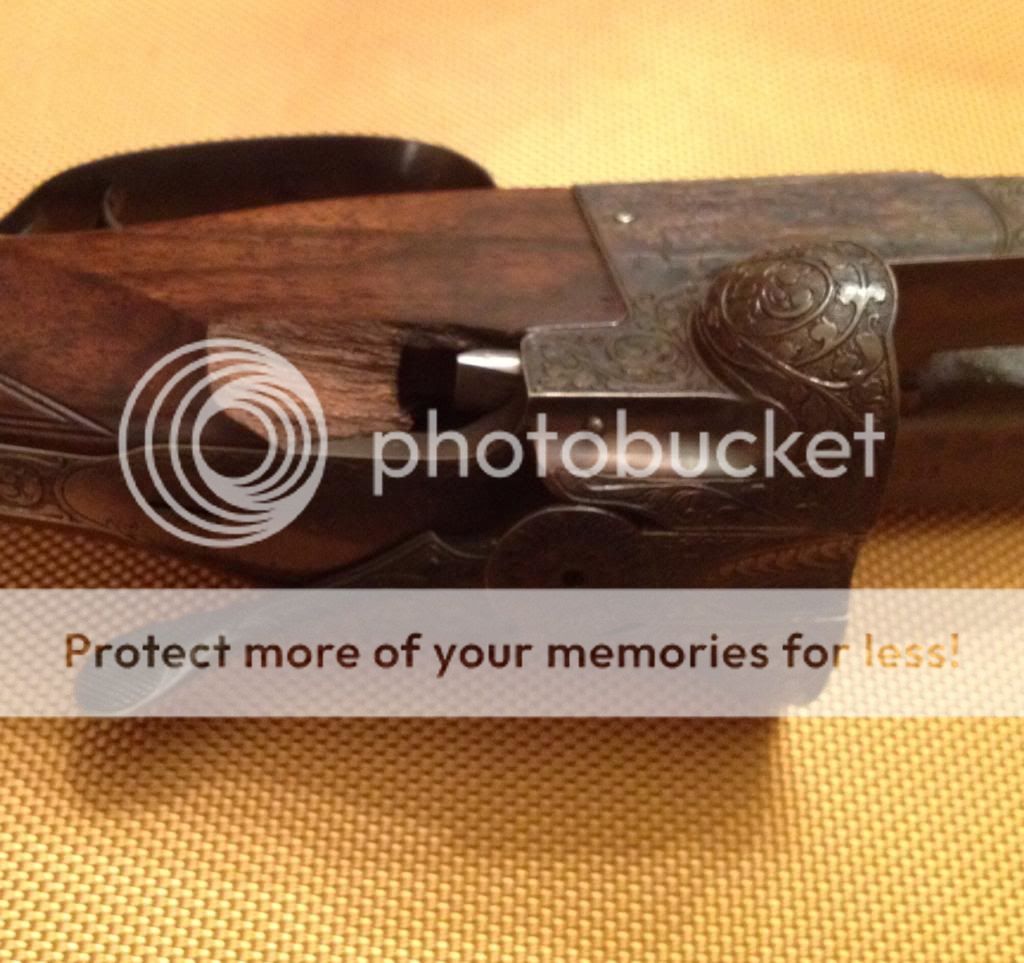

Here is some detail:
This gun will shortly be sent off for repair but had I had the stock glass bedded, it would likely not have cracked. I don't shoot heavy loads.....those were 1 oz that day, but the wood can't take it without a great wood to metal fit.

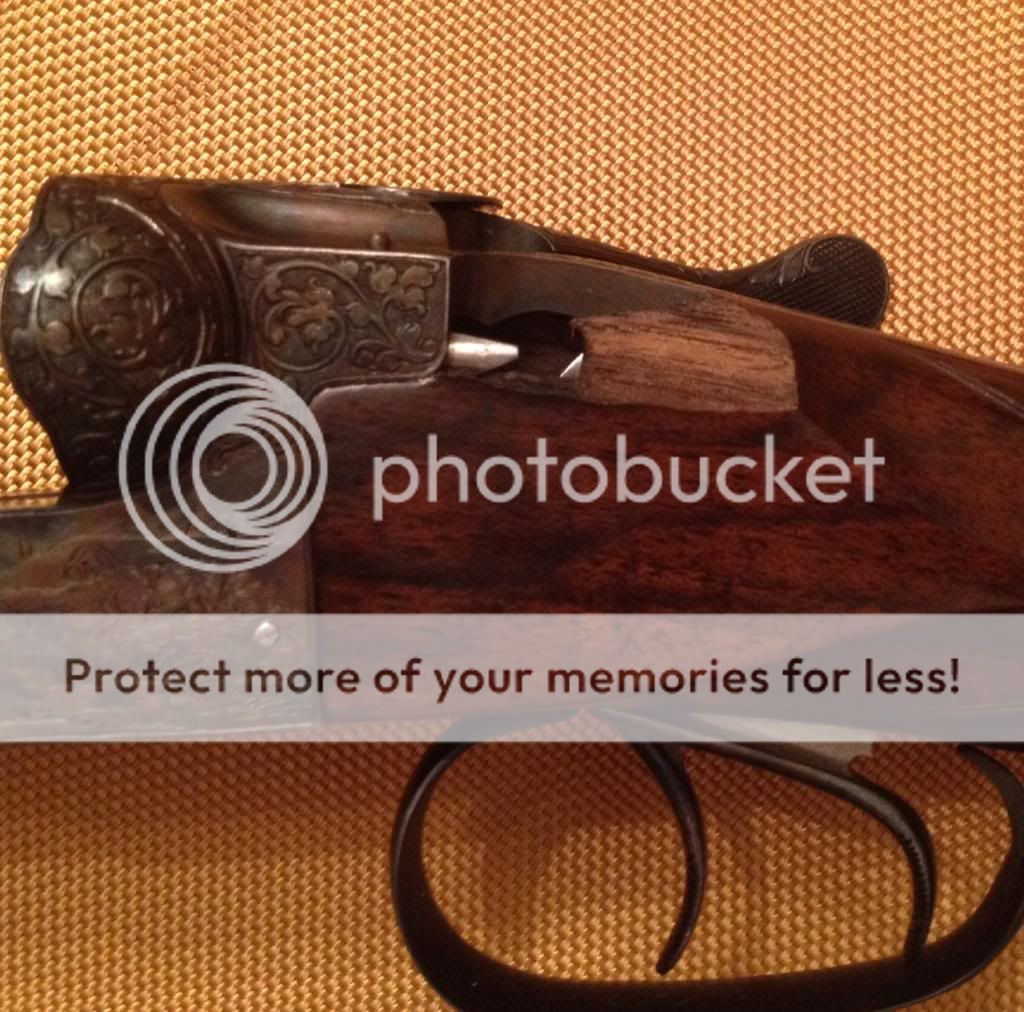

Glass bedding solves the problem.
