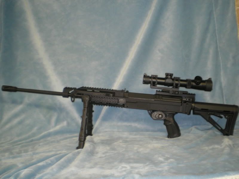

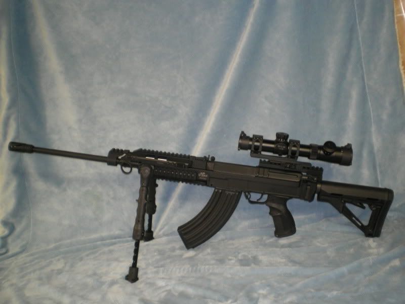

Here is mine, just needs a front riser then I can mount my Troy BUIS on the front railed barrel clamp and the NEA Scope mount.
Arma-Coat Matte Black
NEA Hybrid Break
NEA Barrel Clamp
Gun Epert's SA 58 Hand Guard and Rail
CAA Bipod
Tac Bolt Release
NEA Railed Stock Adapter
NEA Cant Scope Mount
Extended Mag Release
Magpul CTR Stock
Hi Lux CMR 1-4x24 scope
I really like the finish on that! :) What is the brand of hand guard and rail? I really like that.

Nice set up man....
Isnt a scope too far back...? how much for a handguard assembley, and is it polymer or metal..?
reminds me of my old set up.. :)

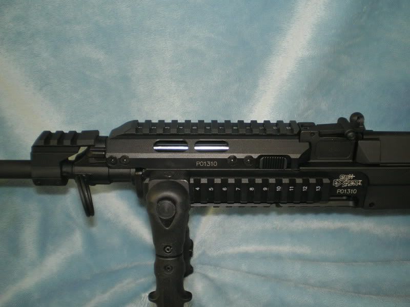

NA Sniper: you need to move your barrel clamp forward. Your rifle has one of the taller gas blocks and I'm sure you can see that it's bending the clamp when tightened down.

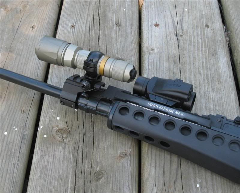

I was playing around with my barrel clamp tonight and found that it will make an excellent flashlight mount. All I need is a low Weaver ring and it's GTG. The 10 o'clock position puts the button of the flashlight right near my left thumb when I grip forward on the handguard.
Nice set up man....
Ya Arma-coat is great, love the stuff.
Hand Guard is from Gun Expert, it is all metal, fit and finish is very nice, very secure a easy to remove for cleaning. Will try out with a fast fire to see how the return to zero is...
It was not cheap, over five for it shipped.
But I really like the look compared to the other options available.
Ya scope is new and not zero'd yet, might have to get a shell deflector???
Is there a fix to this? or is there different versions of the barrel clamp?
I was going try and bend it back then have it milled out...
I can think of a couple but they both involve a Dremel, an angle grinder, or both.:)
But seriously, many of these rifle have different dimensions on external surfaces of parts like the gas block or rear sight base. I had to grind down the rear top of my gas block tonight in order to fit a NEA upper rail. It had a "kick up" at the back and it acted like a fulcrum to keep the rail from seating down far enough at the rear. I've seen a couple like that in the dozen VZ's I've handled.
NEA only makes the one version of the barrel clamp, AFAIK. IMO, you've got 4 options:
1) Move the clamp forward. It doesn't look as good there, though.
2) Cut the rear segment of the clamp off and slide it rearward, snug to the gas block. This option depends on if that leaves you enough rail to mount whatever you want to on it.
3) Relieve the underside of the clamp.
4) Remove material from the top of the gas block.
My choice would be option 2, YMMV.

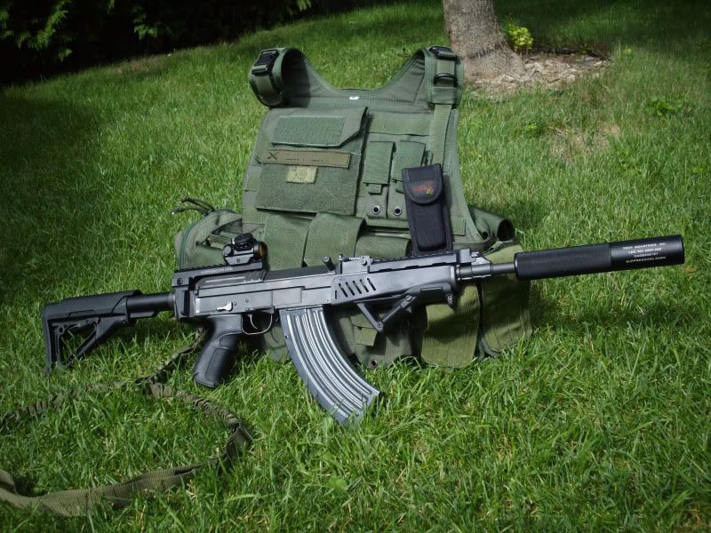

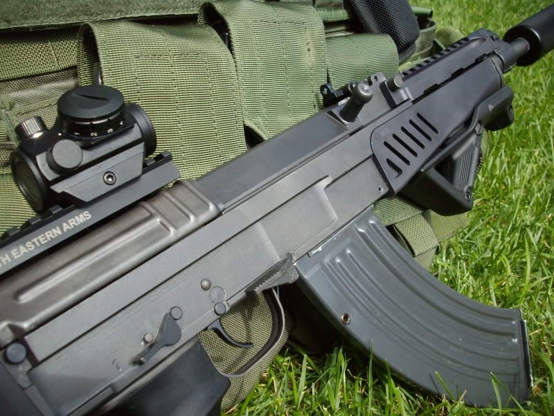

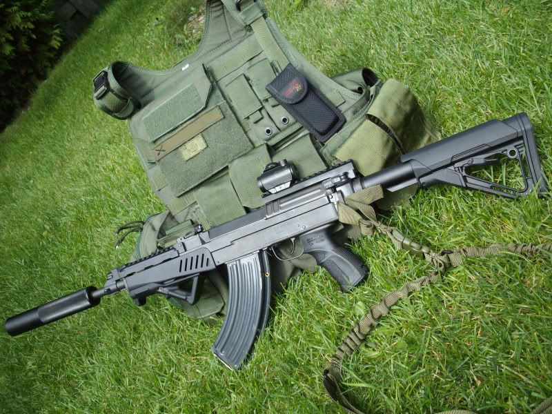

Here's mine:
- un-restrict. CZ858 (19" barrel) from Canada Ammo
- Nitro-carbon dioxide coating from Rauch Tactical
- Fake suppressor, dual-threaded model, from 007airsoft.com, held by a CNCwarrrior jam nut and some epoxy glue (loctite was not strong enough)
- NEA handguard set, gen.2
- Magpul AFG angled foregrip
- Rauch Tact. rear peep sight
- Neit Arms bolt release, gen.2
- Fab Defense grip
- NEA AR stock railed adapter
- NEA cantilever mount
- Bushnell TRS-25 red-dot
- Magpul CTR stock with cheek riser
- Condor single point sling (SB2)
BTW, i also have the NEA barrel clamp, but it was serving no purpose with the red-dot on the cantilever mount. Plus I think it looks better without. However, i really like Stevo's idea of putting the clamp sideways, to act as a flashlight mount. Will have to try that.
