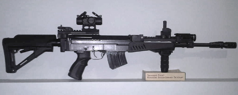

my 858 & kimber

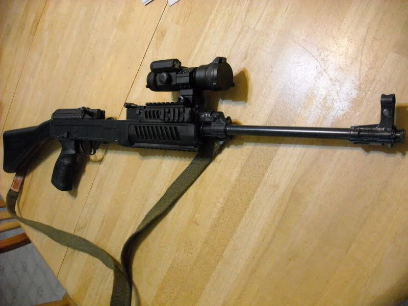

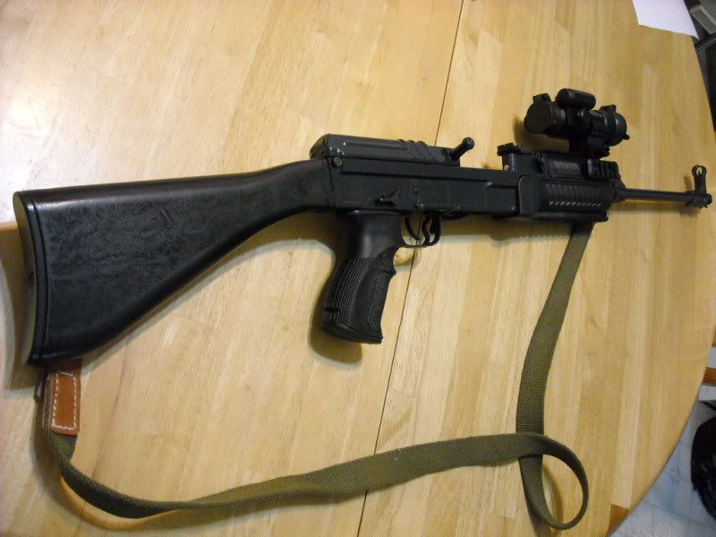

Here's my restricted gal! Sorry for the camera phone pic for now, but better ones and build details to come! I love this rifle!
Nice setup Mambo, what after market pop up sights did you use? Did you have to use a riser on your front NEA rail for the front sight? I figured I would need about a 1 inch rise to match the height of the rear cantileaver mount to even the sight picture between front and rear sight.
Thanks Striker! I've got the Yankee Hill QDS BUIS set and totally dig them. Super low profile (when folded) and lockup real nice. I got the HK style front. Yes you're right, the front sight is on a riser. I wanted everything 100% level to start and after measuring and seeing the NEA cantilever mount was over an inch tall I just decided to grab a second one and chopped the arm off to use it as a QD riser. Nice and easy. It hurt to butcher such a fine piece but it worked out beautifully for my setup. MY Vortex SPARC sits on a LaRue medium Micro TI mount (LT660HK) and I have a perfect absolute co-witness with my BUIS. I love having everything QD! Tearing down is a breeze and always gets the oohs and aahs from my buddies, haha.
I was having an excellent day at the range yesterday sighting in my BUIS and was just about to move on to my SPARC when I got a damn stuck shell casing in the bore for the first time! Boo! And I keep her crazy clean. Cut my fun short, big time. :mad: She's now at the smith getting an enema. :D
Well your efforts produced a mean looking machine, the fact you butchered a NEA cantilever mount :eek: can be our little secret lol. ;) It would be great to have a NEA riser which would balance out the height with the cantilever mount, likely be on their drawing board in the future. I know there are lots of risers you can order but I would prefer the NEA quality .................... without the chop shop option. I am also going to add secondary iron sights and will check out the Yankee Hill QDS BUIS. I did find a laser that had a one inch rise with a Picatinny rail, would have to mount it upside down to get the rail on top. Then you could mount a front sight on top of the laser which would line up at same height as the cantilever mount. Not sure I have much use for a laser but it would act as a 3rd sighting option and give the desired height.
