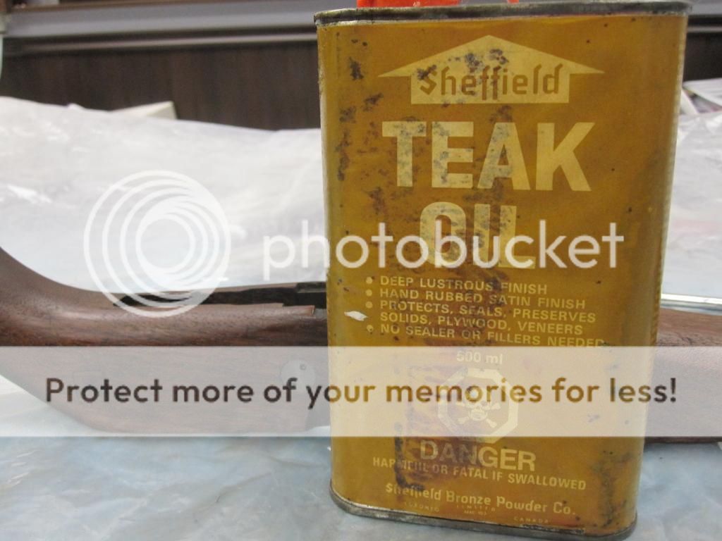

Now ( ...and not to hijack the thread by any means) I wish he might have also included the so-called "Teak Oil" which I have been using for maybe 30 years now on all my natural wood stocks ( except commercial sporters with a lacquer or urethane finish on them).
The last can I bought was from "Canadienne Pneu" donkeys years ago, but it was made in Toronto by a firm that still exists in the US, apparently.

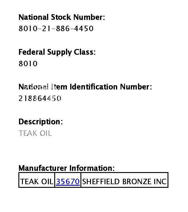

Now this stuff does dry ( eventually) like BLO, and seems to have it's own NATO Stock Number, but for what purpose? Weapons? Equipment? Who knows?
My cousin uses it on his teak yacht wood, but he told me it's not really "teak oil" but a weirdo chemical concoction and has no real teak oil in it at all.
Anyways, just my 2 cents on the subject, and was also wondering if anyone else out there uses this stuff... it doesn't seem to hurt the wood any, but doesn't seen to be heard of or mentioned at all amongst the firearm crowd.
