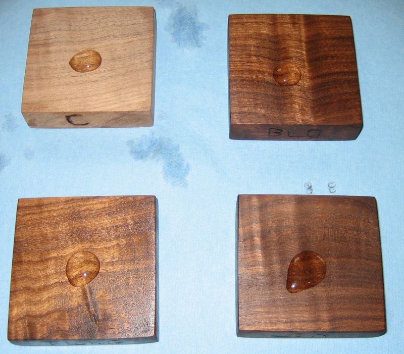

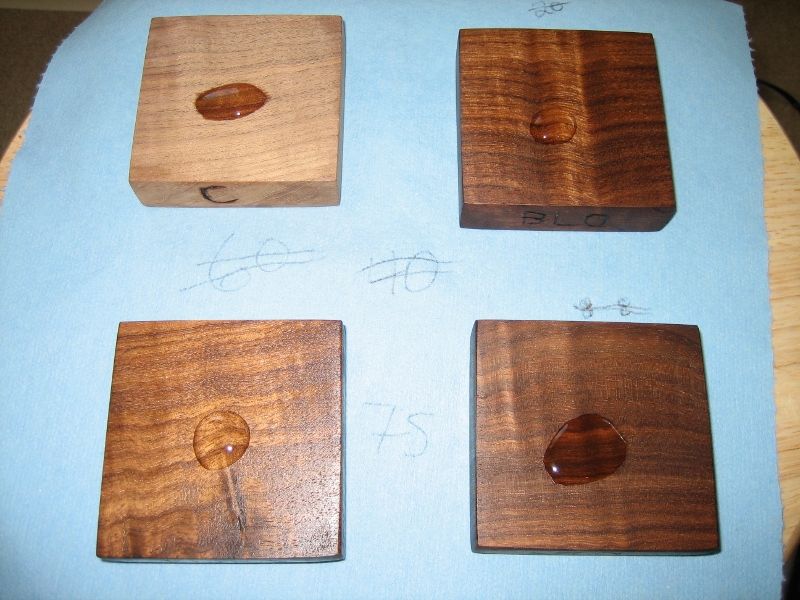

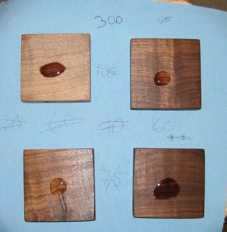

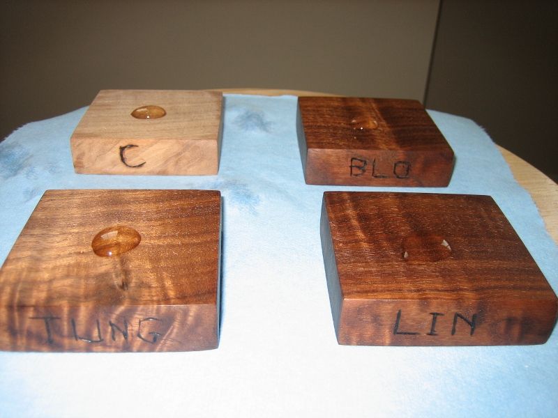

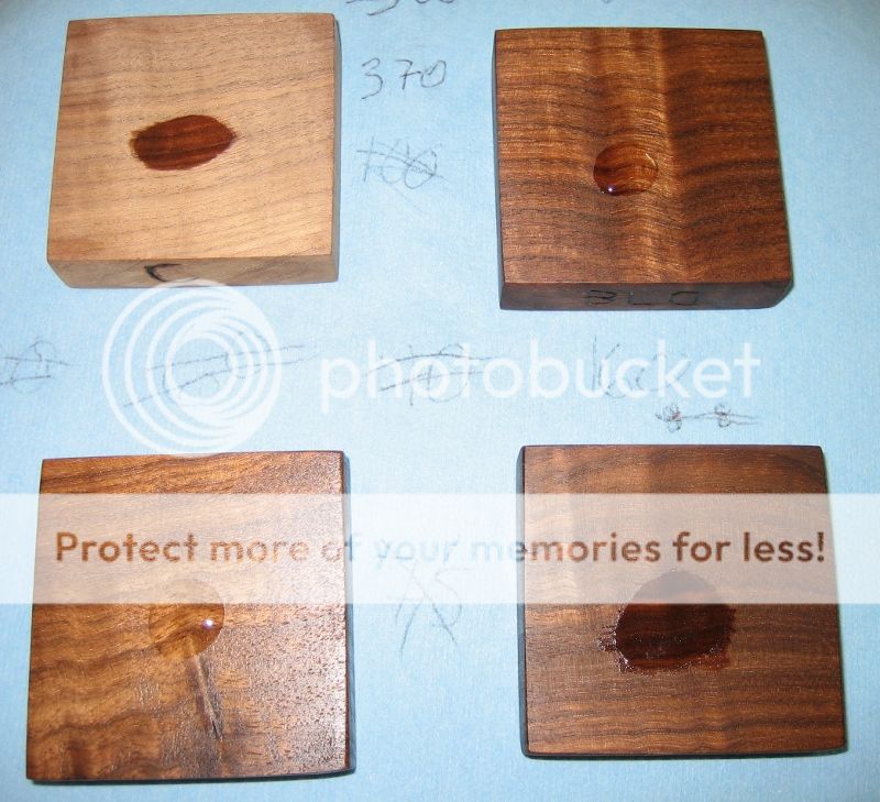

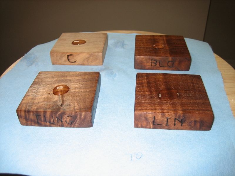

The Test:
0.5 ml of water on top of the block, measured by medicine dropper. Timed and observations made about bead size, soak-in, and water marks left behind.
Time Zero:
Time +10:00
And this is 6 hrs + 10 mins: Note the linseed block water bead has failed.
