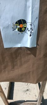

Rossi 38/357 with a 2moa red dot 50 yards with a rest
3 different loads on same target / adjusting the red dot
38 special .361 dia powder coated wc PlusP load on the left side single fed top load

the above target was shot with a solid Base cast bullet at over 1000fps if i rembercorectly left group has 20 rounds in it / 50 yards
