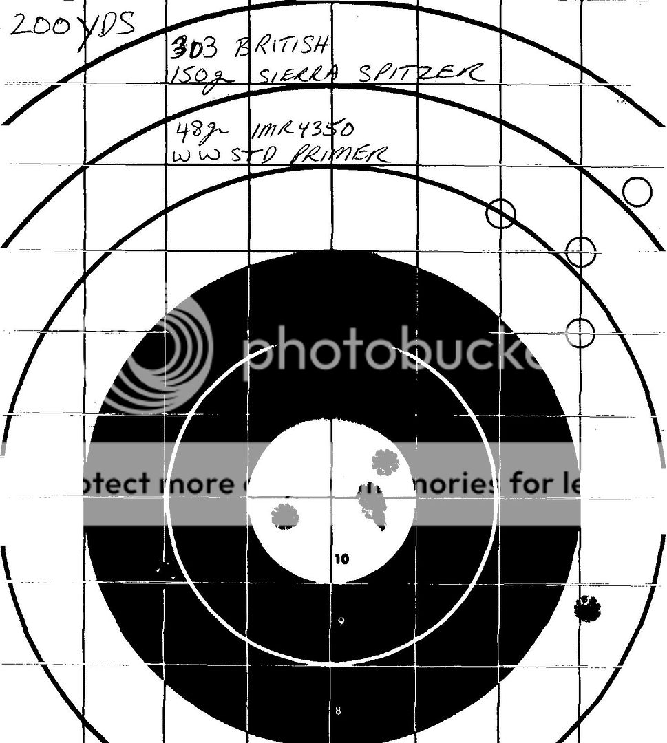

46gr of H4895 and the 150gr TSX is giving me 2 shots close together, then one shot out about 1.5".
I can live with that for now....I rarely shoot more than once or twice at an animal anyway, and 1.5MOA is fine for a hunting rifle. However, like any gun nut, I want to see what I else the rifle can do.
I wasn't able to figure out how to get the scans any bigger so I will PM you my mailing address, thanks
It's not necessarilly a bedding issue, lots of #1's exhibit this 2 together and the rest a bit farther out type of grouping.
It was explained the quarter rib scope rail is to blame. As the barrel warms the rail will distort a bit and start moving things around.
Try 2 shots and let it cool completely, the try 2 more, coll it down then 2 more, if you get a nice tight 6 shot group, go hunt it.

1. Loading with IMR 4350 (as stated previous in the thread), I am seeing charges from 45.5 to 50 grains. I would like to load some 174 / 180 grain bullets in it, is 45 grains safe to start with my rifle?
2. Does anyone have any IMR 4350 data for a 150 grain bullet?
The hard copy will be in the mail tomorrow morning. In the meantime, remove the forend. Just for the hell of it, try shooting with the forend off resting/supporting the barrel the same for each shot.
Update:
It was too cool and frosty to go for my bike ride this morning, the package is on the way.
Why I mentioned removing the forend, that's how I 'accidently' found where the reason for inaccuracy in my No. 1 in 375 H&H was originating. IF this is where your accuracy problem is coming from, you should notice a definate improvement with the forend removed. If not, look for another cause, possibly an ammo and/or component related 'problem'.
