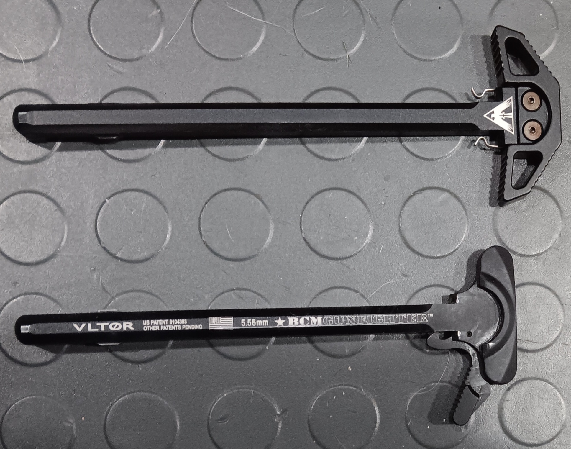

Are after market top/rear charging handles available?
