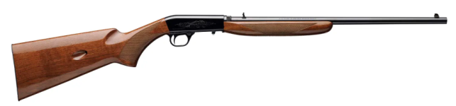

Like this ? What info are you after ? Did you Search this forum ? Did you try RFC ? 'Self-Help' is appreciated rather than looking for 'someone else' to do it.
Thank you for your answer. Yep, I did, as well spending some hours on other forums. Since those rifles just show up once or twice a year to buy here in Switzerland, local info is rare, and since I cannot upload pictures as a file it makes it no easier.
In general, the rifle looks like the picture you posted, just without checkering, no roll engraving and the rear sight with the "half fir tree" elevation adjuster. So it must be earliest from the 60ies, has a custom stock or is a Mirokou model which is falsly stated as FN. Anyway, since in Europe, it is rather a FN or Mirokou than a "Browning" or "Remington".
